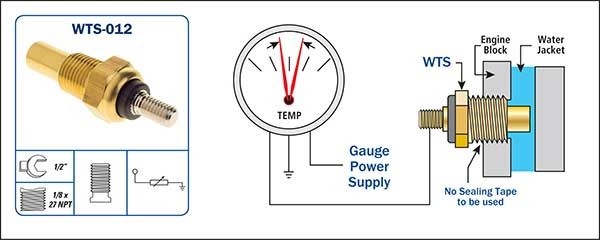

My old Fords and old tractors only use a one wire sensor for oil pressure and coolant. Can one wire work in some instances?
Yes! An analog value can be communicated to a gauge using a single wire; the sender unit's case is often the ground connection, grounded by screwing the sender into a manifold, engine block, etc. This can be seen in the image below:

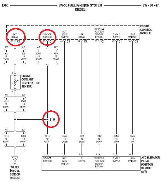

But on more modern vehicles, most analog sensors seem to use 2 wires. One being the analog signal being monitored having a voltage applied and the other wire being a dedicated ground wire. As seen below:
In the circuit above splice S157 ties the sensor grounds from the APPS, ECM, Engine Coolant Temperature Sensor and the Water In Fuel Sensor together. The reason these modern vehicles use two-wire sensors is that the dedicated ground wires provide a more reliable connection, thus a more accurate signal that will usually have less noise. They don't have to worry about corrosion, dirt or sealing tape at the mechanical connection. But, as you can see, the electrical circuits in two-wire sensors and one-wire sensors are identical. The only difference is how the sensor is grounded.
