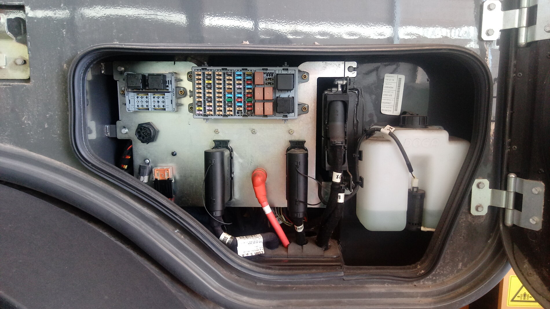

I am afraid my loader is as bad or worse than my Ram. 65 fuses and 11 relays, everything seems to be electric controlled, very little manual control.
