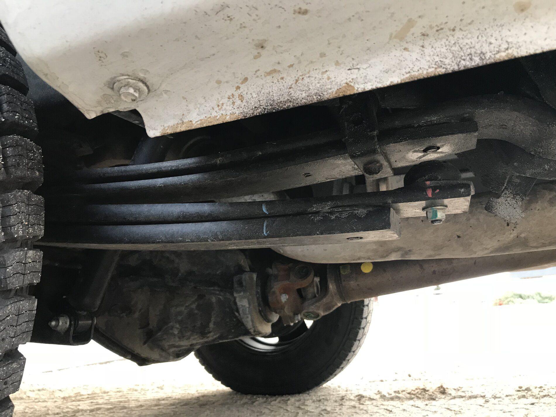

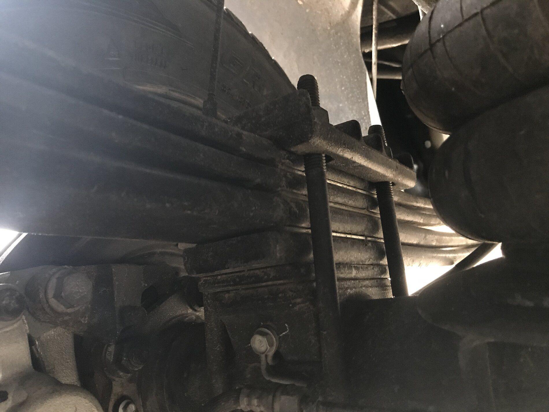

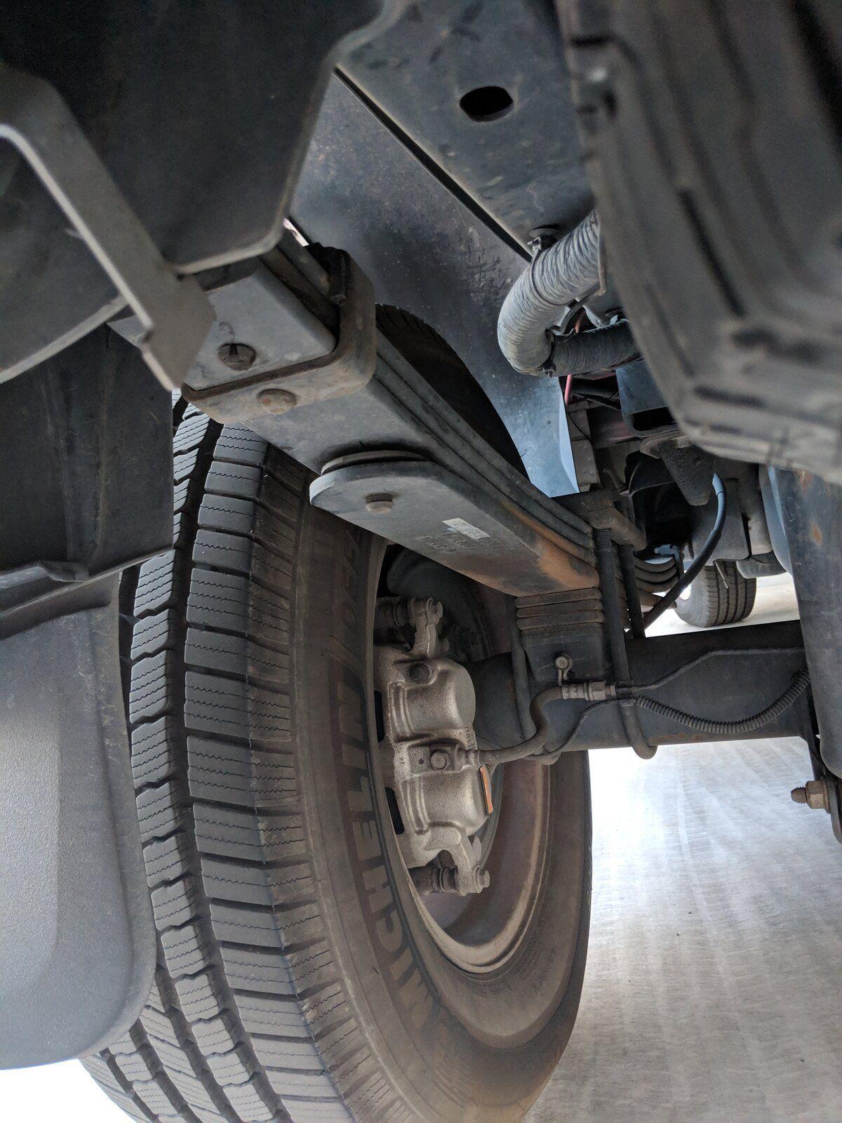

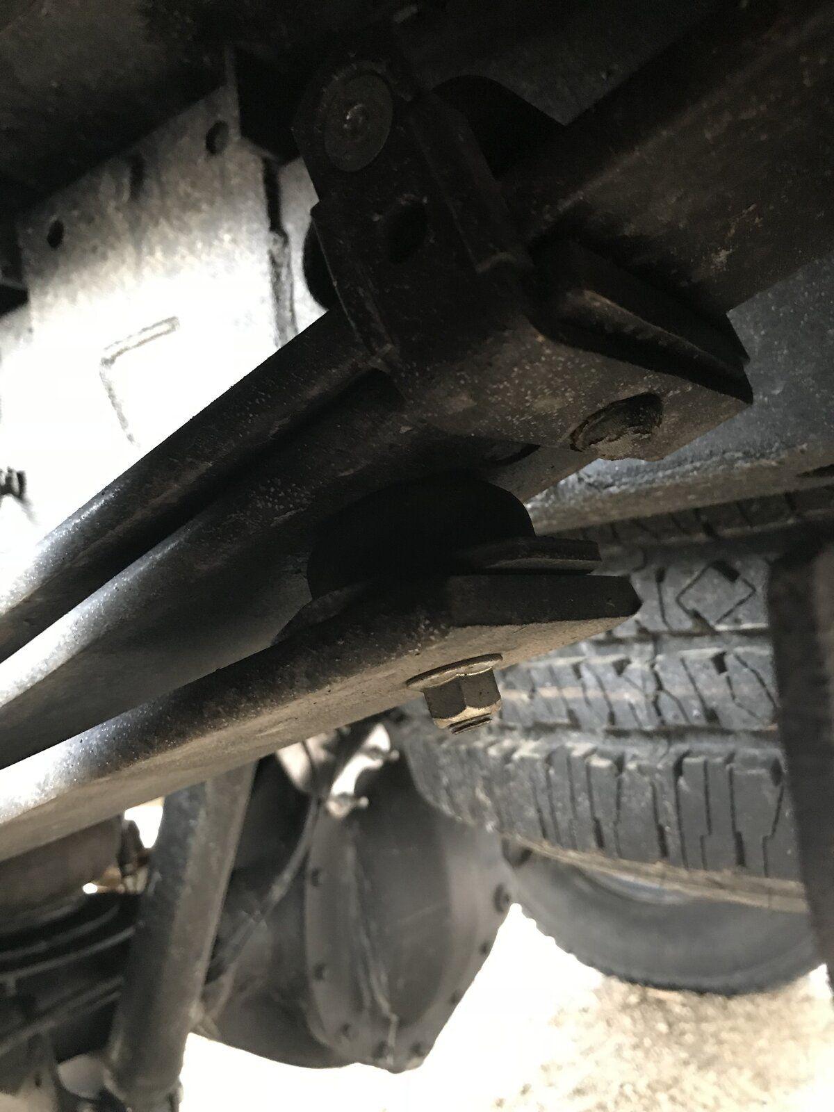

There are two options.
The standard 3500 suspension is the same basic spring pack that has been on 3500 DRW’s since 03, and SRW’s since 10. It’s a 3/1 setup. The spring rates might have changed over the years, but they look the same.
Then there is the auto-level which is 2 thinish leaves with thick overloads that have contact bumpers. The 15’s have two 1/2 leaves in the front to help with axle wrap. The 17+ (not sure when it started for sure) one full length overload and one 1/2 leaf on the front.
These are the auto-level springs.
