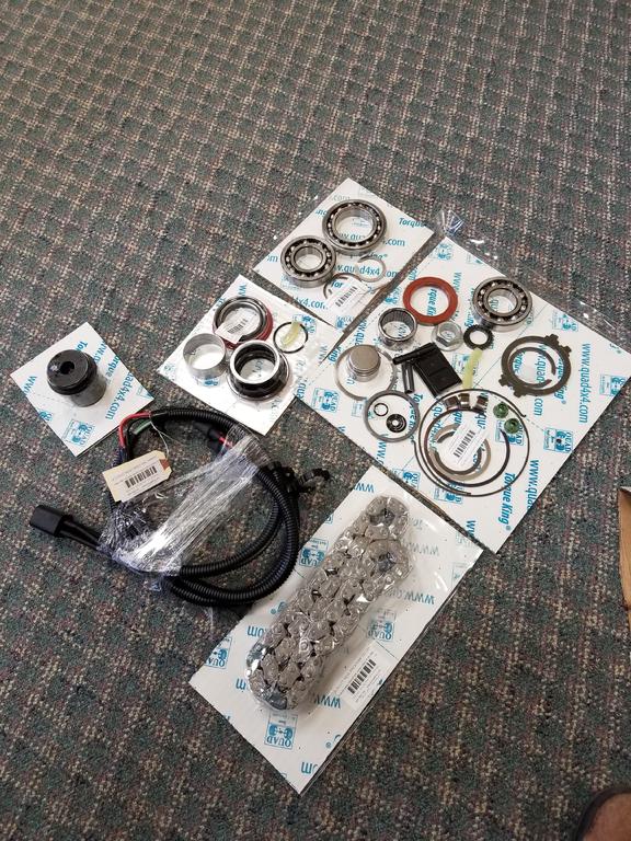

This is another Auto to NV4500 swap question.
By my xfer case build tag I need the narrow bearing 29 spline input.
The Torque King site says there are 4 possible inputs - two wide and two narrow - which accounts for stuff like minor ( I suppose) differences in gear tooth beveling and so forth.
Now the Torque King gears are around 200 bucks.
All other sources - having only one wide bearing or one narrow bearing part number - are about 1/4 that amount of $.
Your thoughts would be appreciated.
