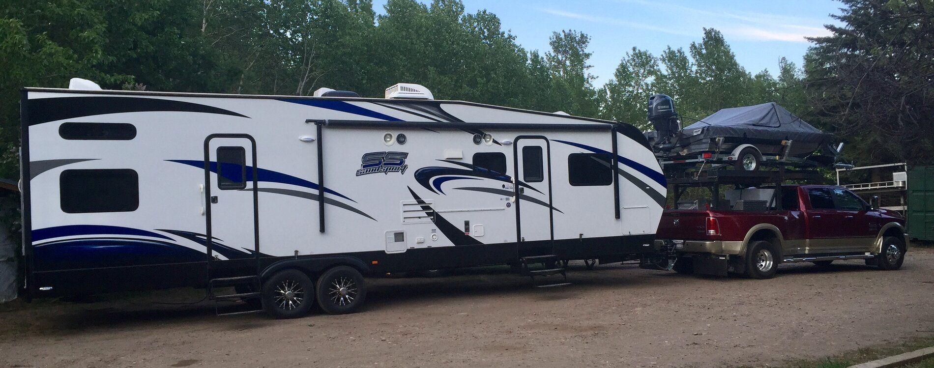

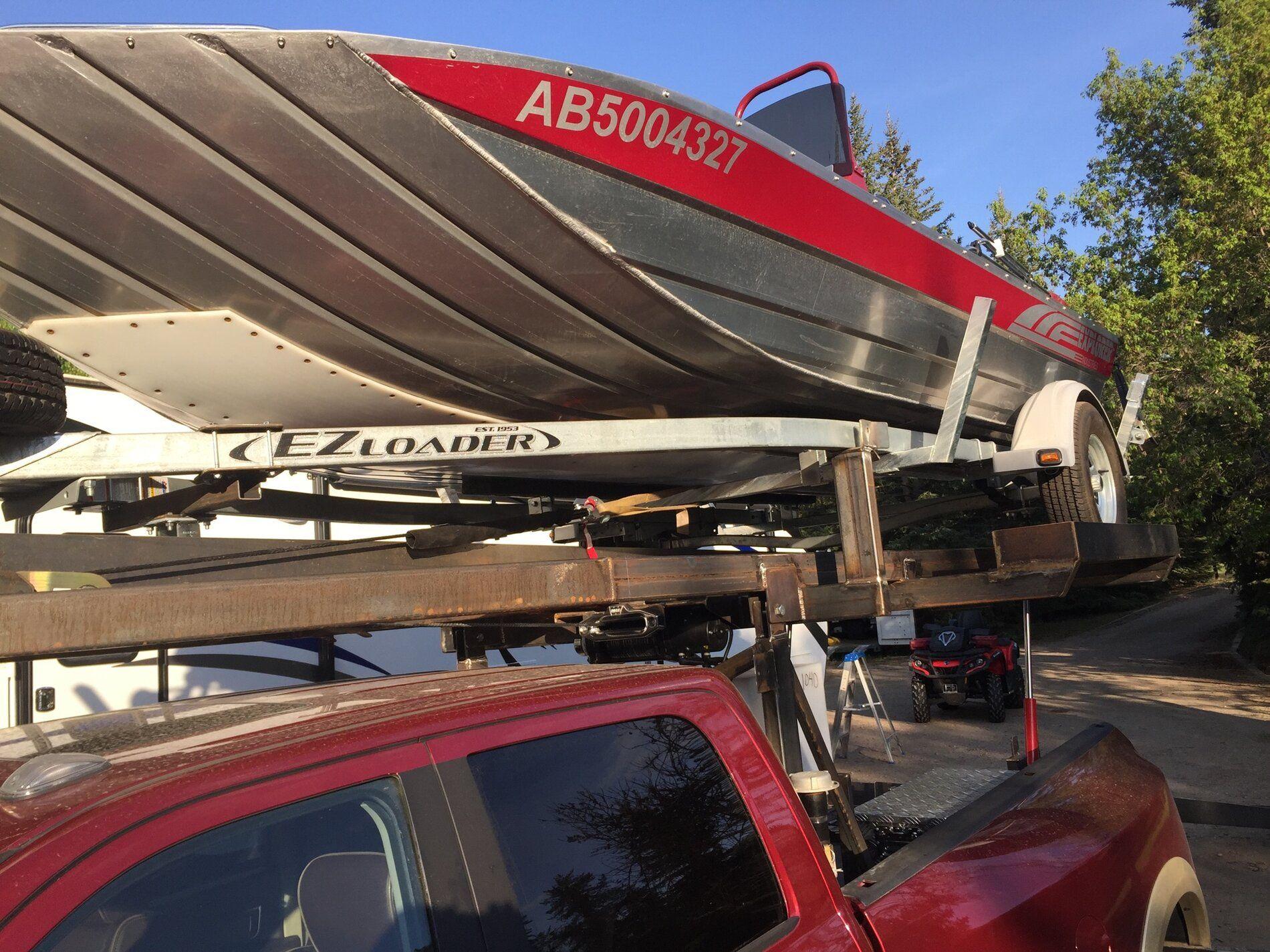

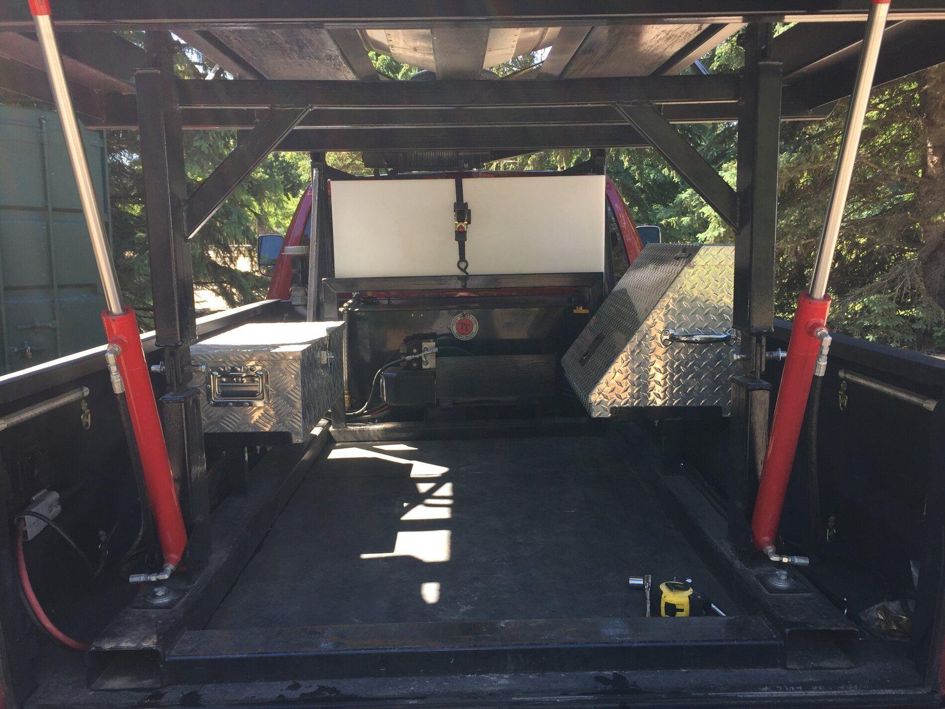

View attachment 111395 View attachment 111394

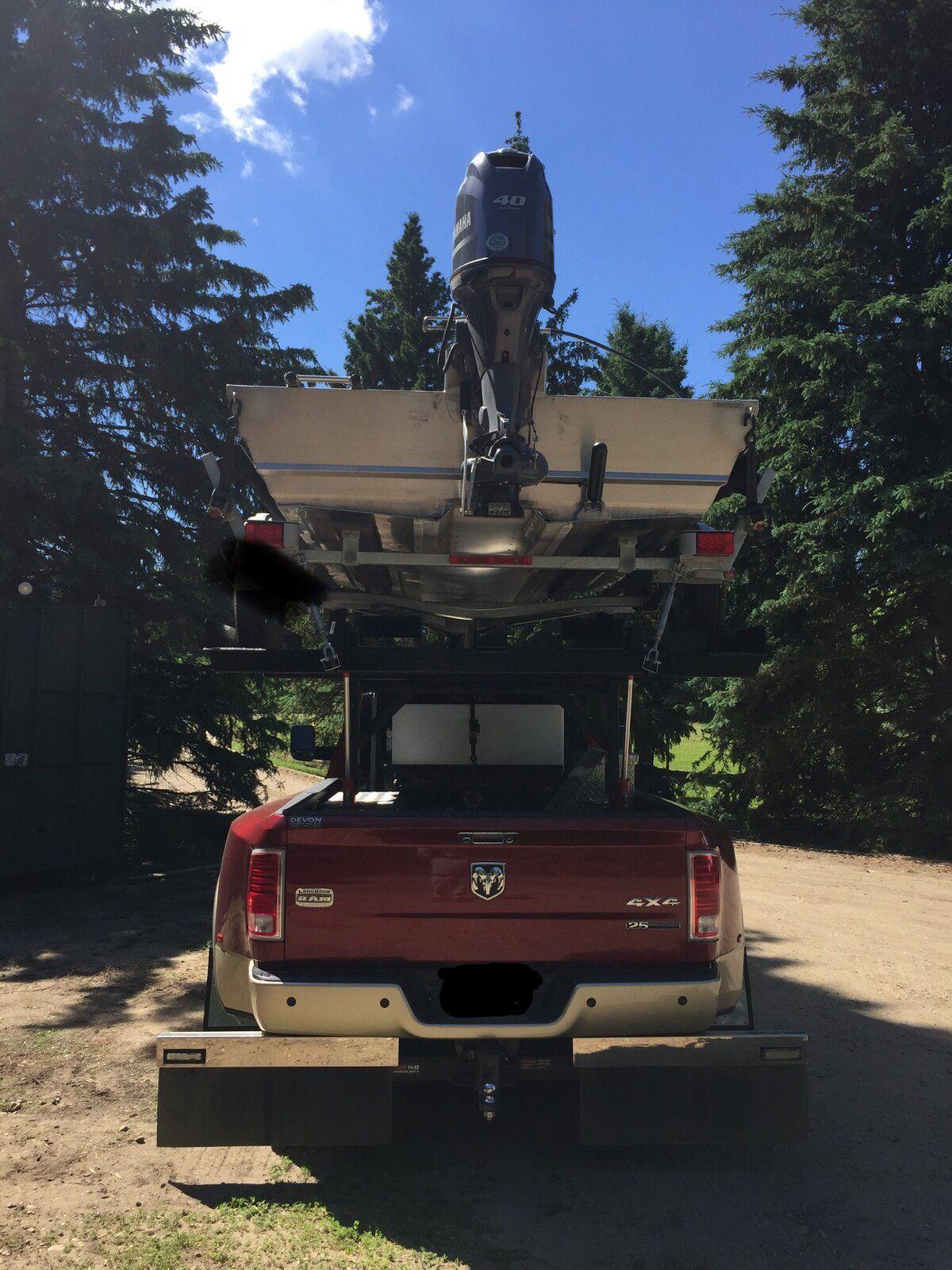

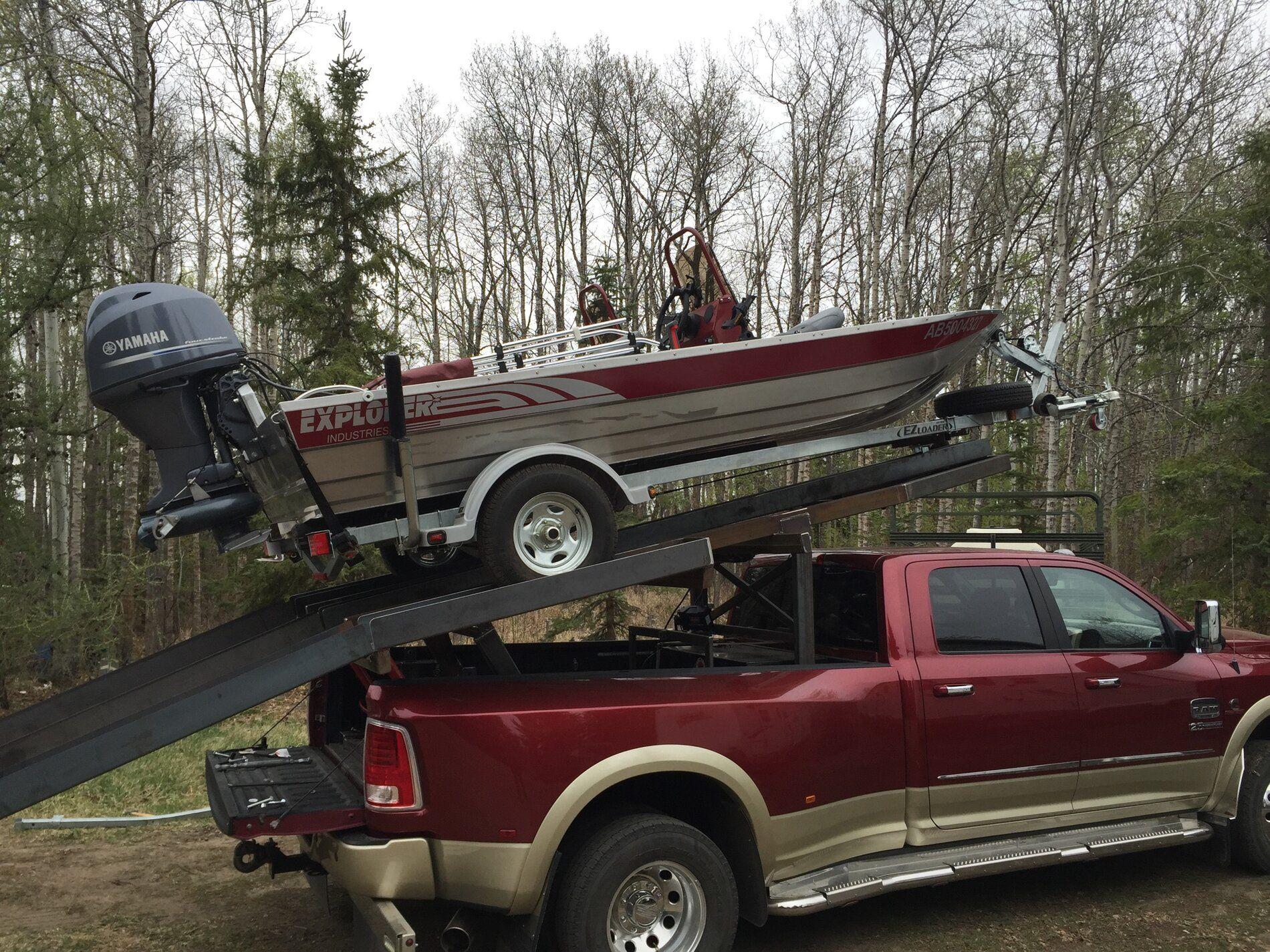

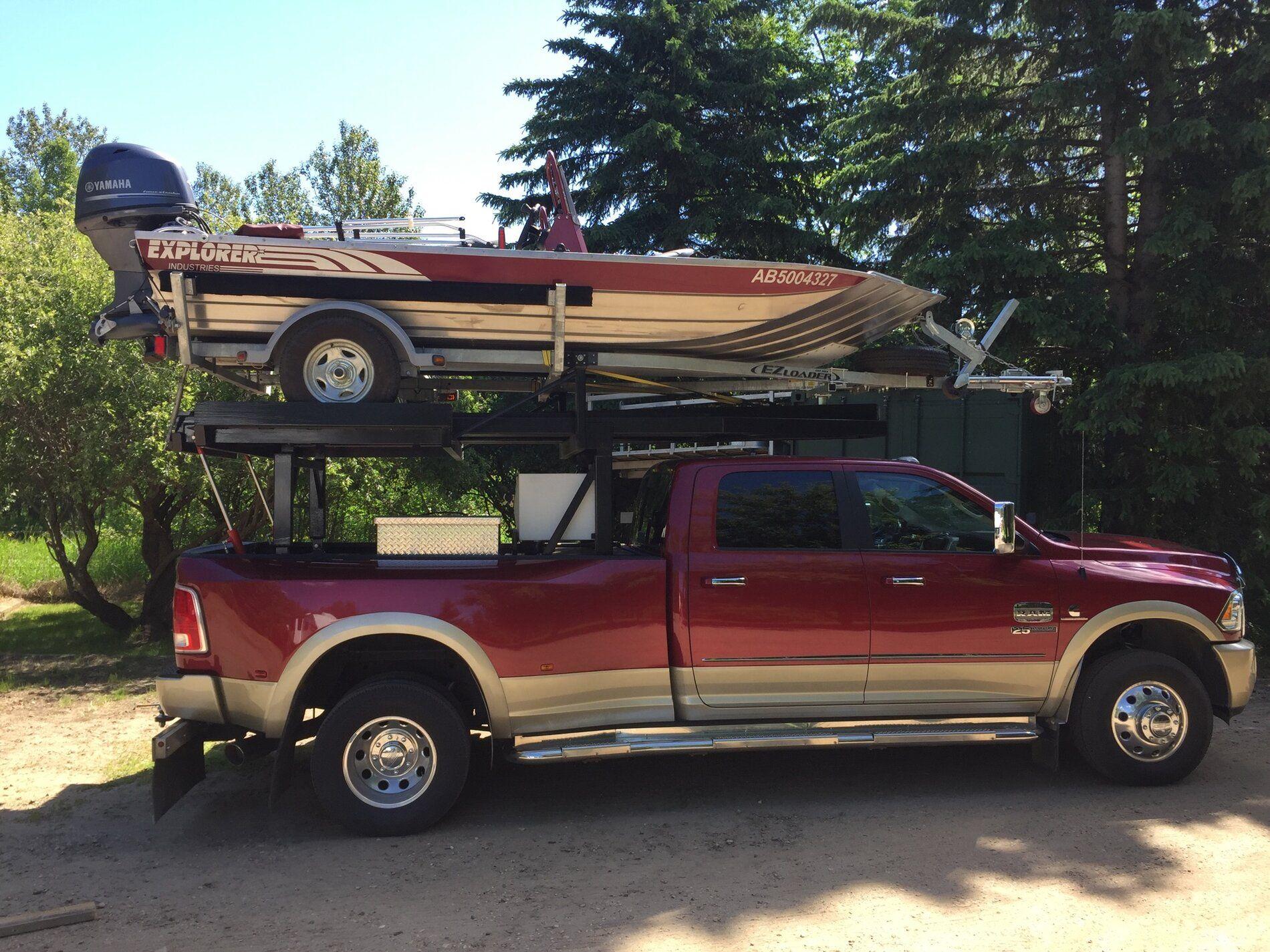

Can you post a video of how you get it up there?

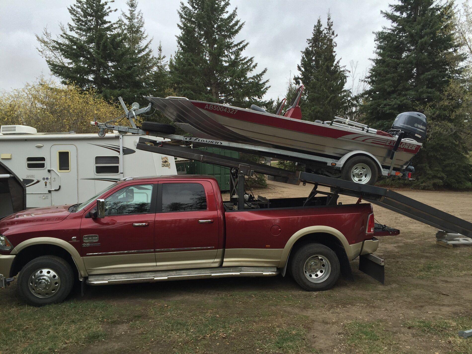

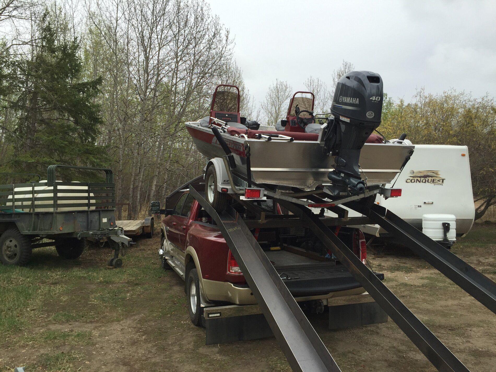

I don’t have a video, but I have pictures from when I was doing preliminary clearance test. It hydraulically lowers at the rear once the rear support arm is swung up out of the way, ramps are slid out from under the boat trailer and it is rolled on/off with an 8000lb winch with a wireless remote. The process takes about 20 minutes. The ramps were modified after these photos to have another flip out section that makes them 12’ long overall. Two big turnbuckles and two bolts and I’m down the road.
View attachment 111426 View attachment 111425View attachment 111424View attachment 111423View attachment 111422View attachment 111421
Winch?
The winch pulls it up the ramps and backs it down the ramps. It’s mounted just behind the cab brake light, goes forward to a snatch block at the very front of the frame above the hood, then back to two slings that are each attached to the frame just ahead of the trailer axle.
