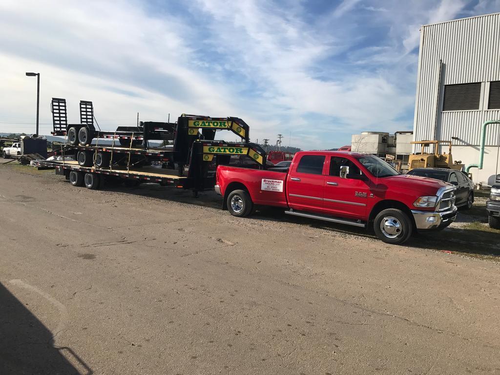

Update!! I got an education on how my 4:10 rear works..in the gear assy that the ring gear bolts to, you have gears and clutch's that control 4x4 lockup, traction control and speed difference when going around corners..the tech took off the rear cover and found no unusual wear or metal pieces..apparently the oil was too thin to provide adequate lubrication (75/90) when the rear was under a load..the dealer up the oil to 75/140 full synthetic and said lets see if this helps..I was skeptical, but I went along with it..went home, got my trailer and towed it 1/2 loaded for about 550 miles..no noise in the rear..I was waiting until I was fully loaded before I could say that the problem was solved..got into New Jersey and fully loaded the trailer..never heard another sound come from the rear for the duration of my trip..I was impressed that this simple change could make that much of a difference..the tech said that the sounds I was hearing and feeling was the rear working properly but the oil was not properly lubricating it..the only time I thought that I might have heard or felt something is when the truck would sit over night and as I started driving it in the morning, it seemed like the oil needed to get back around the gears..after about 100 feet..no noise..So now the only issue I'm having with the drive line is the shutter in the drive shaft carrier bearing..which if you know your vehicle, is a different feel then the rumble of the rear end..(some of you know what I mean)..Should be getting a one piece shaft next Monday the 2nd..will update when that's done..thanks for reading..
