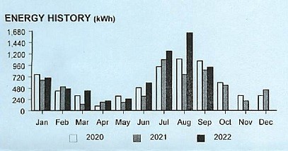

In the context of extreme hot weather 117F... Closer to what happened this past summer than not. Record electric demand here because, unusual this year, it didn't cool down as much overnight. So the RV A/C didn't get much of a break overnight. My electric use on the house was 30% to 50% higher than past years just like others in the area I compare too. I had tried out a "better" RV A/C air filter and then ran without one for a couple days. ( Filtertime brand ) It made a measurable temperature difference, warmer, due to the filter's restriction. Like 78F without and 81F with the filter: afternoon temp in the RV.
