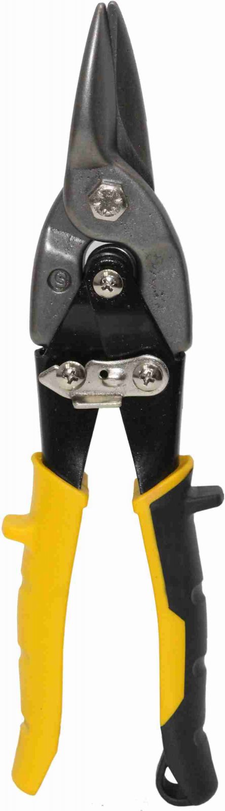

You have to figure out how to get the old band out of the transmission.
Either you cut it or you chisel up the spot welds on the bracket.
10-aviation-tin-snips-metal-sheet-scissors-iron-plate-cutter-original-imaggqhkkgx8zefz.jpeg
I think that was the one I saw before, I'll give it a look again. I've read that you can tin snip the old band once you loosen the adjustment and remove everything but I haven't opened mine up yet so we shall see.
