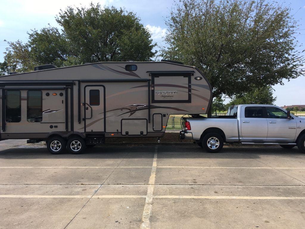

With the hitch and generator in the bed of the truck along with the pin weight the rear axel is at 5K#. It rides level but I would like it a little stiffer in the back end that's why I am trying the timbrens. When I get the replacement timbrens installed I'll report how they work out.
I have had the replacement timbrens on for two days and they are great. There is right at 1" space between the timbren and the stop plate. The timbrens are 3/4" shorter and the diameter is 1/4" less than the dr2500D, just perfect for my use. Stock ride unloaded, with the 5er pin weight the timbrens start to touch the stop plate on the axel.

I've got the timbrens on it, rides same as stock right now. The RV will get a good pull next week I'll decide after that pull if I'll go with the shock / airbag option. I had bags on my previous truck along with Bilstein 5100 shocks that did a good job. I don't want to loose the stock ride when empty. If the timbrens fail the rv test I think bags will be next.

Staying with the timbrens. After a 600 mi round trip I will keep the timbrens and add nothing else. With a total of 5300# on the rear axel the truck rides great with the replacement timbrens. 1700# 5th wheel pin, 150# hitch & 100# generator in the bed. Rough roads and railroad tracks are not an issue so long as one uses a little common sense. Did I say I was totally happy with the timbrens.
