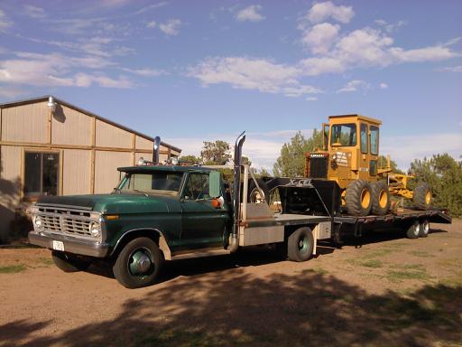

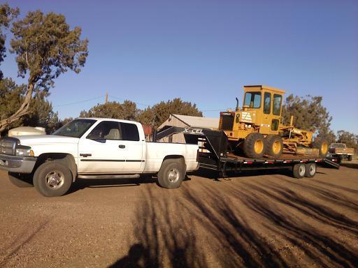

What is it and how is your truck set up now? If you have a 5 or 6 spd and 4.10 gears you might consider an Aux. trans. If you have a dually, it should be long enough. If you have 3.55 gears it wont be as handy, as double overdrive will be kinda useless, however underdrive will help some for startability.
With my '01 2500 6spd/3.55 gears, heavy loads are ok on the highway but off highway starting on a slight incline or soft ground I need low range. The Ford in my sig is wayyyy better!
