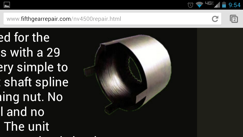

Just had the 5th gear quit in a 98 and 4th is still pulling fine. How long can I drive this?? I need to get home from Wash State to Wyoming. Can I do this or should I get it fixed?
Been in these before and I think this one has the full splined shaft but I think the nut has come off and the gear has slid.

I think I'd drop the transfer case and see what happened before going that far if for some reason the gear or nut is broke it can make one he!! Of a mess if nothing else drop it pull the nut and the top gear off the shaft and put it back together
NV never re-designed the mainshaft to spline it under the full length of the gear. It is generally the case that you should go to the fully splined mainshaft.
