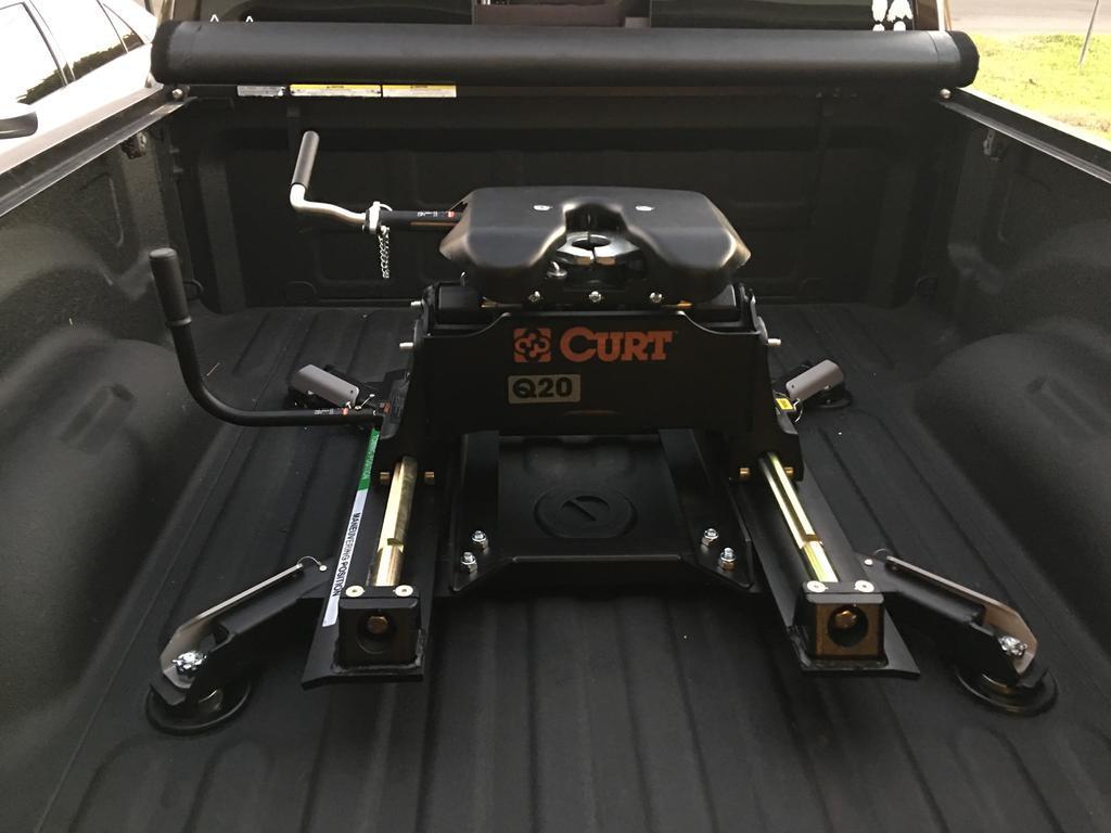

This is what I'm using> The Curt 20k hitch with slider.
I had the 20k Curt already and it only had about 400 miles of use so I didn't want to have to buy a whole new hitch. When I got the new truck I bought the Ram legs and swapped them out with the standard ones on the hitch. It's definitely heavier but it's a super solid connection to the truck frame. Have you looked to see if your hitch manufacturer has the OEM adapter?

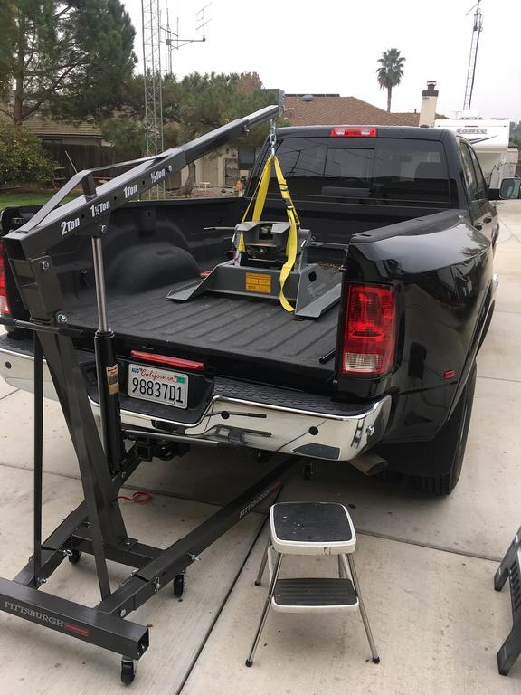

Reese picture frame weighs in at 54.3 lbs and Demco 6099 around 75 lbs (86 lb shipping weight).
The Reese is rectangular tubing and much thinner stock. The Demco is made up from normal heavy gauge bed rails that are plated on the bottom. Latches are very robust.
And yes I use to pull the whole thing with a HF 800 lb hoist before DW sold the house.

Although it's an 8' box, I bought a Engine Hoist on sale at Harbor Freight after my 3rd hernia operation...
