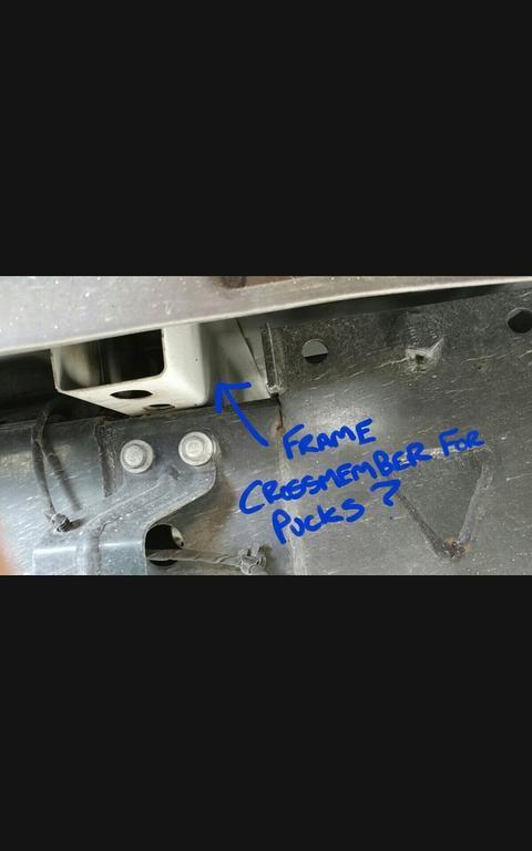

Post some pictures of what the 2017 frame mounts look like. Maybe I can help, I installed my own pucks in my 2015 3500. SNOKING

Thank you, I will if I knew exactly what I was looking at/for. I took these the other day from inside the driver's side rear wheel well. Am I looking for the presence of specific bracketry underneath the truck?

Back passenger side.

Front passenger side.

There are matching welded on plates on the inside of the frame rails at all four locations.
