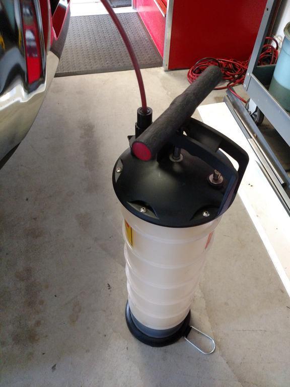

Use this on my outboards, should work on transmission.
It looks to me like kcpolk's plan was simply to use the fluid pump to empty the pan BEFORE REMOVING IT, in order to avoid a mess. He was still going to replace the filters.
I'm aware of HIS plan. If he is able to remove fluid without dropping the pan, then MY plan would be to swap out as much fluid as possibly every 20K miles and drop the pan at longer intervals. Removing dirty fluid and replacing with clean fluid will extend the life of the filter.
How about just removing ALL the oil? Pic shows at least 50K on AMZ/OIL on complete fluid replacement. This is with a LOT of the miles towing a combined 29K with 3:42 gears.

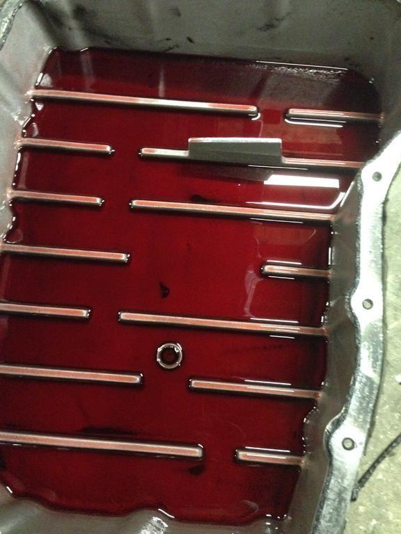

Hey Guys..... yes, I did the full transmission (fluid and both filters) service last weekend. I used a large Mityvac (like GB posted above) and about 6 ft of 1/4" Poly tubing. It took 15 minutes to pull out about 90% of the fluid from the trans.... then I dropped the pan. Worked great! Turned a PITA messy job into an okay job. The oil pan was pretty clean.... the magnet had some normal metal "fuzz" on it. I probably could have waited until the 50k mile mark or so..... but, I figure better to do it early rather than late. I did notice the dip stick was touching the pan on the inside (thanks for the info!)..... it had left a mark, but not even close to rubbing thru..... I went ahead and ground about a 1/16" off the end of the transmission dip stick, just to be sure. The shorter stick has no effect on the fluid level.... I would recommend everyone do this simple mod. I refilled with 8 quarts of Valvoline ATF+4 and down the road happy I am. Also, while I had the Mityvac out and few spare quarts of ATF+4, I pulled out about a quart of Power Steering fluid sump and refilled with fresh. Why not? LOL......

I just serviced my transmission I used the vac pump idea. I found that I had to cut the end of the draw tube at a angle so I could get it all the way down into the pan and not stuck up on the shelf. I had the dealer service the unit last year at 25,000 miles. I now have 50,000 miles on it. The tec that had serviced it last year had crushed the spin on filter. wasn't leaking just crushed. Also I found my level was low. Put it all back together put in 8 qts only to find it very over filled. seems to take only 6 qts.... My question is how much over filled is Ok? That said I was very pleased by how clean the pan was only a very small bit of fuz on the magnet.
