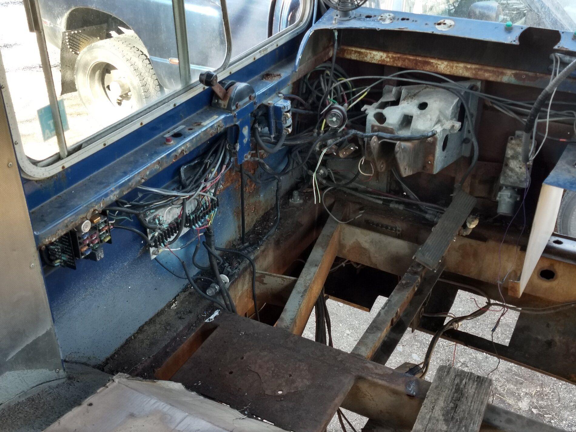

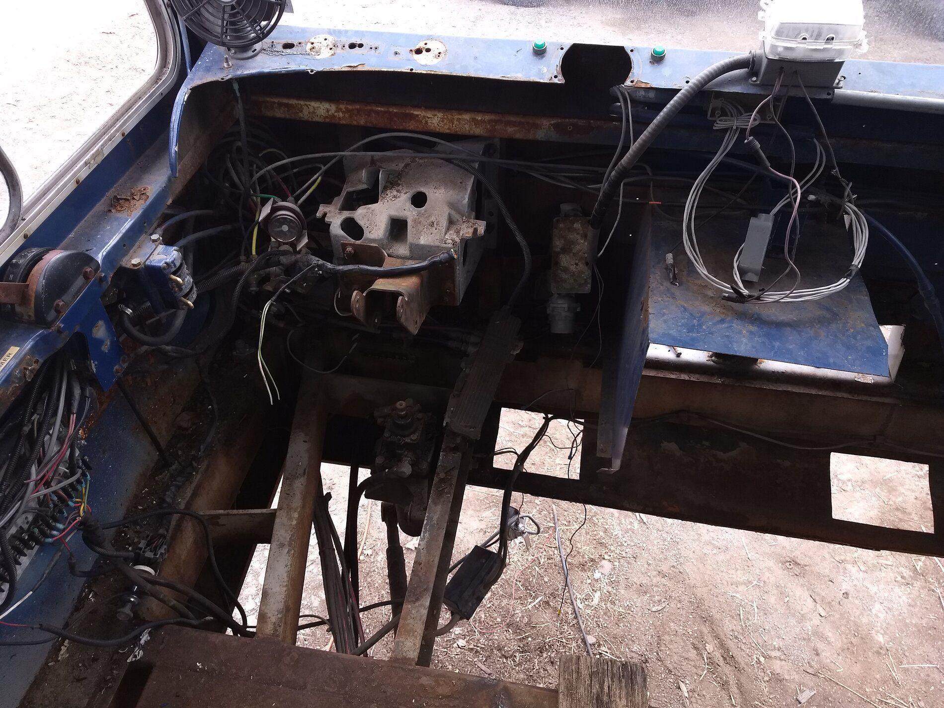

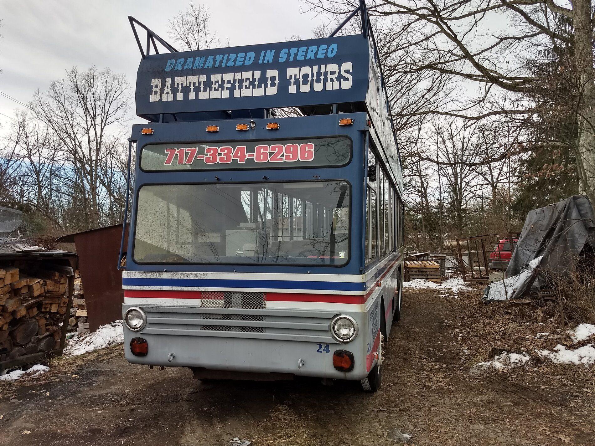

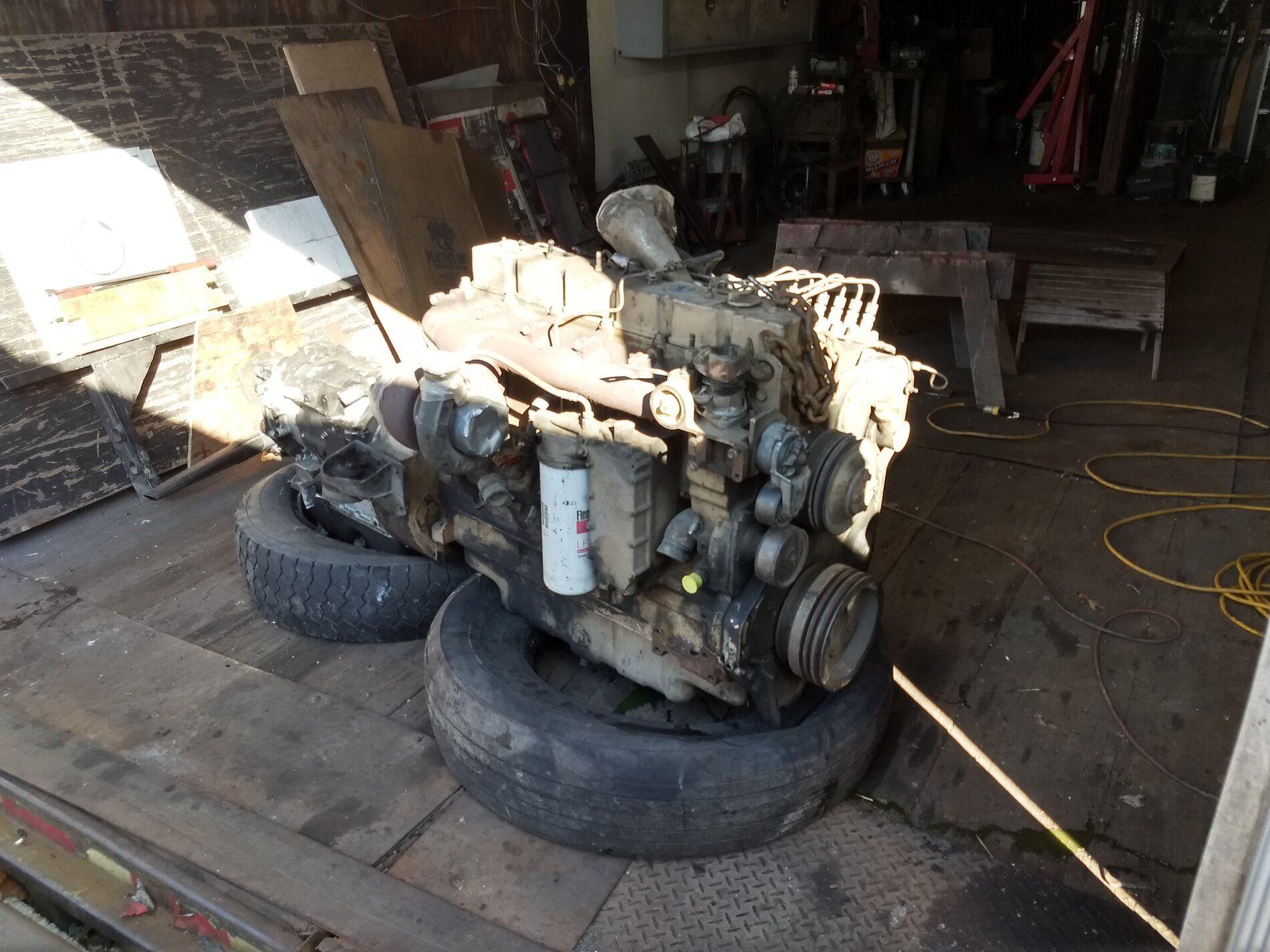

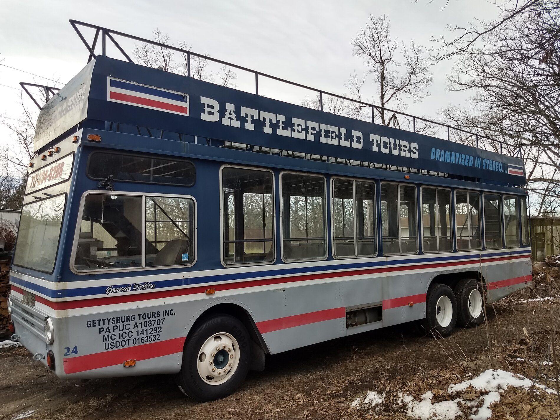

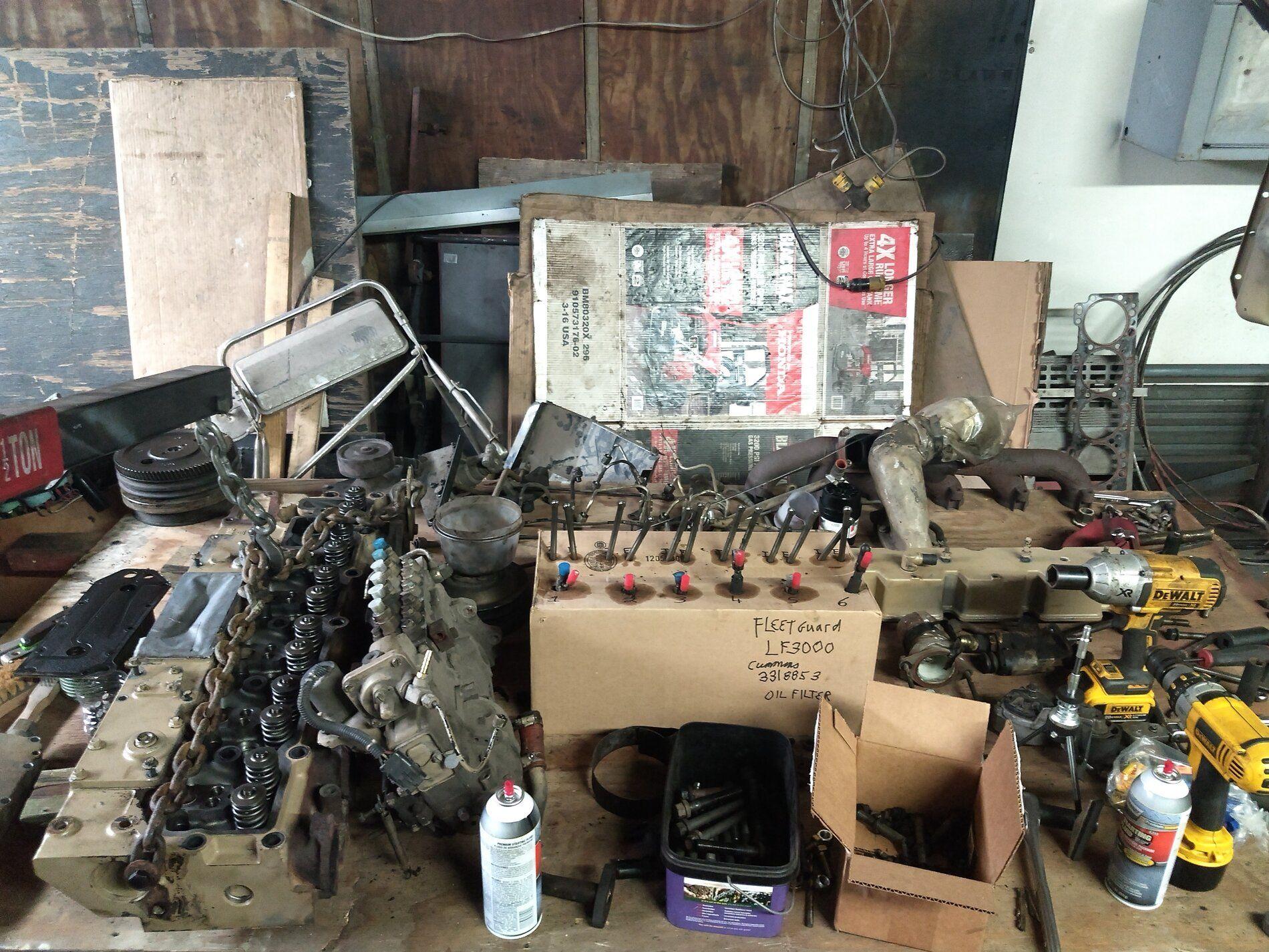

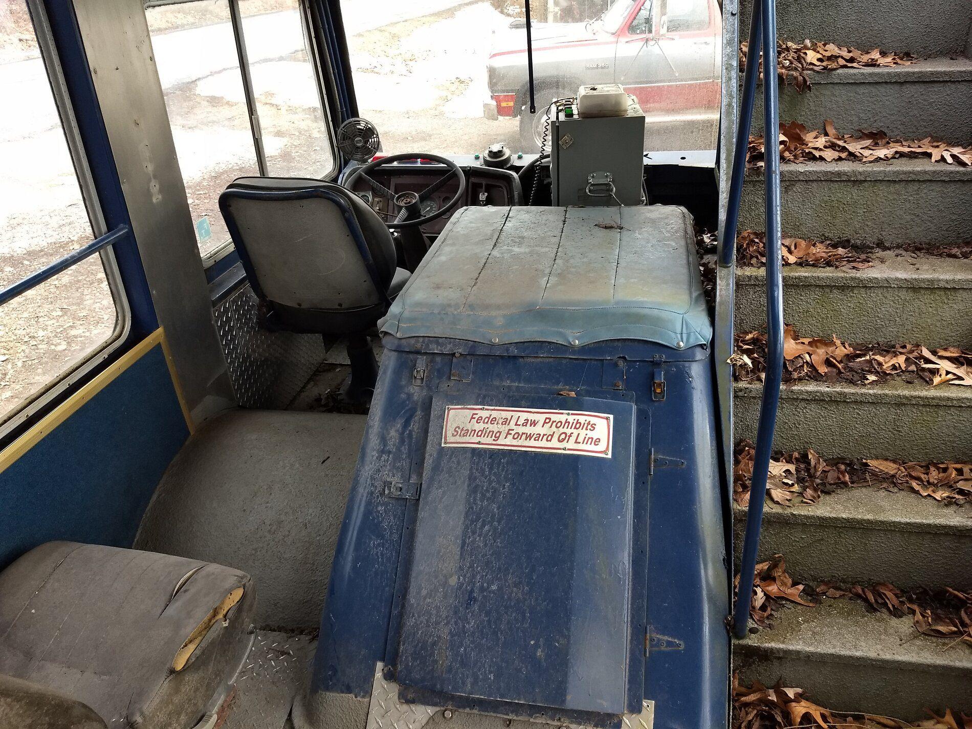

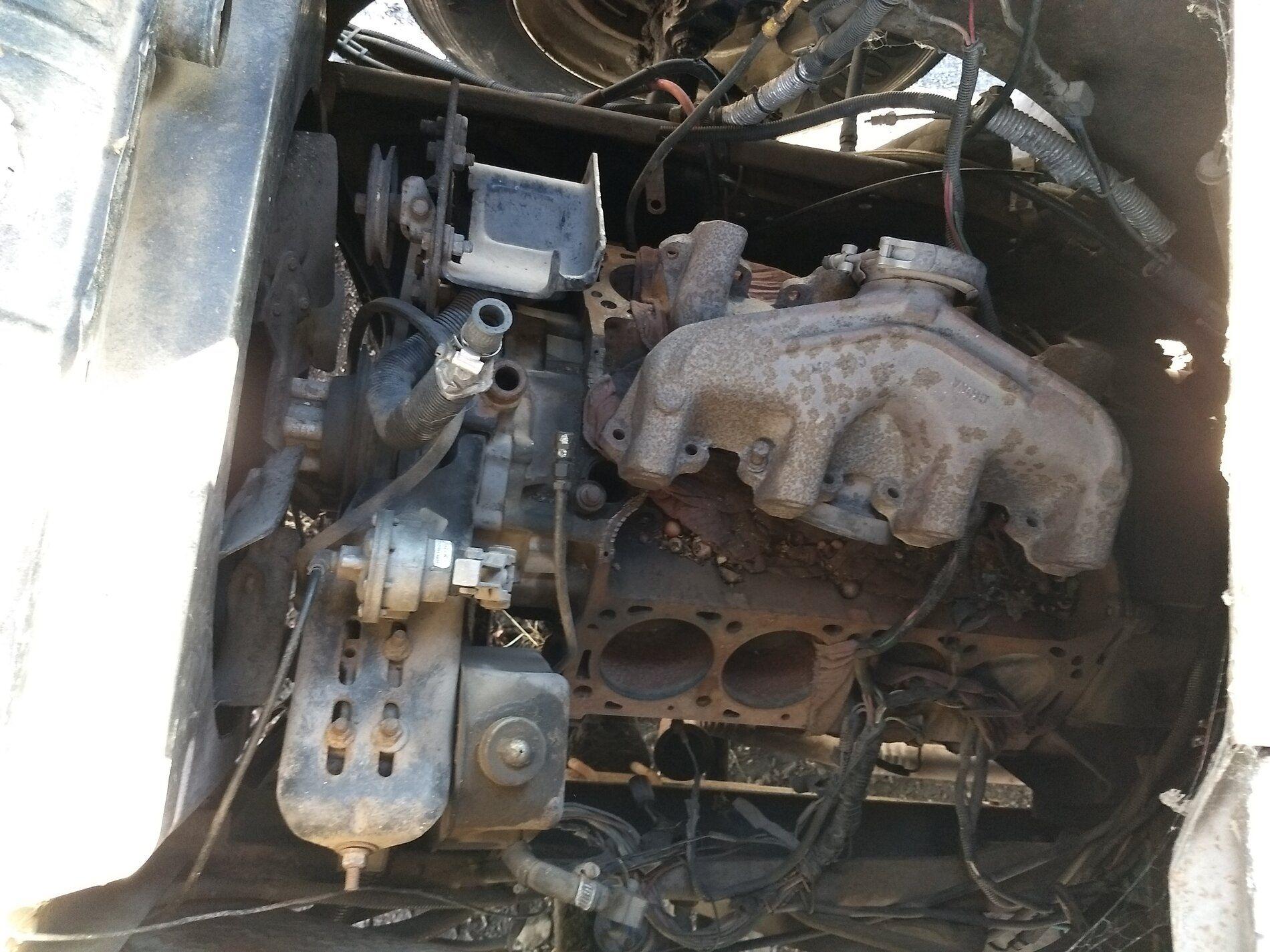

Ok so its not a Dodge but it is a Cummins so i thought id share it with every one. What my project started with a 1974 open air double decker bus build on the chassis of a 74 Ford L9000 truck powered by a big block Ford V8 that burned propane coupled to 4 speed direct drive Allison automatic transmission, powering a tandem drive with 11R22.5 tires. The bus is used for doing tours on the Gettysburg Battle Field, but the V8 had been over heated to the point of blowing the head gaskets and warping the heads, It then sat in the parking lot of another shop before coming to me.

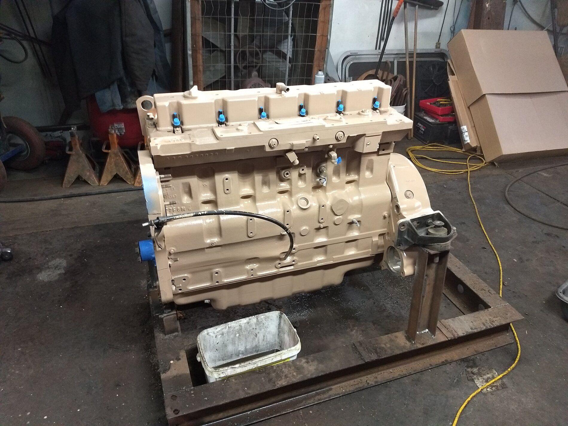

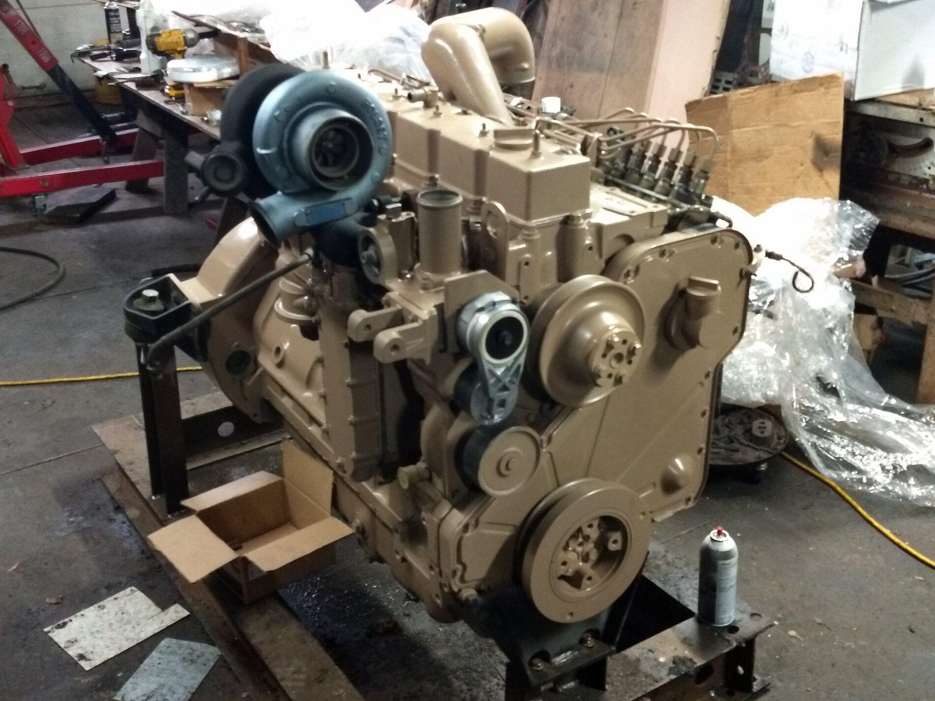

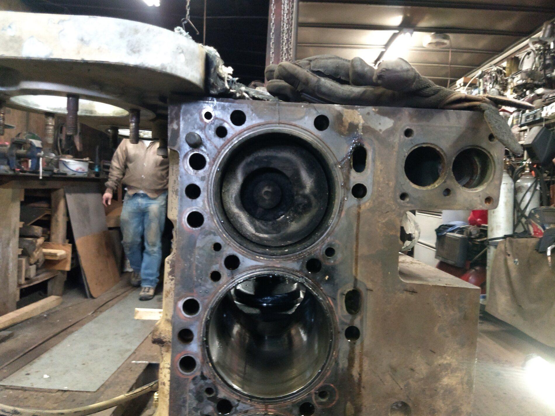

But before we could put the cummins in we went over it and gave it rebuild and valve job and fresh coat of paint to make it pretty and a few small modifications like turning the exhaust manifold upside down for better turbo clearance in the bus.

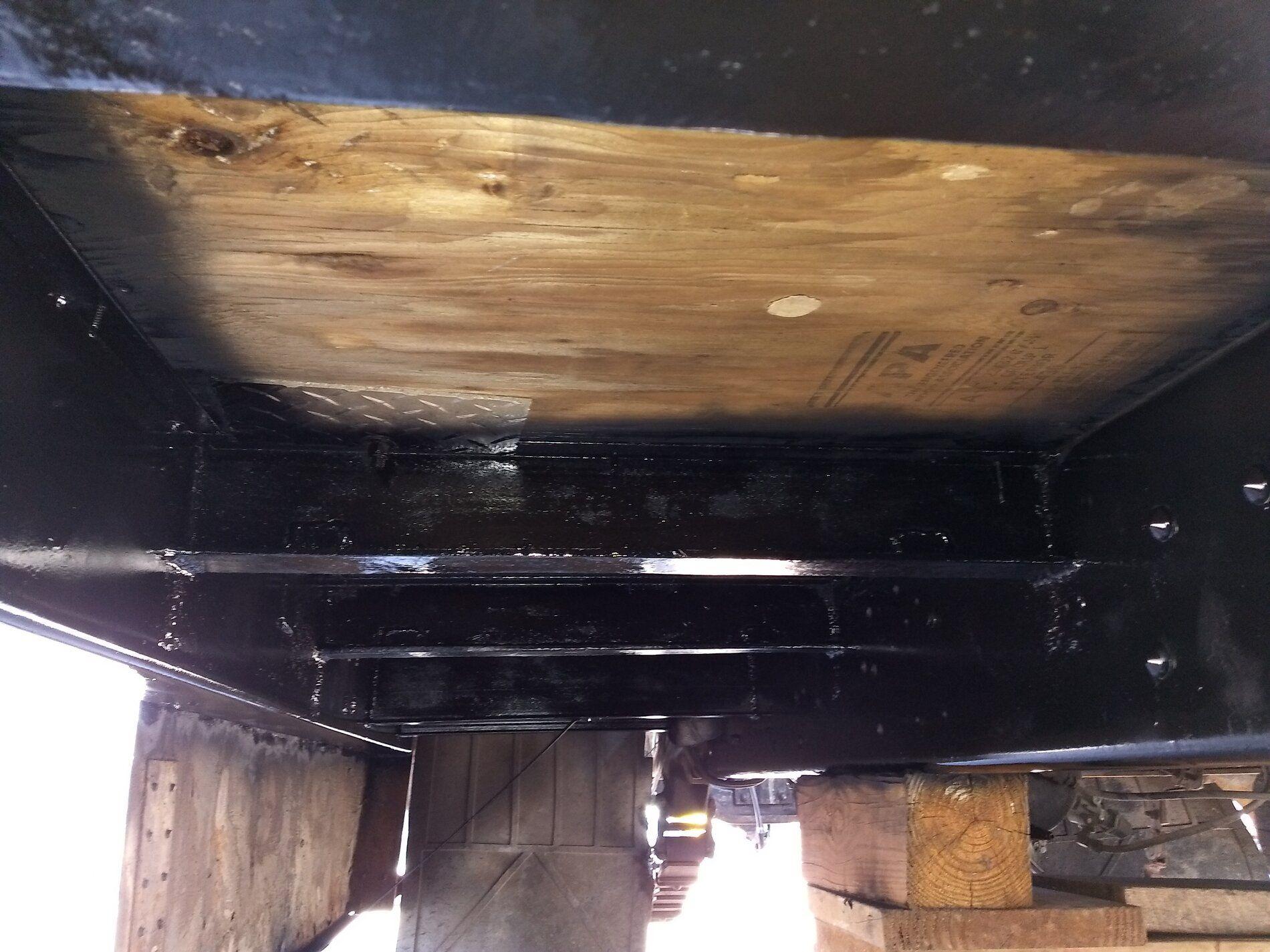

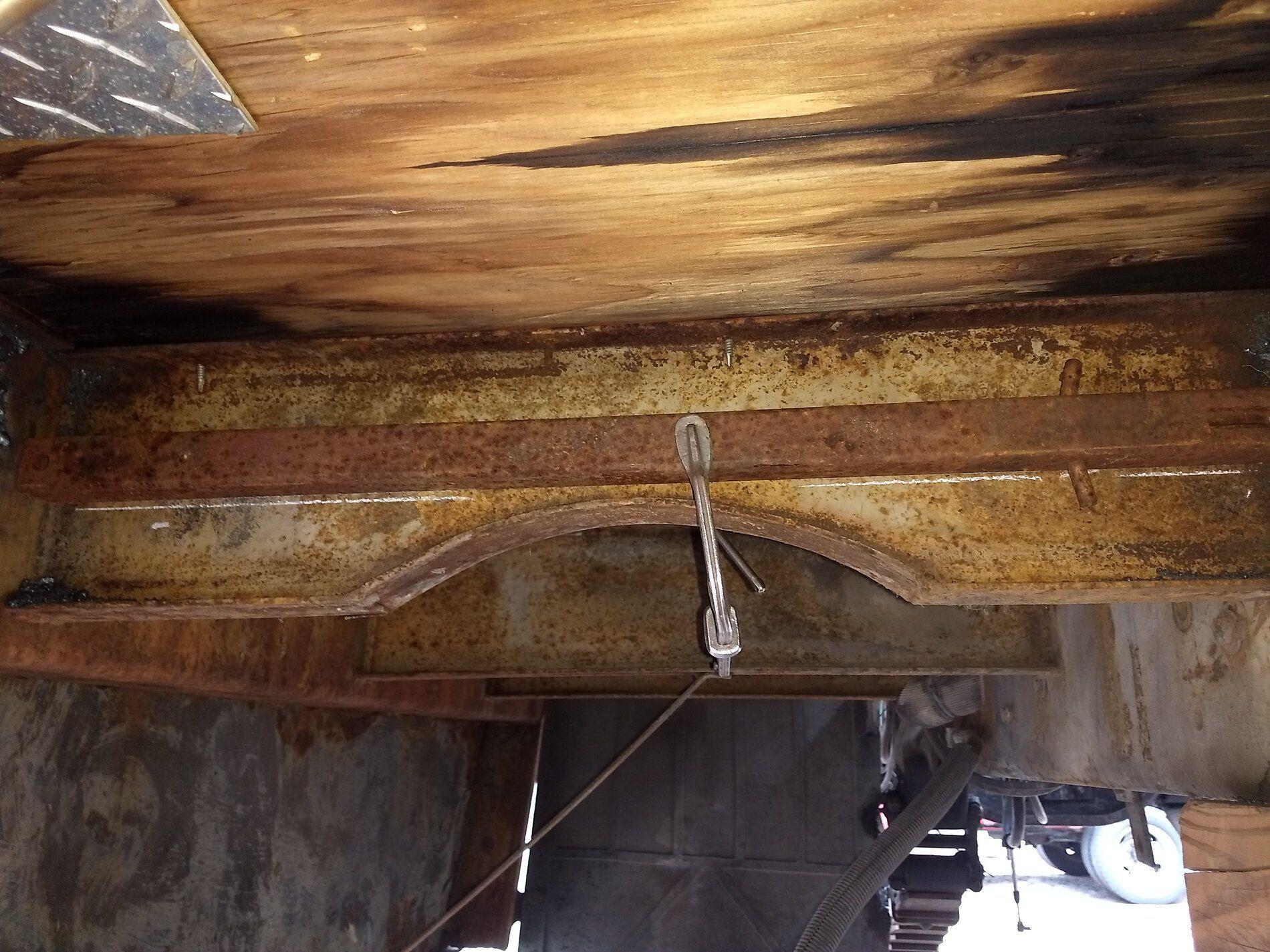

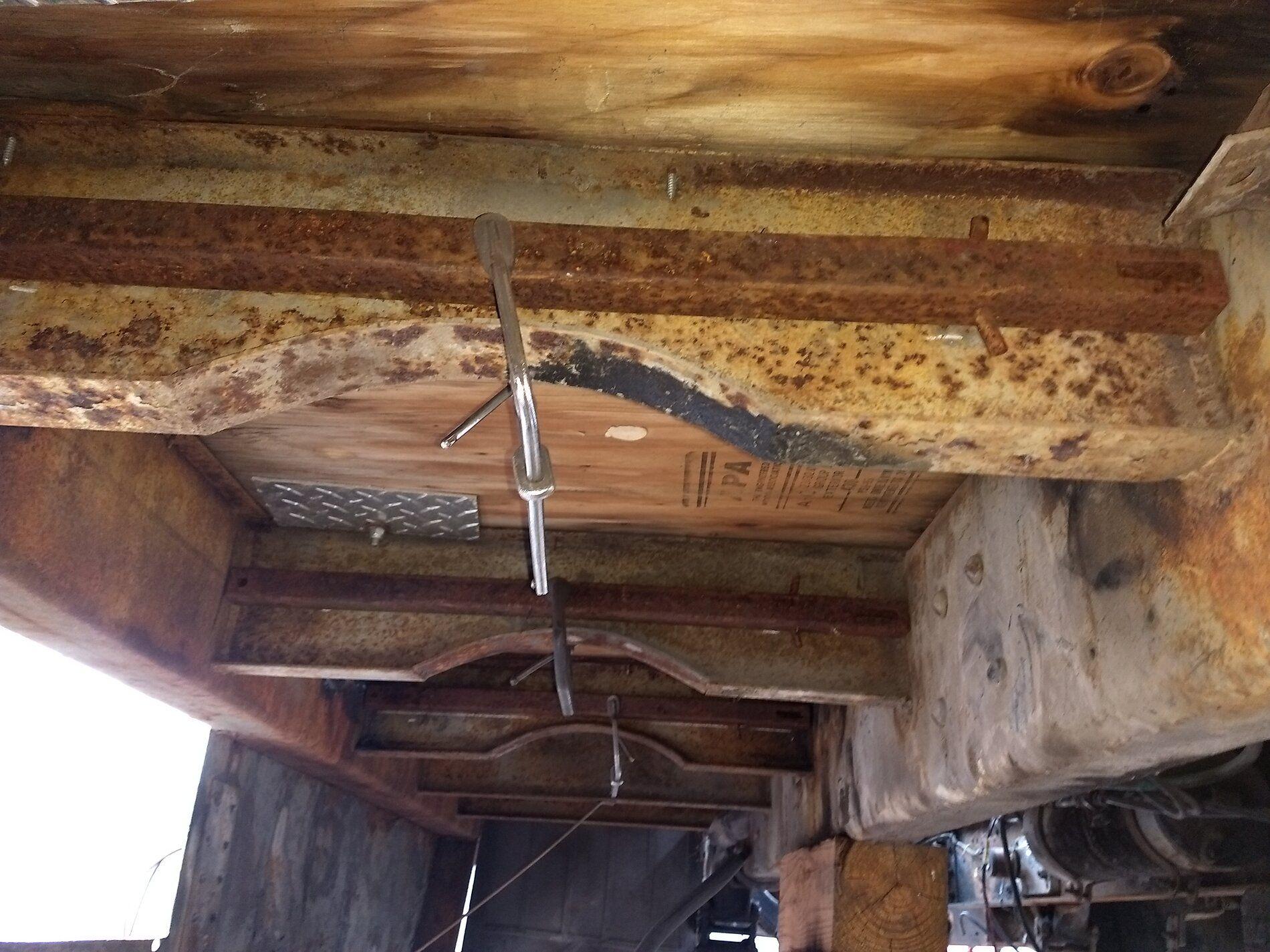

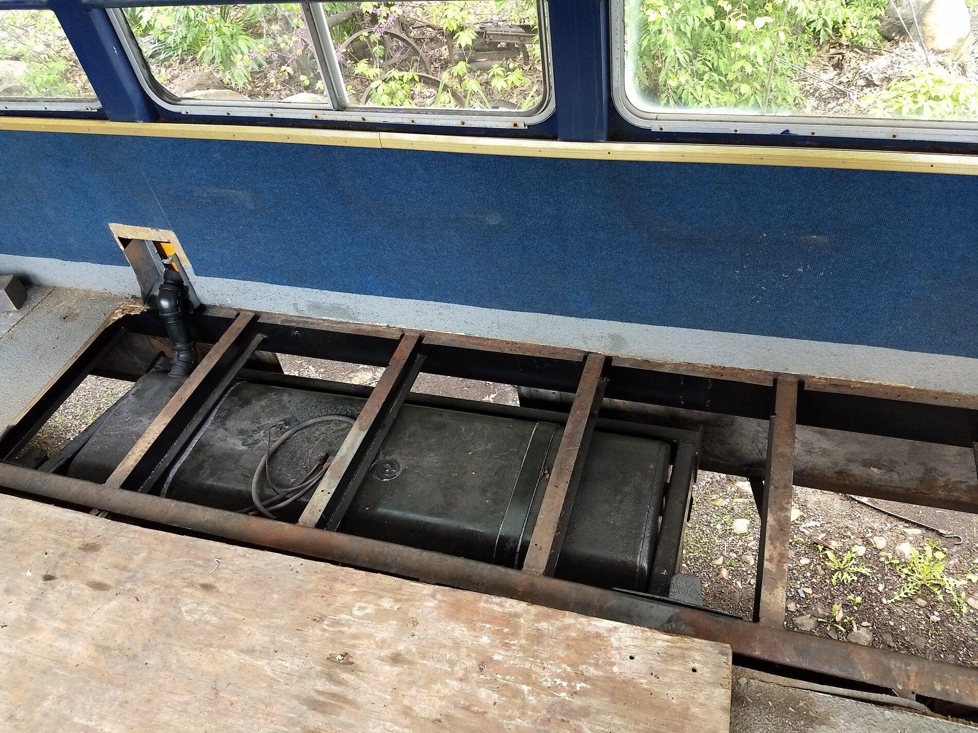

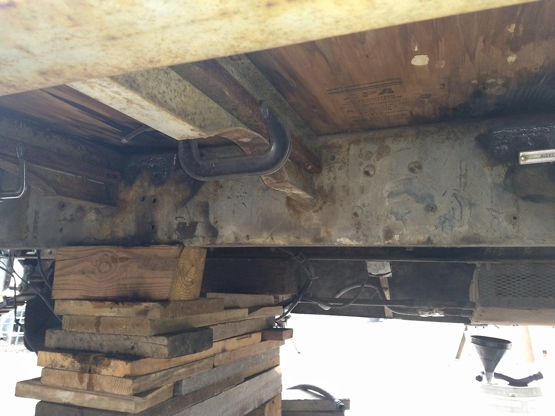

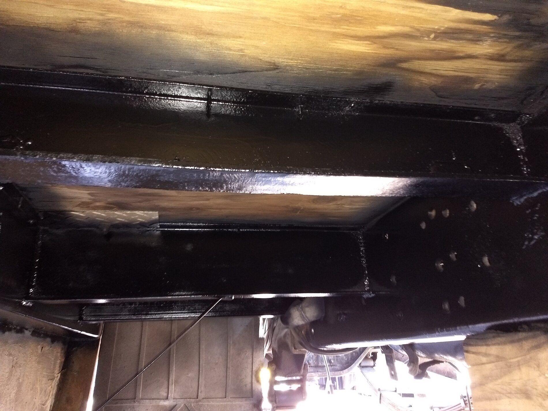

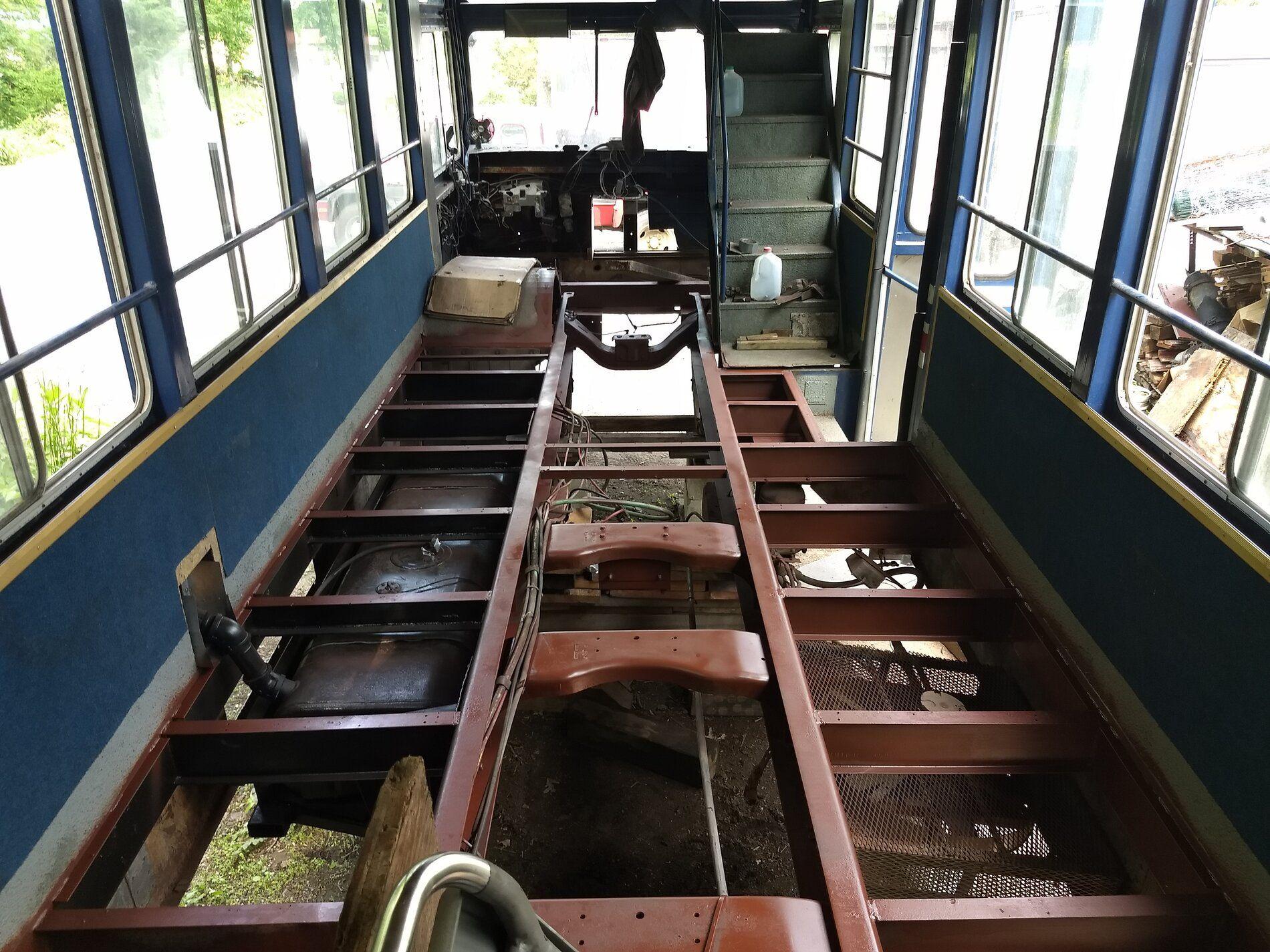

up next was modifying the floor stringers to fit a square diesel tank instead of the round propane tank

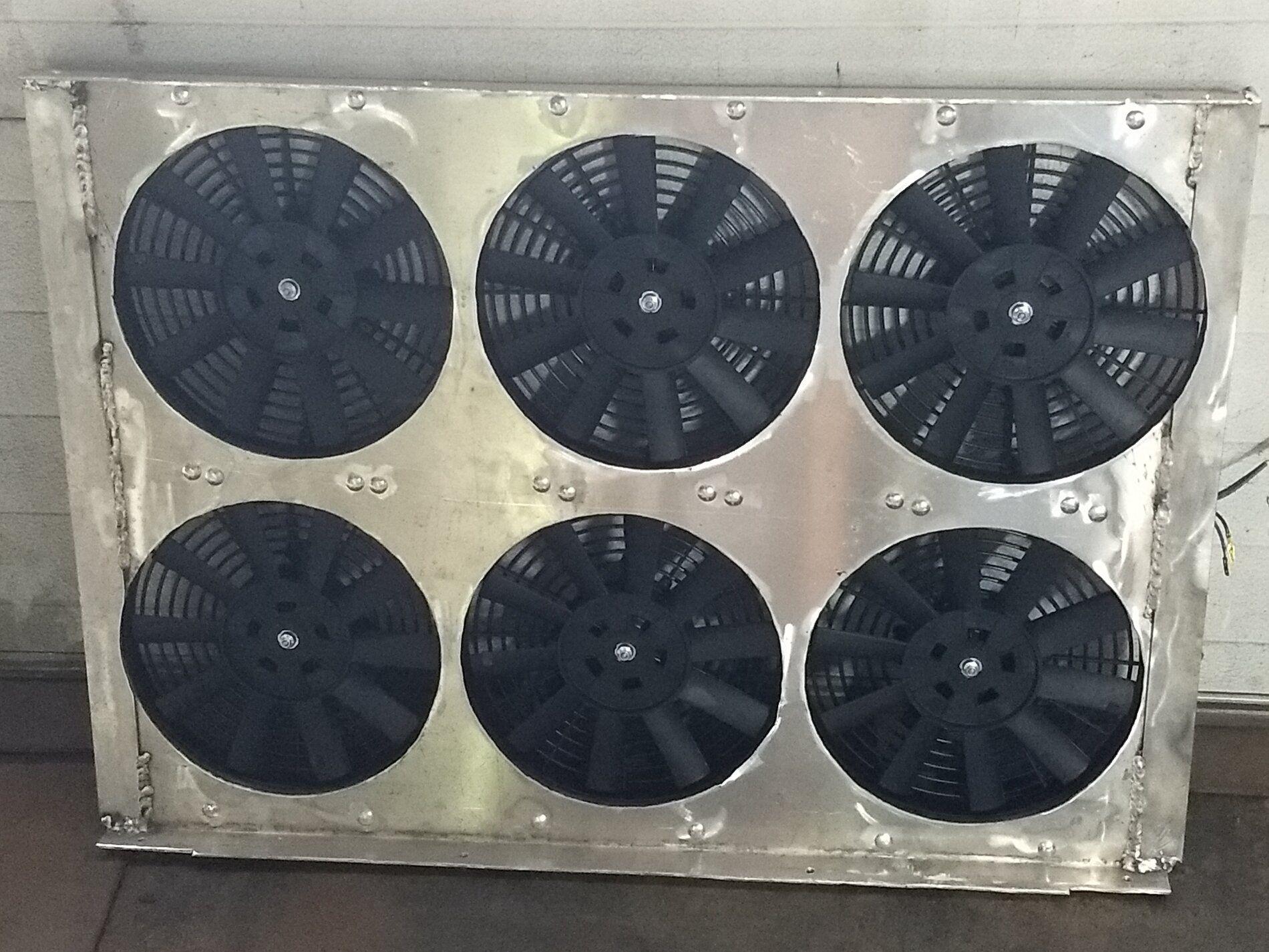

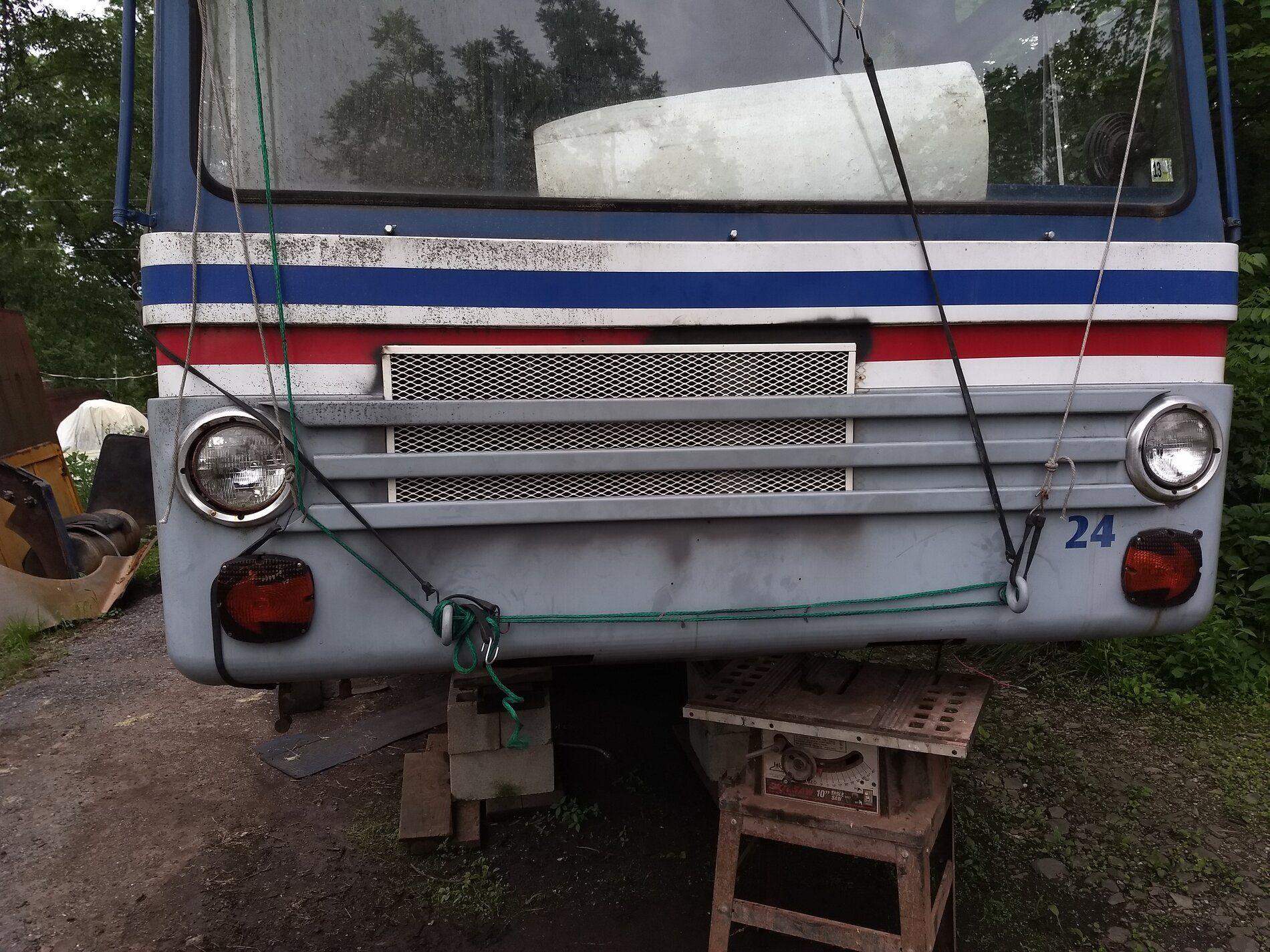

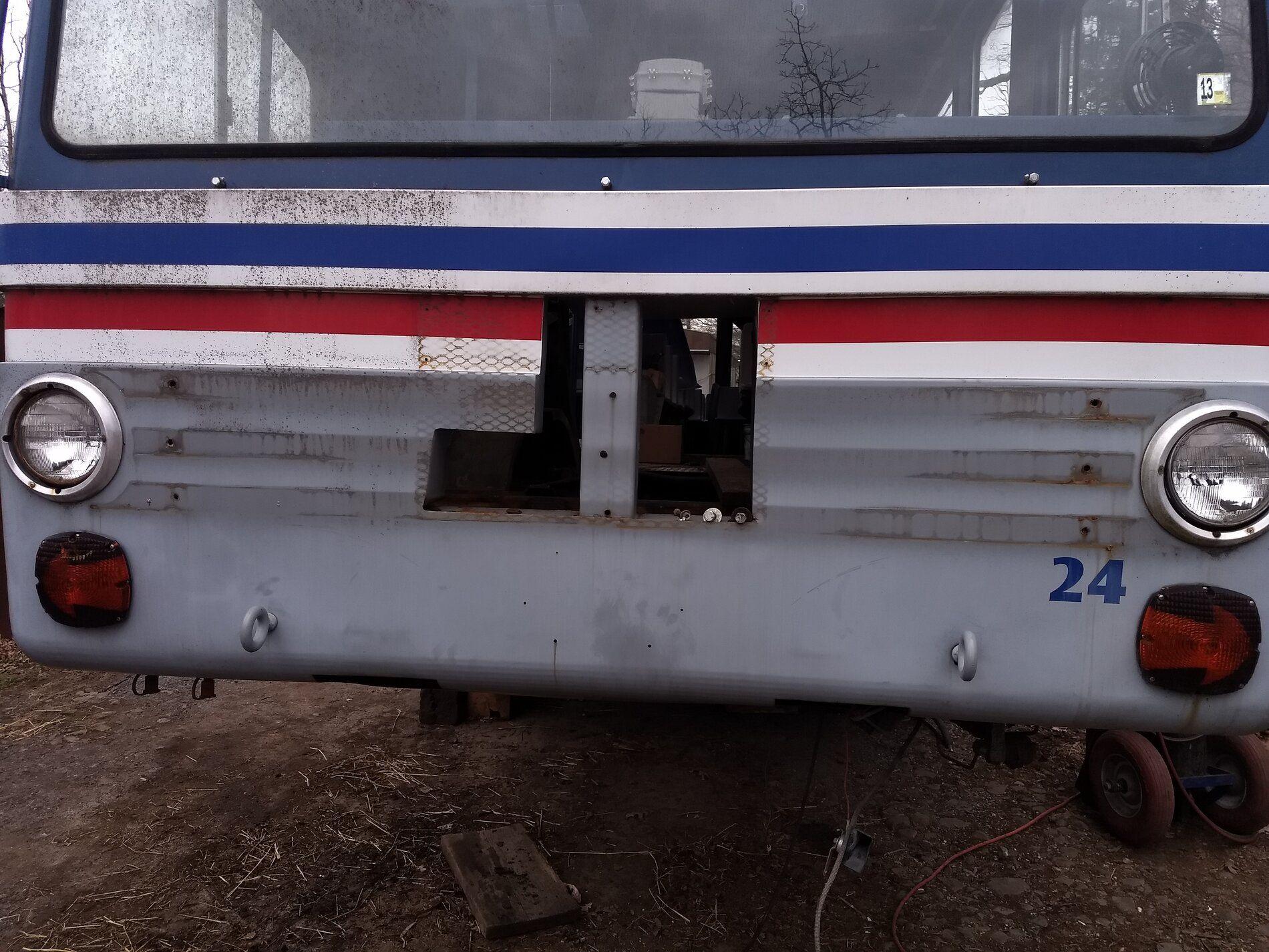

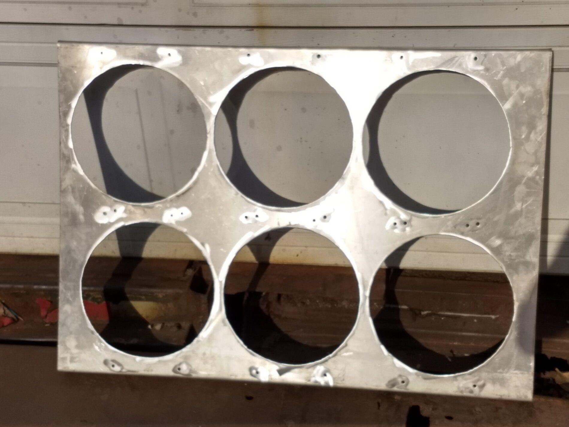

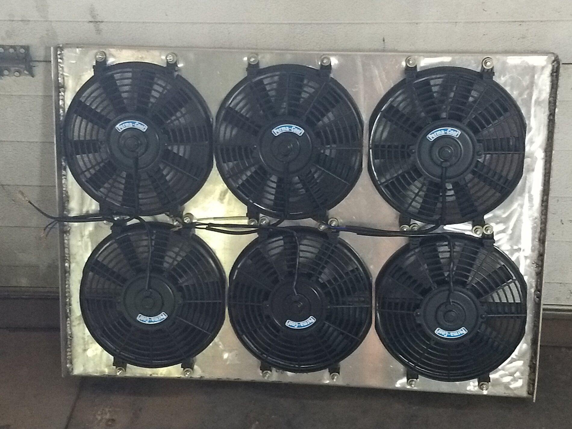

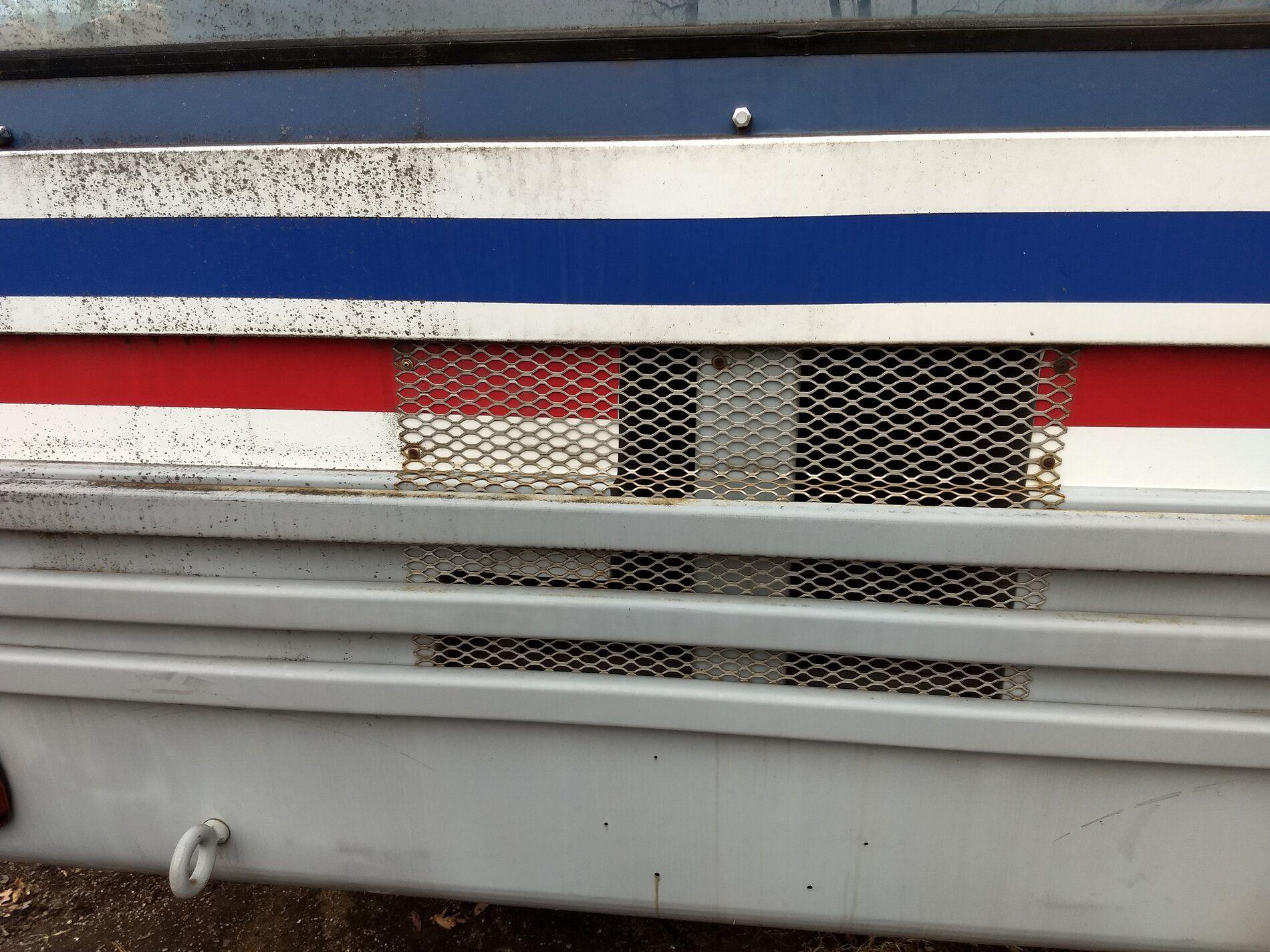

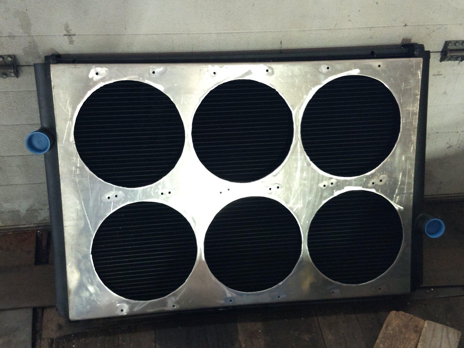

to prevent a repeat of the over heat issue with a V8 we increased the the size of the grill opening in the front of the bus and because of the distance between the engine and the cooling stack electric fans were needed

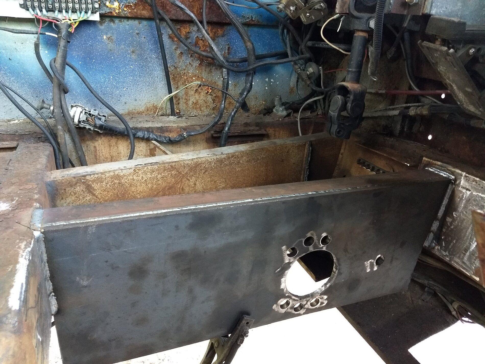

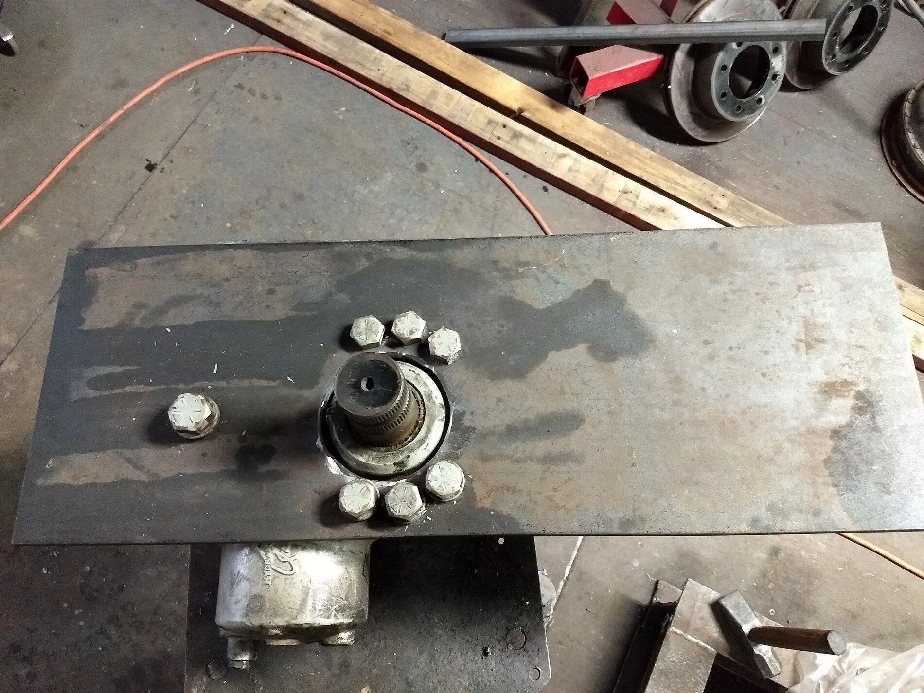

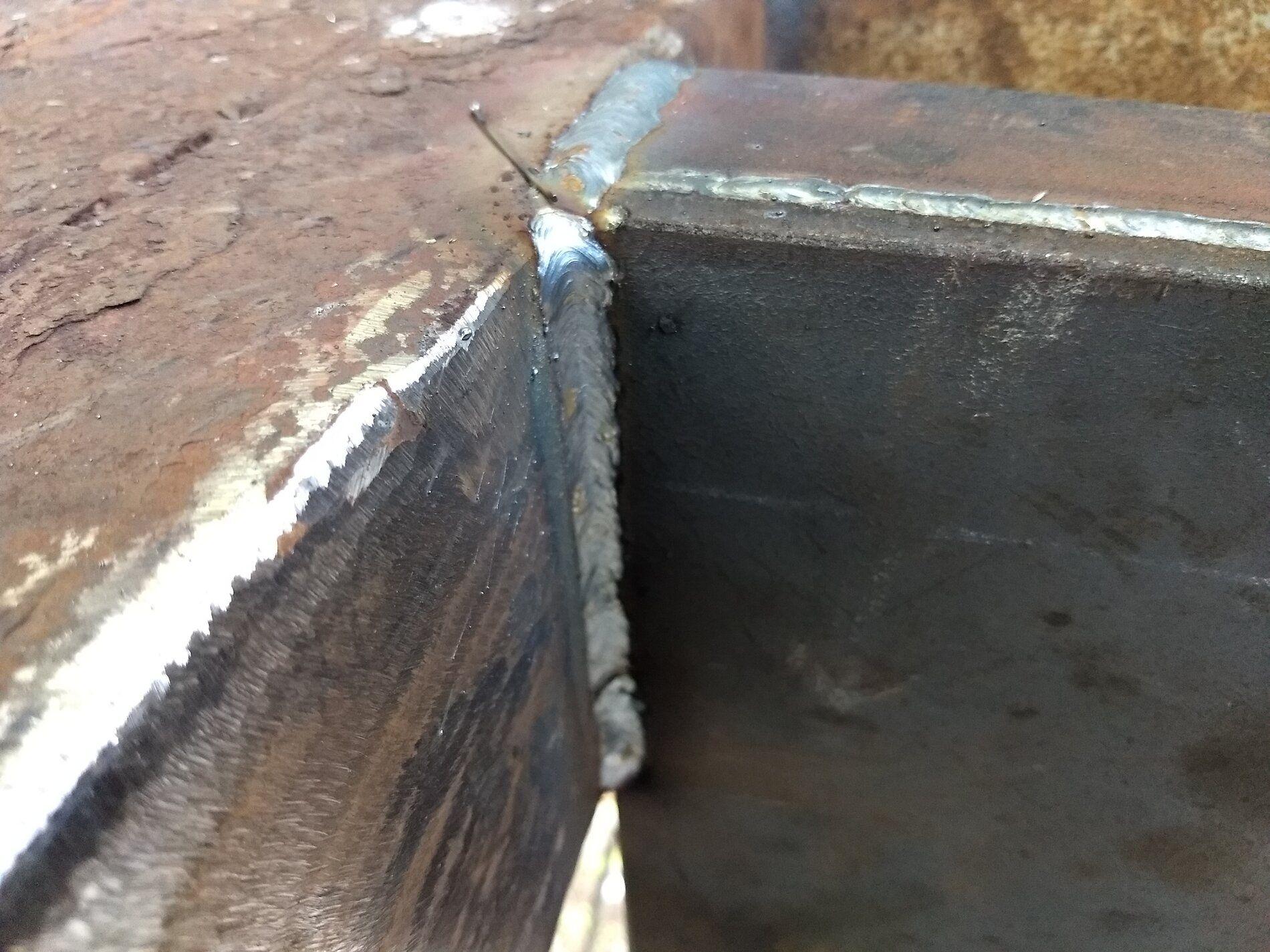

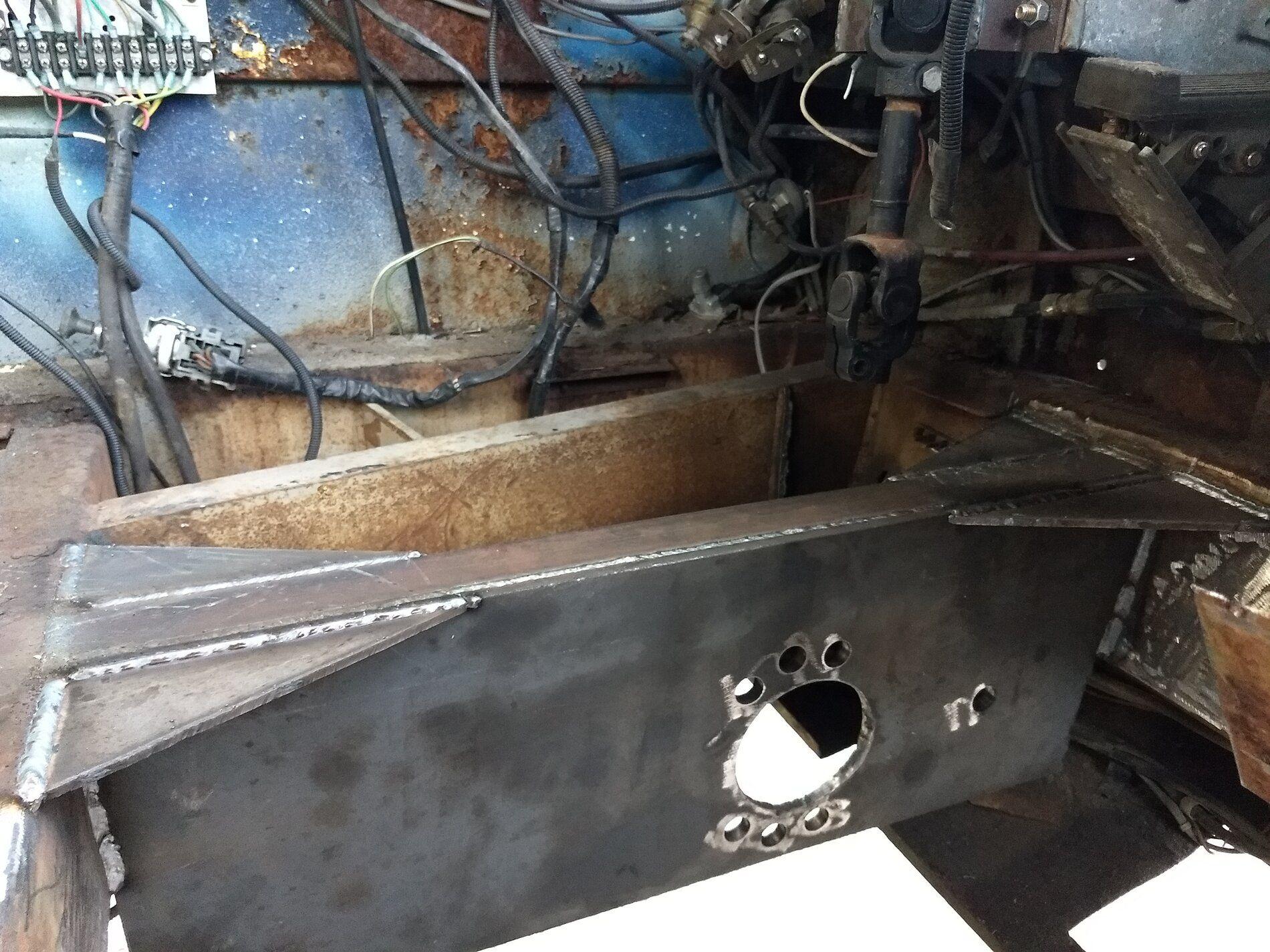

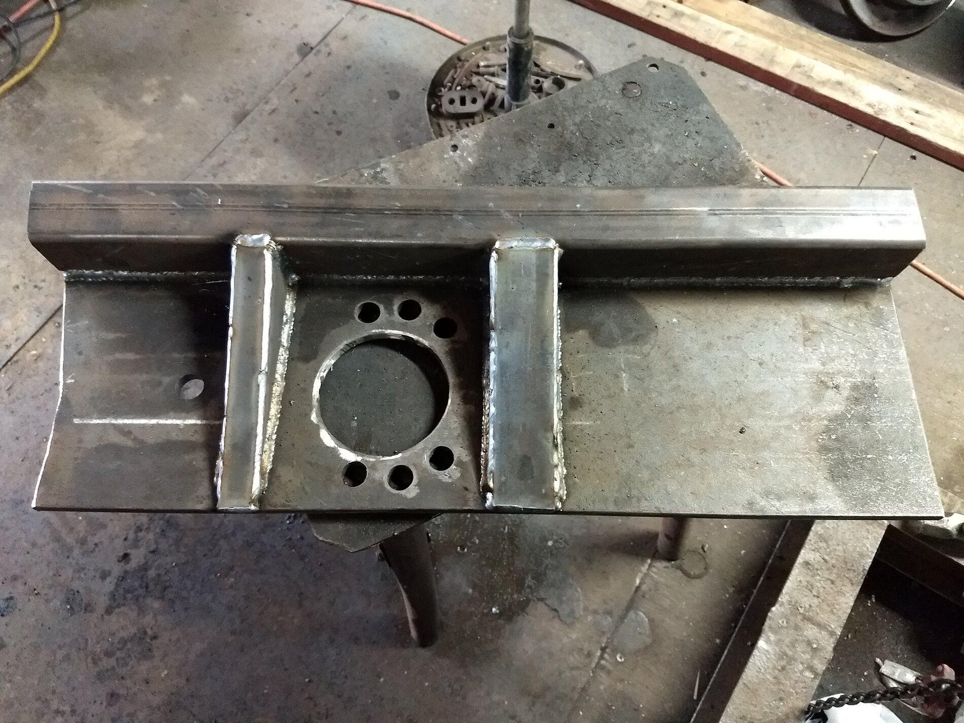

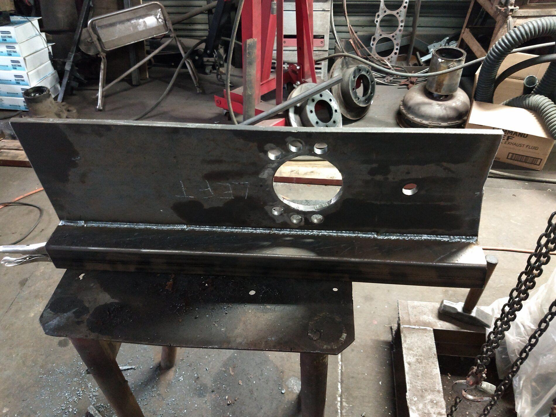

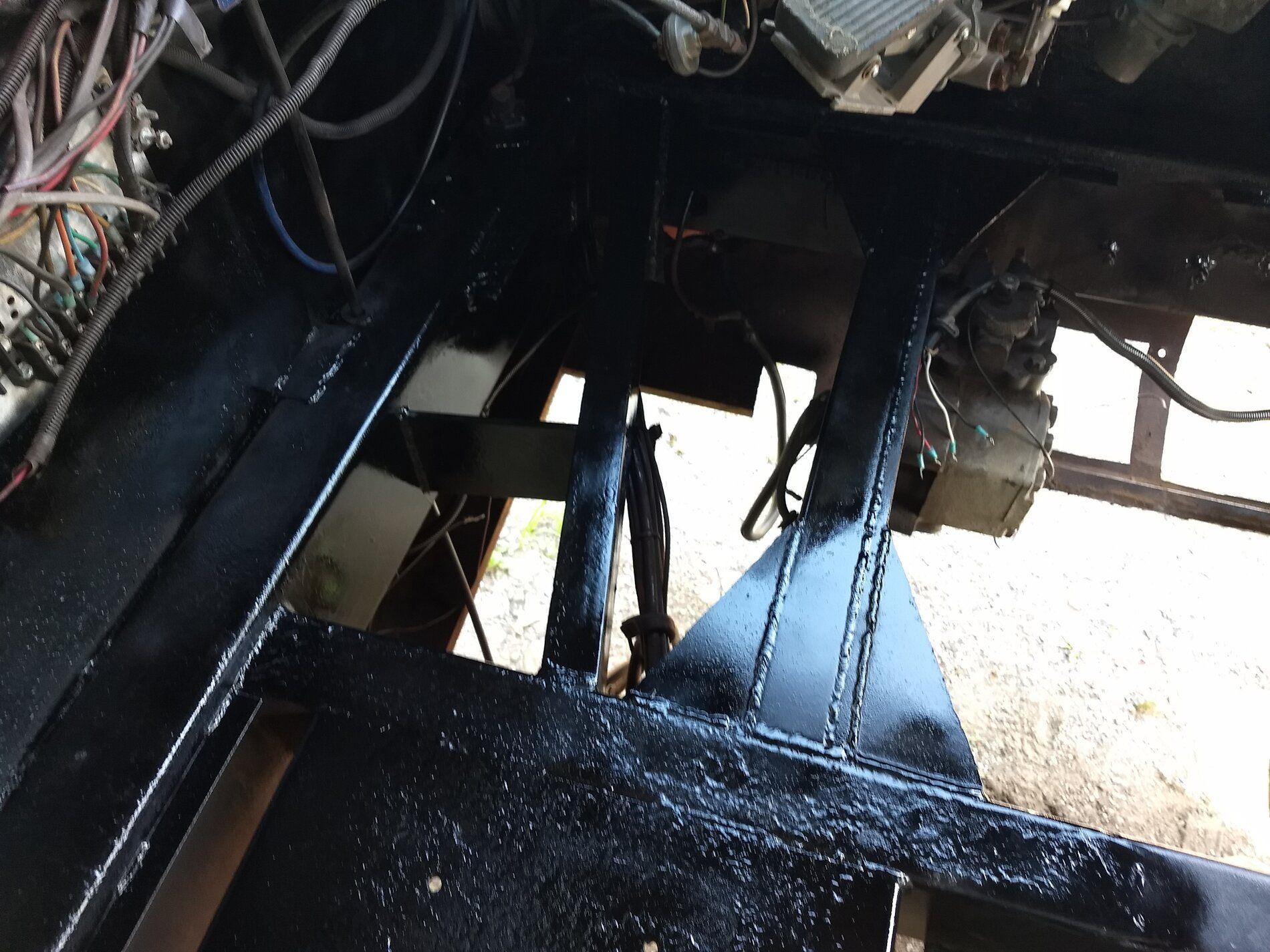

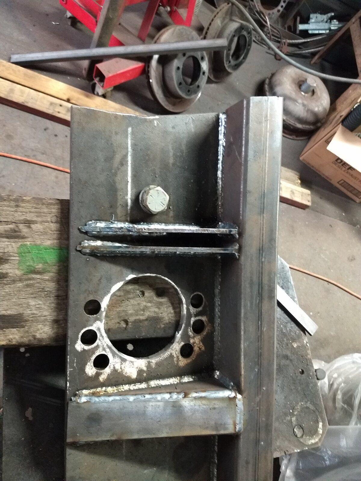

While we were working on it we found the steering gear box was junk and had more then half a turn of free play in the steering wheel. We thought that the factory box was a little small and we couldnt find a direct replacement so we decided to swap in the steering box and column from a MCI charter bus, which required making a welding in a new box mount to the frame.
The new mounting plate started as a peace of 1/2" thick steel that i welded a 1/4" wall 2X2 square tube to then added 1/4" triangle braces to

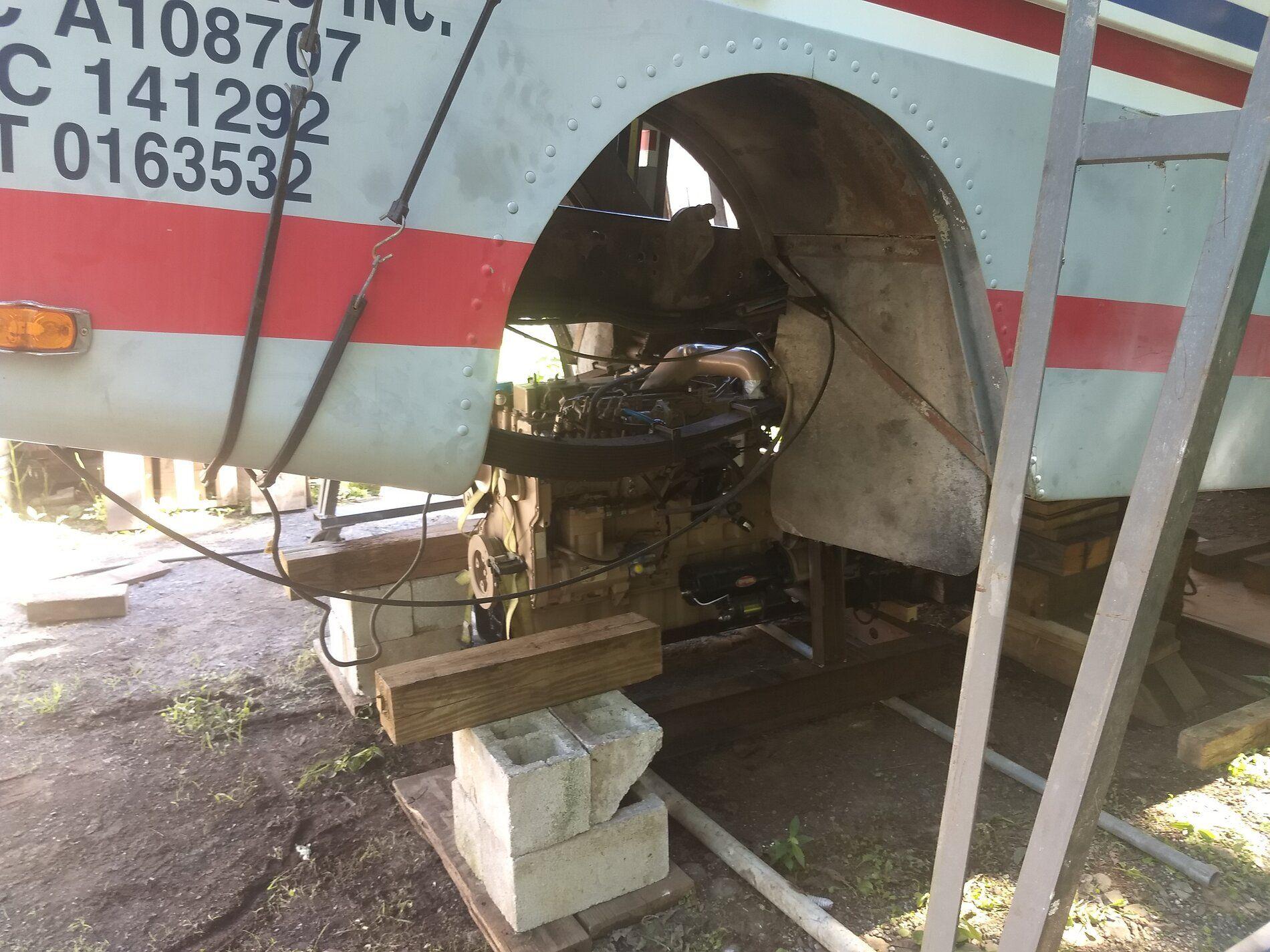

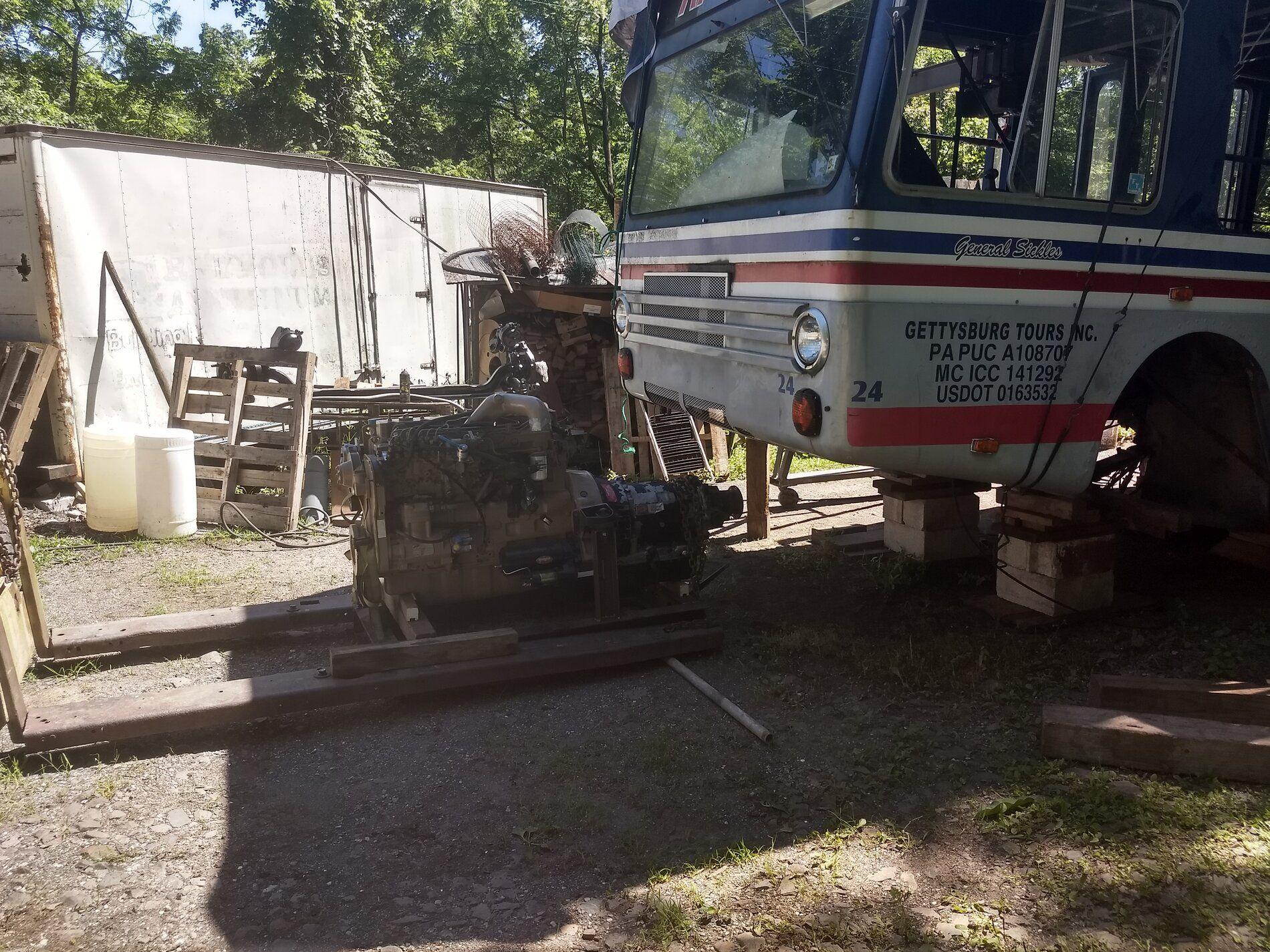

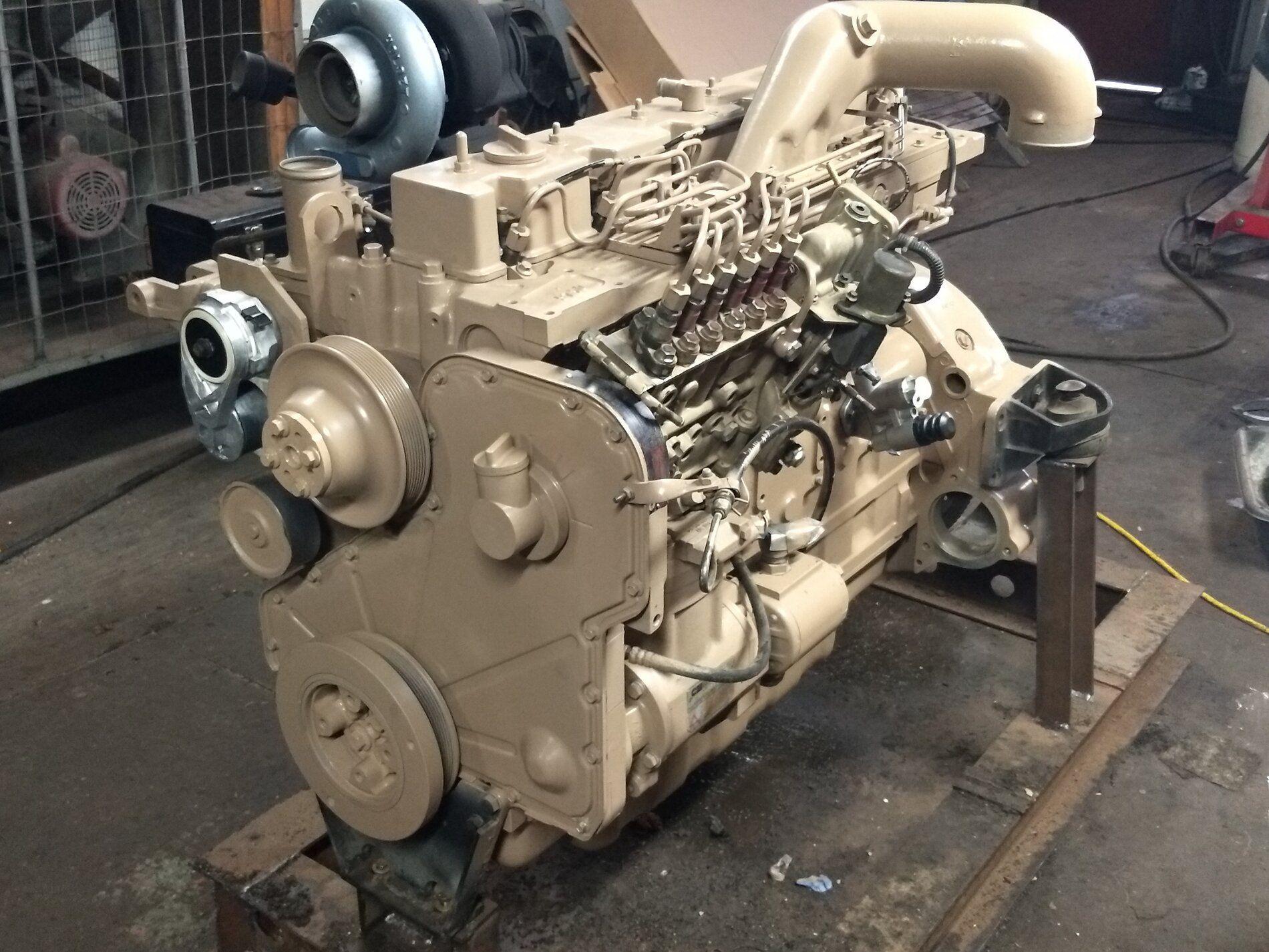

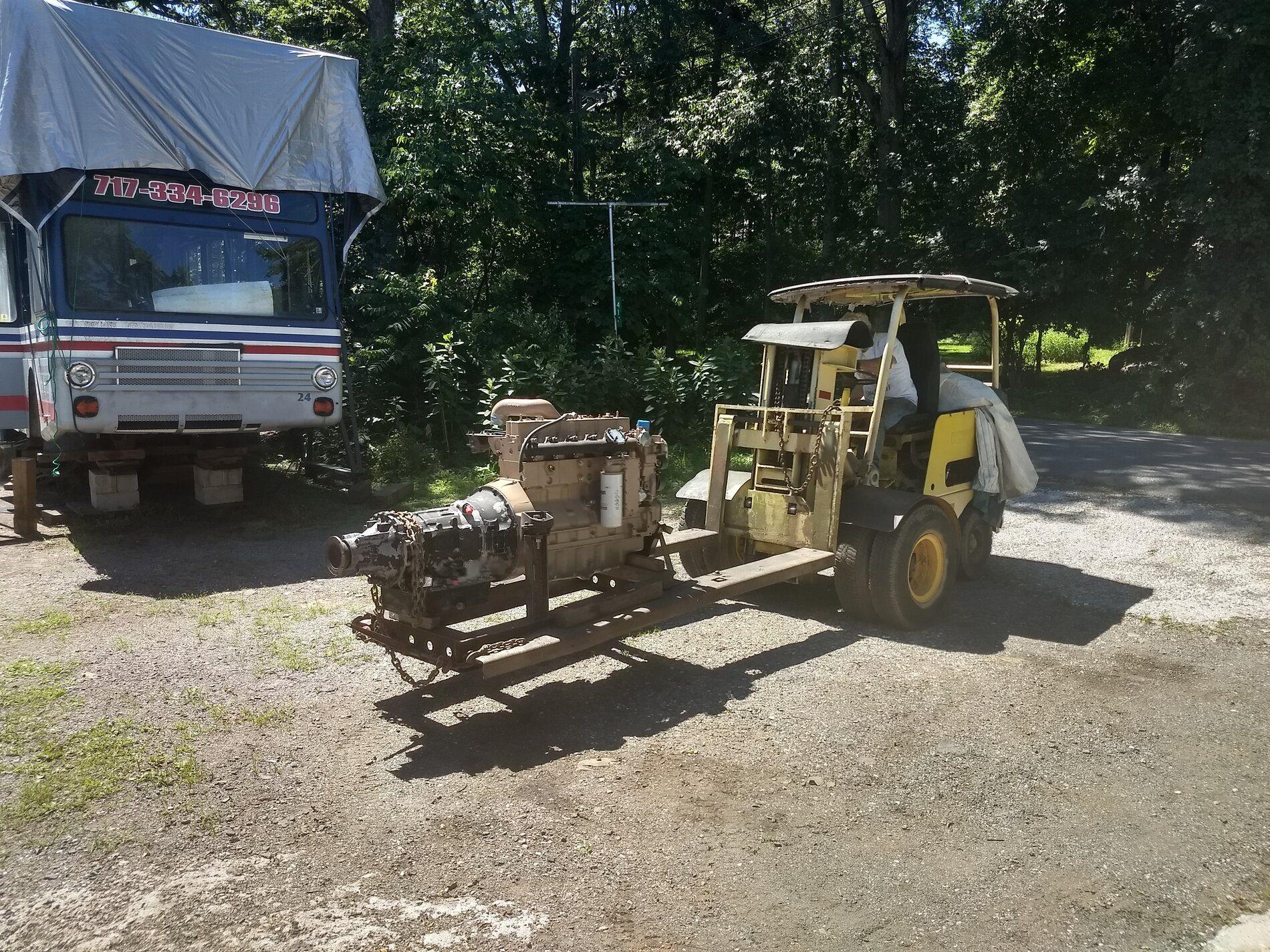

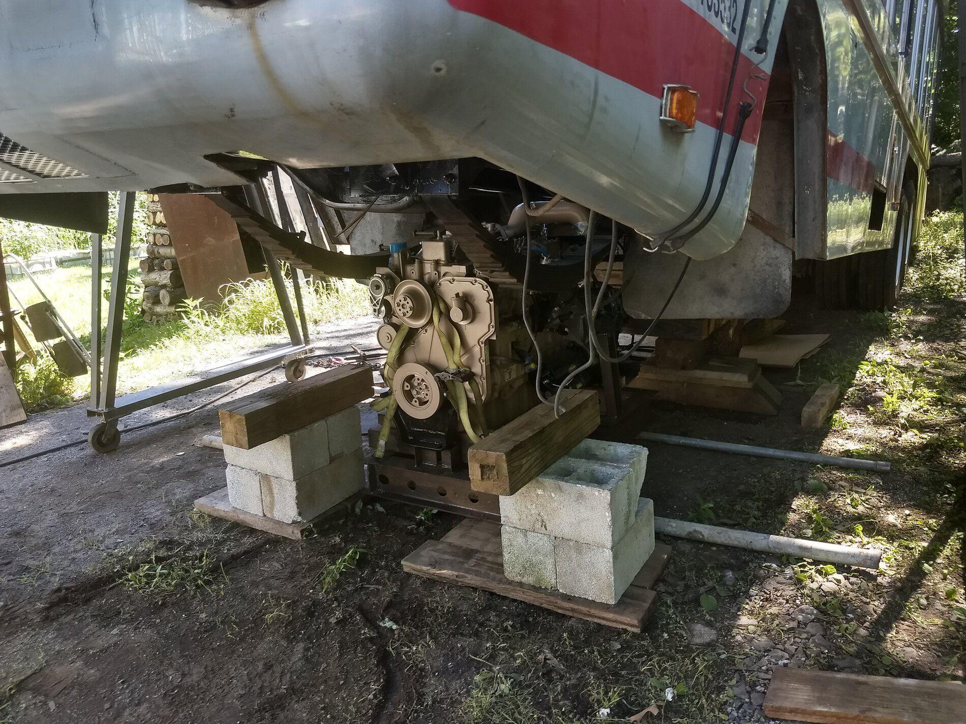

With the work on the frame done it was time to put the 8.3 in, with the size and weight of the engine and the way the bus is built the only possible way to get the engine in was to pull the front axle off, lift the front end up off the ground and slide the engine in under the bus drop the body back down onto it then use a host to pull the engine up into the bus.
