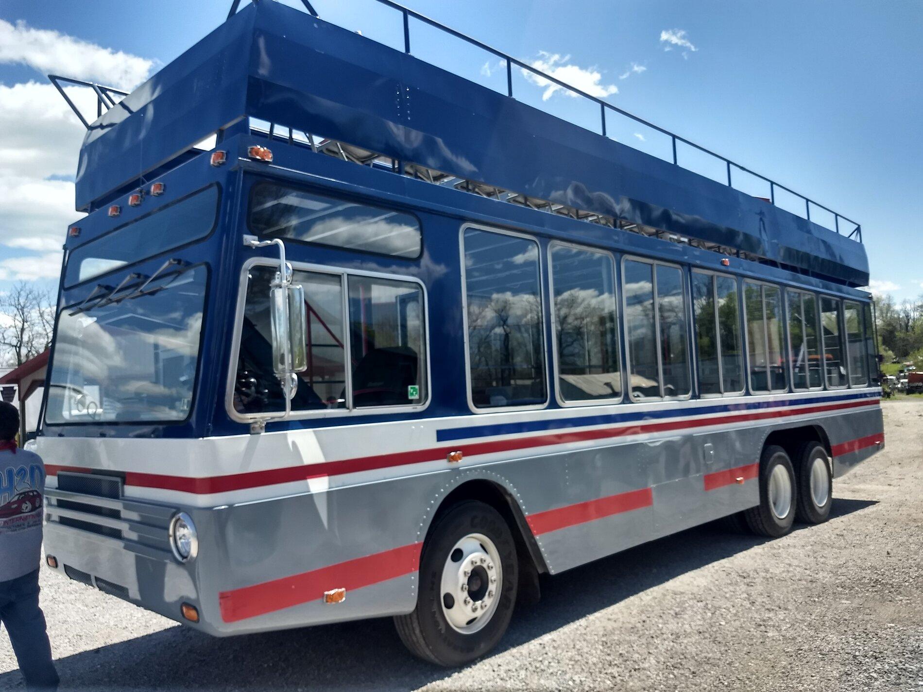

So with the winter down time, they got it off to the body shop for touch up work and fresh coat of paint, just needs to be relettered now
Wow! Great job.

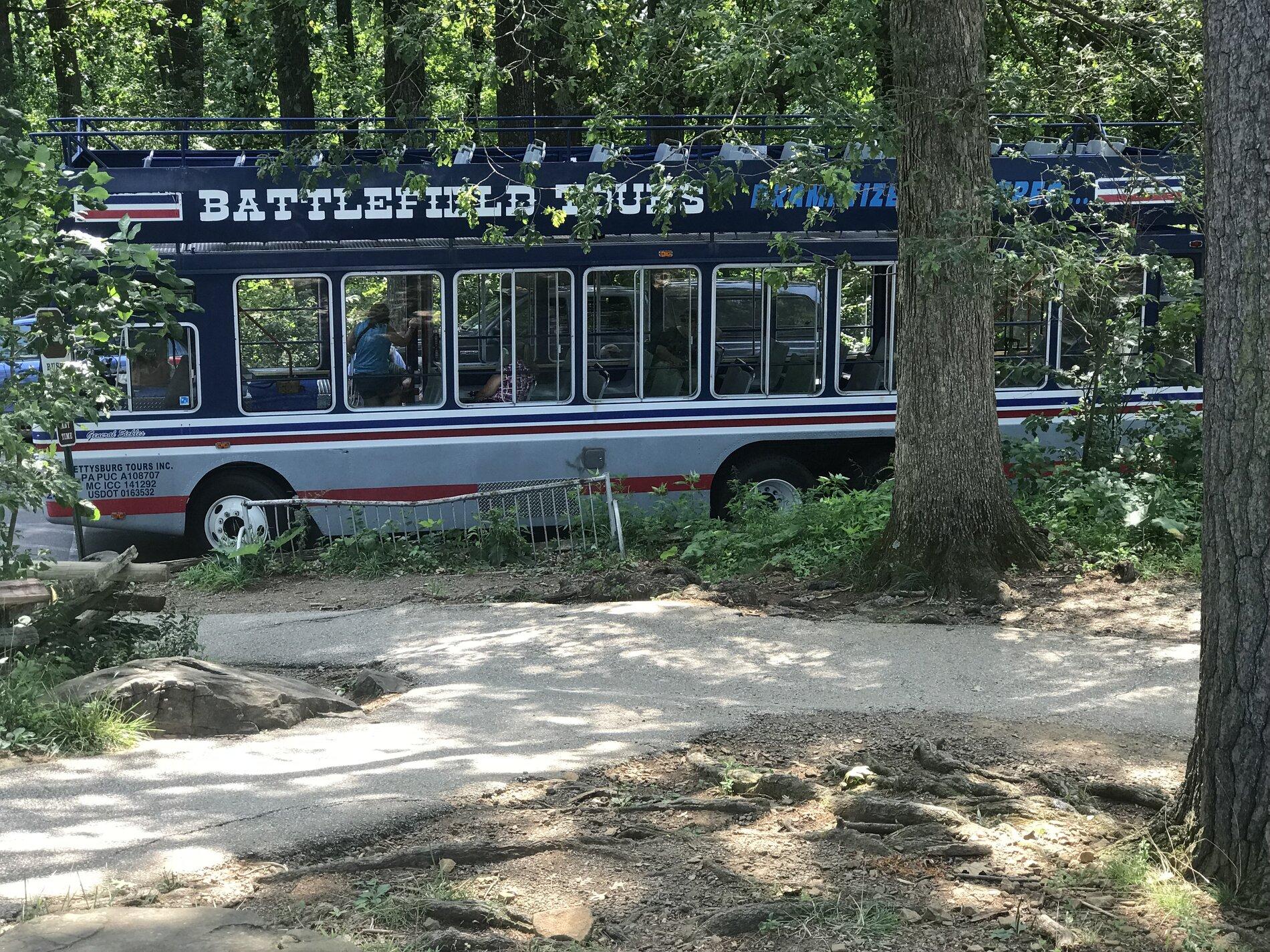

I completely forgot to come back to this thread and say that I saw it in person last July. Looked and sounded great!
