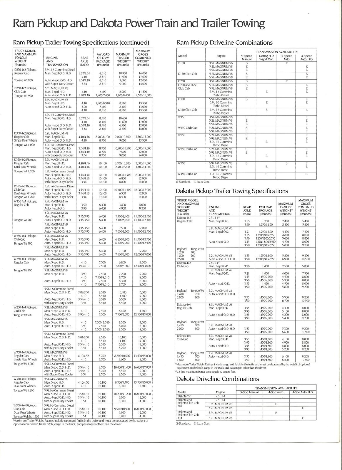

Good morning, Happy New Year. I’m doing some research for an axle swap and poking around on the ol interweb. I cant seem to locate the specific information I need. What gear ratios were available for the 89 model year SRW W350 trucks? Also, is it safe to say that the rear would be a D70 from the factory or could it have been a D60 as well? Thanks.
All the diesel powered D-250/W250, D-350 SRW/DRW and W-350 SRW/dually used D-70's. The '89 3spd auto used 3.07 gears, the manual used 3.54/4.10's. I have read that some manuals could be had with the 3.07 but never seen one. Good info here.
https://torqueking.com/category/1972-1993-dodge-100-350-truck-rear-axles/
While I've never heard of 3.07s behind a 5spd from factory, I have seen Dana 61F and Dana 71 housings geared to 3.55 from factory.
But the norm was 3spd 727 auto with 3.07s and 5spd with 3.55s (4.10s as a factory option).
