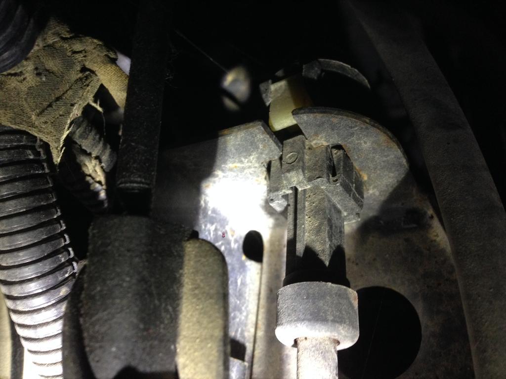

The transmission valve body works with whichever cable will fit it. The earlier cables were built differently than the later 97 and 98 models. But earlier models were updated by the dealer when worked on to use the later style cables, as they weren't prone to wear the metal fitting on the pump linkage like the earlier models. As for adjustment, I'd have to question your transmission shop, as all the12v diesels used an adjustable kick down, or down shift cable, from '89 to 98.... maybe they don't know how to adjust it? Or it's been modified before? Irregarless, they haven't seen very many if they can't recognize this. Perhaps the slack is a broken adjustment lever.... it's located beside and slight in front of the fuel filter, and on the '96, has a black or white lever to engage or disengage the lock from the cable, then allowing it to slide.... I'll go take a picture and post here in a minute.

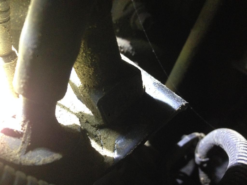

Your cable should look like this. Notice the white lever on the top. It should flip up, then the cable housing will slide back and forth, adjusting the cable. I'm concerned your shop doesn't understand that this should lock and be secured in the operating position..... Just my thought....
I faxed the info including the pic to the transmission place. Took some heat as the owner says his guys have been doing this for 19 years and they specialize in Dodge trannys. Regardless, I need to get a cable 96, so who has one and how do I get it. Once again thanks so much

The problem is that it may have been updated by a dealer to the newer style cable. There was a problem with the older style cables fraying, much like the original throttle cables 94-97... they'd fray/unravel a little, then stick in the liner and not move very easily, resulting in stuck cables. ON the throttle cable, it was a common problem, especially on automatic trucks, that took a little more pressure to move the throttle linkage as well as the kickdown cable..... I'd suggest posting a photo of it. It either looks like the picture I posted with the white lever, or it has a black push-button release like the one above listed on Fleabay. Get me a pic, and we can find you one. If it's like the later style, I may have one off a '98. There are also aftermarket parts available, such as:

I have my truck at home now so getting a pic will be hard as I'm old. I will try however. Yes, the transmission shop says they have contacted several Dodge dealers and were told that part is obsolete and generally can't be found. If I can get the correct cable (as they have told me) they will of course install it and test it. So as it stands right now, need a cable.

I included a photo of what the later model kickdown cable should look like. This is below the intercooler tube, on the side of your injection pump. The photo is tilted as my phone was. The throttle cable is on the top, and the black, square block is the adjustment button for the transmission cable.... this is the late style cable.
