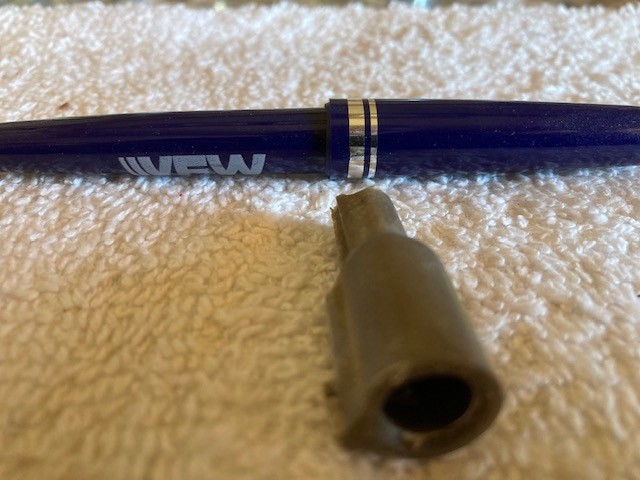

Today while driving I had the A/C on and suddenly there was a loud noise coming from the dash or engine. Shutting down the fan caused the noise to quit and after returning home I found that there was quite a bit of vibration when placing my hand on the bottom of the fan motor. Dropped the assembly and found a broken round piece of plastic in the blower cage. Ran the motor with it down and it was okay so I remounted the assembly and it's working. Although I have not cycled thru the other functions. The piece looks like a stabilizing bell shaped round grey plastic that might have been a mount for another part of the plenum.
It was amazing how noisy it was for such a small piece. I'm hoping the plenum is not beginning to destroy itself. This is on a 2004.5 Laramie. Have not had a previous problem with the blend doors but they are becoming more noisy or a bit sticky. Just an FYI for the forum.

Trying to post an image of the broken part.
Sorta does but the link pictures show an end part that has two steps to it. Mine is one step but might be just the OEM version. Right now I am still getting cold A/C thru the vents and I'm a little afraid to cycle thru the other functions. If it holds up I will wait until cooler weather...like November in CA.
Bad Plan! The system randomly "calibrates" itself (cycles thru the other functions) and could move the broken door out of the desired position. It could also just "flop" around being broken randomly changing hot/cold or modes on you. The next calibration could snap another weak from age door.

I can hope you are wrong and procrastination works. This is not a job I want to do although I long ago made a copy of the procedure to cut into the box and replace the doors. What I do not know is if the repair kit comes with those plastic door holders if that is what broke on mine. If they are replaceable with the kit then all is not lost. Right now I'm trouble shooting an Onan 4KW generator on a motor home I want to sell. Dang thing has a choke or throttle assembly that has been out of adjustment from the factory. Hard to get to just like the dash. I wish I could get some easy fixes!
I would avoid doing the cutting into the box repair. The dash removal is not that bad and there are several really good You-Tube videos and descriptions available. But I would wait for cooler weather for sure.
