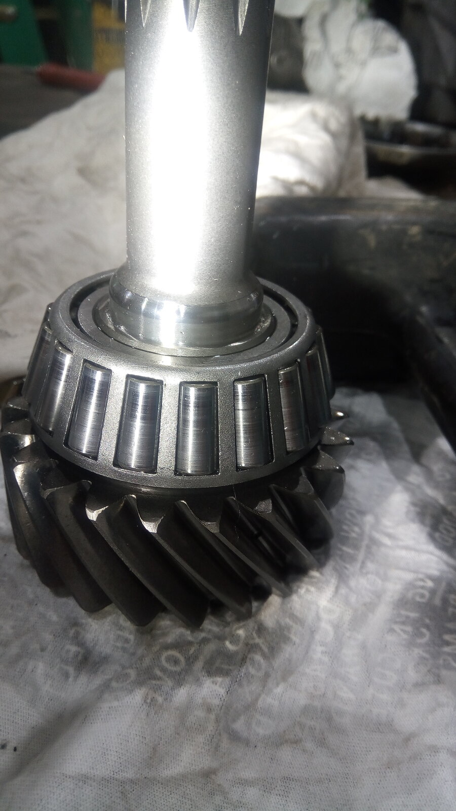

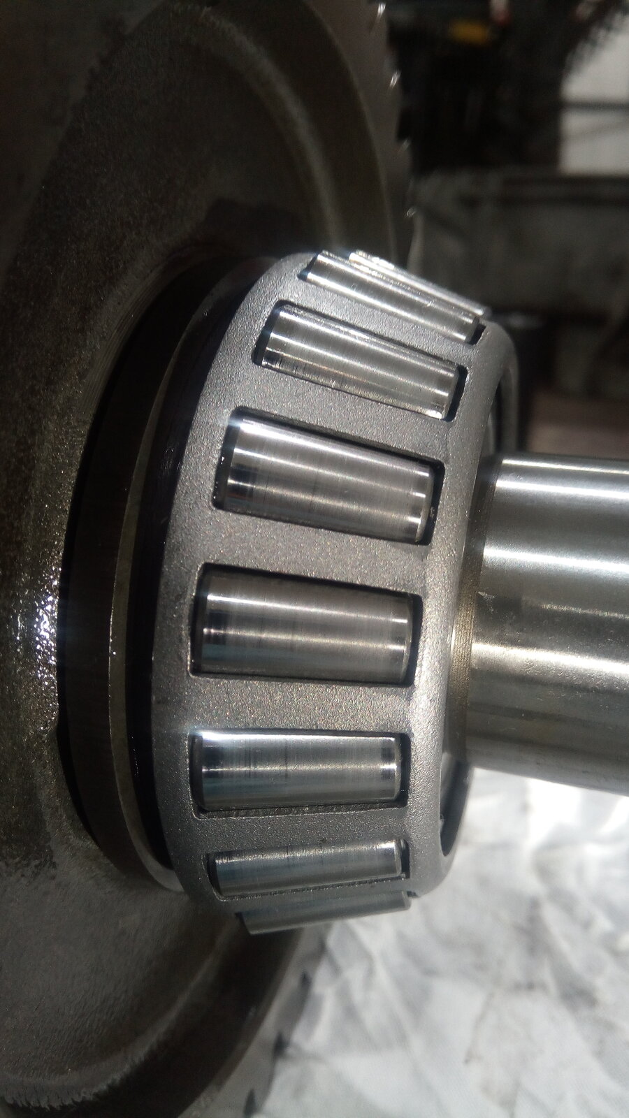

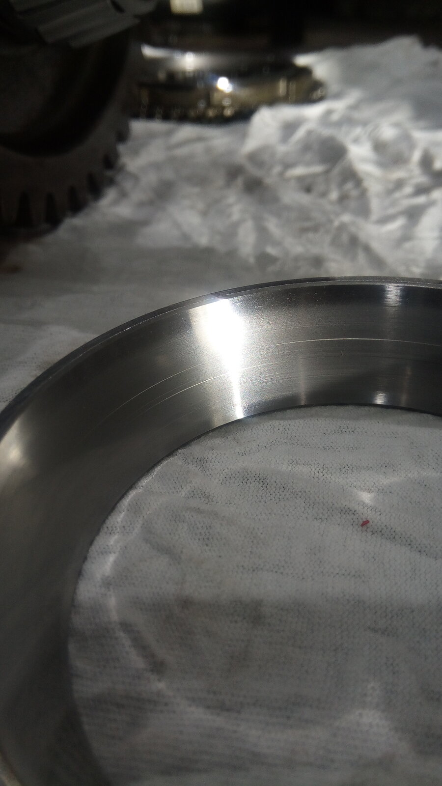

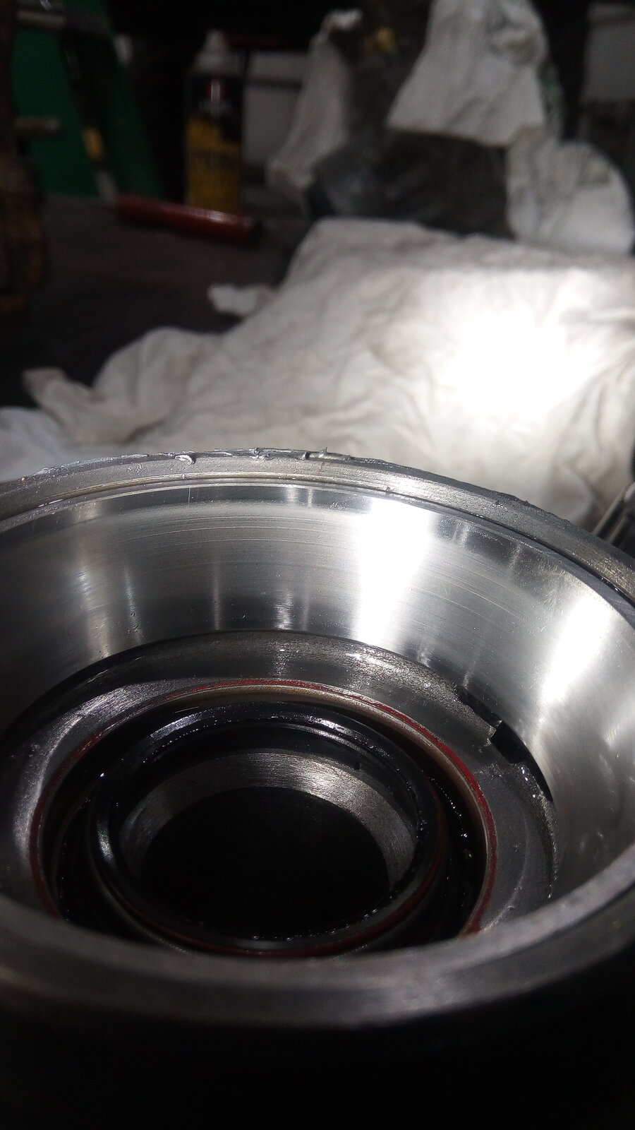

Got the trans tore apart and did not find a clear indication of a problem. All needle bearings and gears look PERFECT. The only thing I found is that all of the tapered roller bearings look scored. I've attached pictures of the input shaft and mainshaft bearings/races. This kind of scratching does not look like normal bearing wear to me and has to be the source of the metal. Everything else looks perfect. The transmission only has about 300km on it so this wear on the bearings and races looks kind of extreme to me. I cannot catch any of the scratches in the pictures with a finger nail, but they were brand new bearings 300km ago...
The countershaft looks about the same, but to a lesser degree. I rechecked the endplay with a dial indicator and it is about 3 thousandths. I also checked the pilot bearing in the flywheel and all seems well. I have no idea what else to check as everything looks perfect except the tapered roller bearings, and I have no idea what is causing them to fail.
Any ideas are welcome.

Contaminated oil will scar bearings like that . As far as the noise do the gears have any scoring or marking like the bearings had. I like to set the end play at 1 or 2 thousandths they are more noisy the more endplay you have
