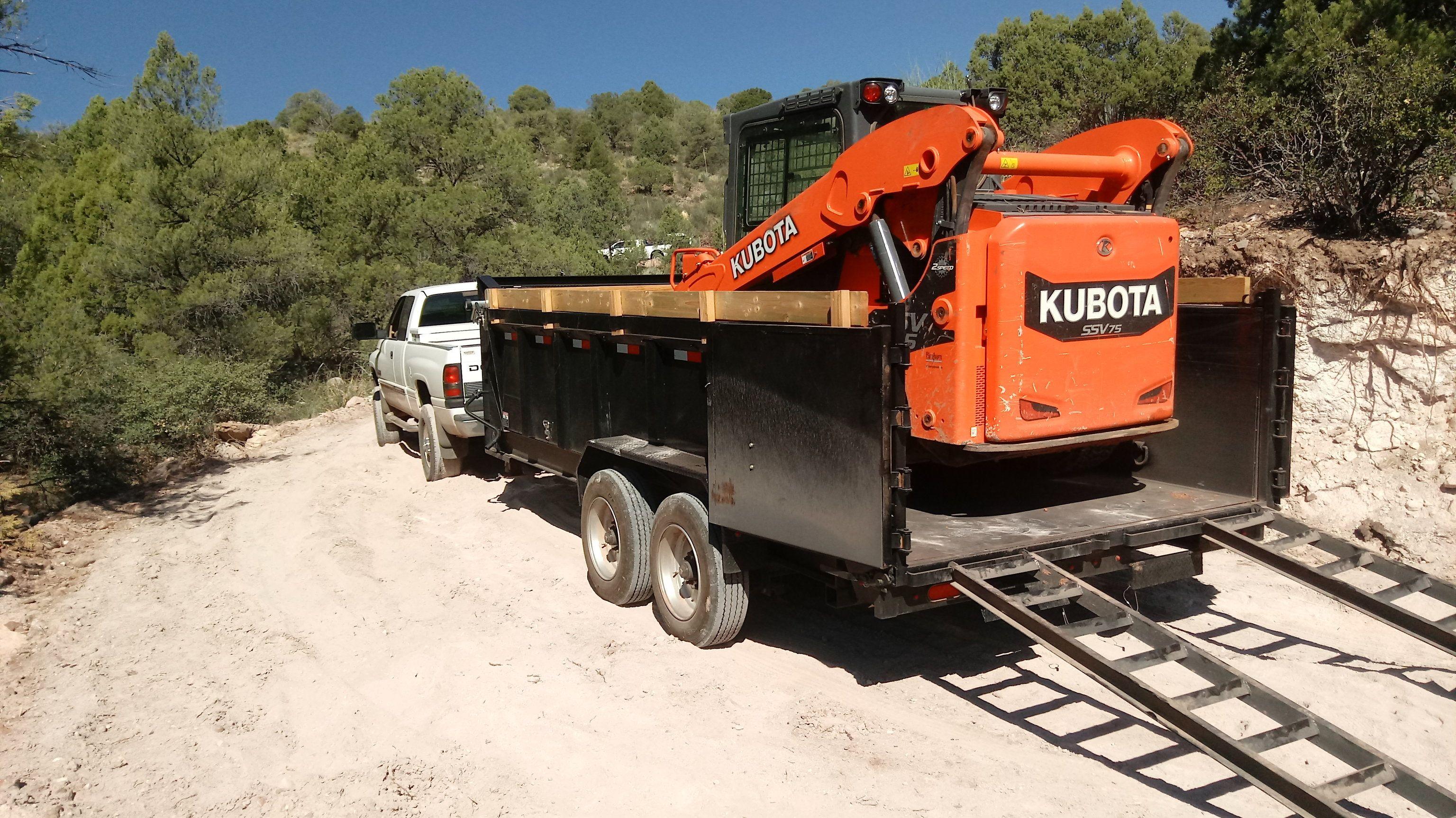

Where I live, I need an exhaust brake, every where I go is uphill or down. A lot of off highway, I use 4x4 on dry ground almost weekly, so Yes, my tires don't last at all.
My '01 Dodge 6spd in 4th gear, exhaust brake on, cruising off a 7% grade hauling a Kubota skid steer, about 23.500 lbs GCW.
Unloading the skid steer because even in 4x4 I can't pull the hill.....
I use my EB all the time. Unloaded or loaded... My brakes last forever too.
