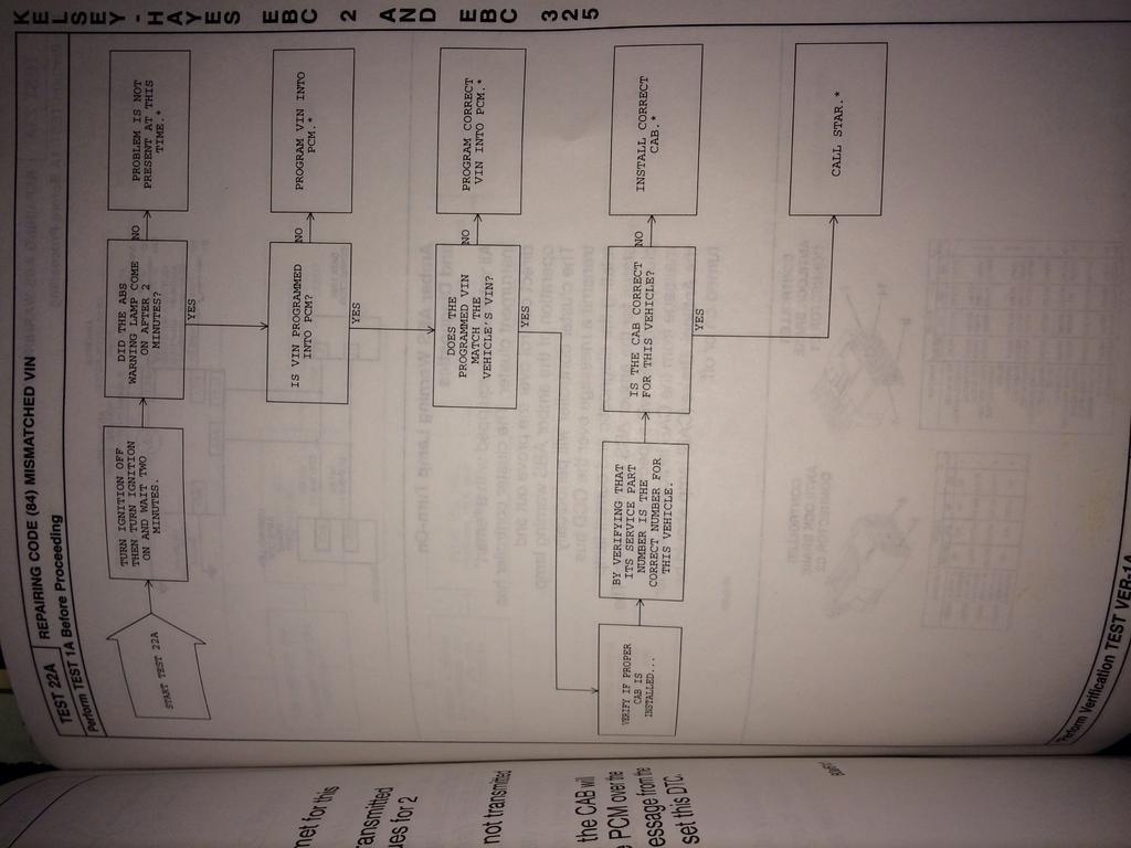

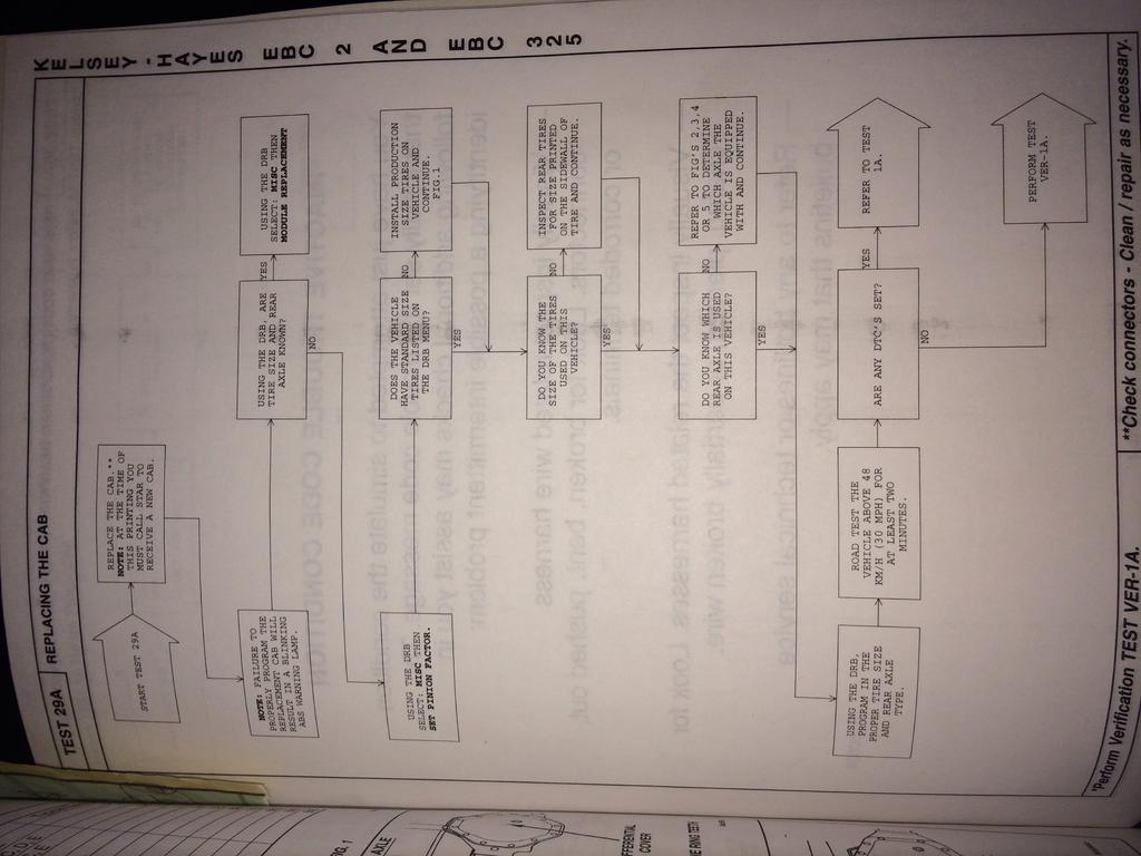

I have the '98 KH ABS manual for both systems. I don't think there has been a change until witech after '06. I will try to look ASAP.
Ozy, here is the flow chart to diagnose code84/ mismatched VIN. I hope it applies to the 04. I looked at the first test, but to get to first base, you gotta have the DRB. I'm also posting the CAB (Controller Antilock Brake) unit chart which goes over programming. Show this to the dealer. Good luck!
