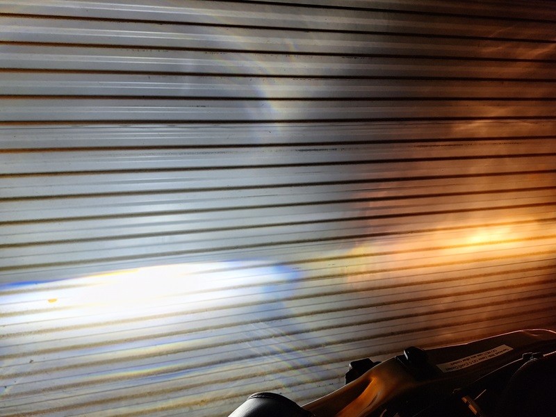

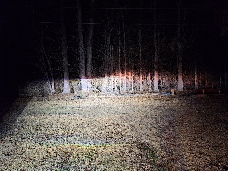

Pics, shop door open, shining on trees 75 ft away, new vs old headlight. The tool is a ratcheting bit holder with a square drive, and a 4mm socket on it. lights shining on the door with ribs on it makes it easy to adjust the headlights up or down in small amounts and keep them even.

initial comparison of new left and old right headlight.jpg four mm socket and bit holder for headlight adjstment.jpginside of door make it easy to see the lights move when adjusting them.jpg

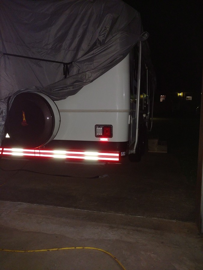

Being visible........... I added DOT reflective tape to the back of my travel trailer. The typical 4x4 thin steel tube bumper has an extruded aluminum trim cover on it, a vinyl strip down the middle and no slip ribs on top. There are two smooth one inch wide strips on it, so I bought one inch DOT tape and applied it all the way across, so that red was outermost.
When I installed the white LED backup light in the place of the original that had red prismatic reflector surrounding the white lens, I also added plastic reflector strips under the lights. I have longer ones I plan to install eventually.

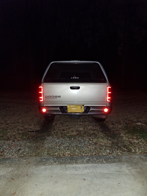

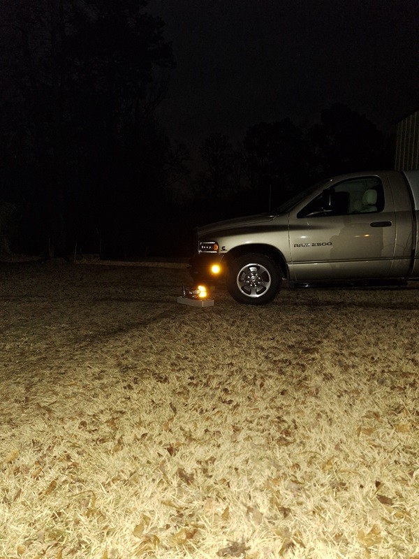

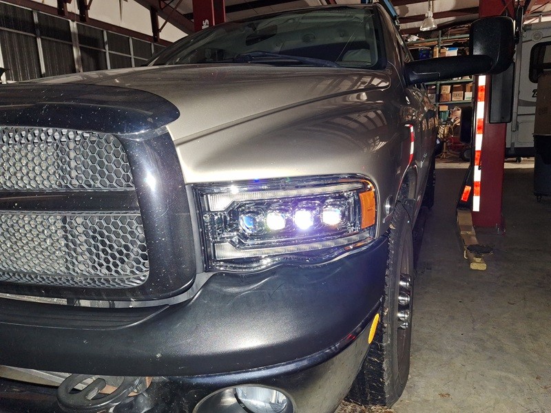

Adding a few pics here. The truck is outside in the dark, possibly a little light coming from behind thru the shop door. I took the original Daimler Chrysler headlight and set it below the truck at the appropriate angle. You can see that it, and the Grote reflective dot on the bumper reflect the flash fine, the reflector in the NOVA light does nothing, and its the same with a bright flashlight on it.
Disappointing to pay a grand for lights, and have something as simple as a prismatic reflector not work. How does one mess that up.
I also did one of the rear, to show how well the OEM taillights reflect and also the red Grote reflector dot.
One shot of it installed, you can get better images on the website. The light is off, the three low beams are merely reflecting the camera light.

front side reflectors RAM.jpg rear reflectors on RAM.jpg front light assembly RAM.jpg

I looked at the web site and found this......... We design our lights from inception, patent every component we’ve designed, and guarantee that our products are compliant with the SAE and DOT requirements. Our products are also certified to ISO-9000, ISO-9001 and ISO-9002 standards.
I sent an email to them and finally received a response. About the reflector they claim that that is an amber LENS and not intended to be a reflector.......... not what I was expecting but I had sent them the pic I posted of the nighttime pic of the OEM light on the ground reflecting away and the Grote reflector on the bumper also reflecting away and the non reflecting "amber lens" . I'm not real worried about it, possibly they will improve them eventually. I did mention that even my 1970 Mustang had sidelights with reflectors that worked.

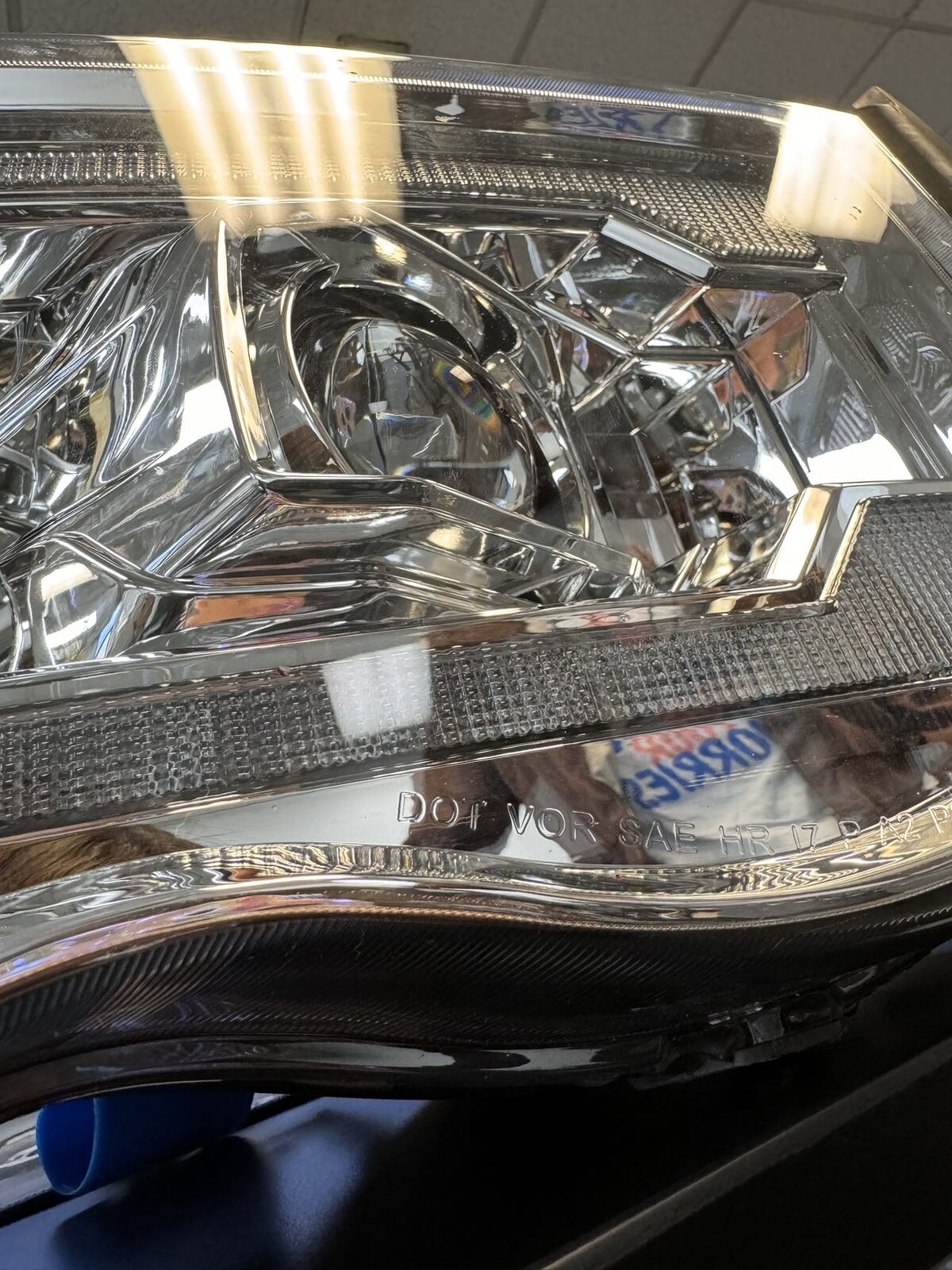

As for the DOT certification, they did send me a pic of where that is found on the light, which I will post here. Its right along the bottom in the inboard curved section, I refer to these lights as the "sad eye lights". Mine are difficult to see but the markings are there.
As to the terminals on the wires for the DRL module not being large enough for the battery clamp bolts, they said that it was a module used on many of their kits and battery bolt sizes vary. This is no wholly true as they do customize the fuse box tap for this installation, so they could customize the terminals for the battery also. I did suggest they provide larger terminals for the installer to use since they were aware that the ones on the wires were not large enough for all installations.
All in all I'm quite happy with the lights, just disappointed by some small details that should have been ironed out a long time ago.
