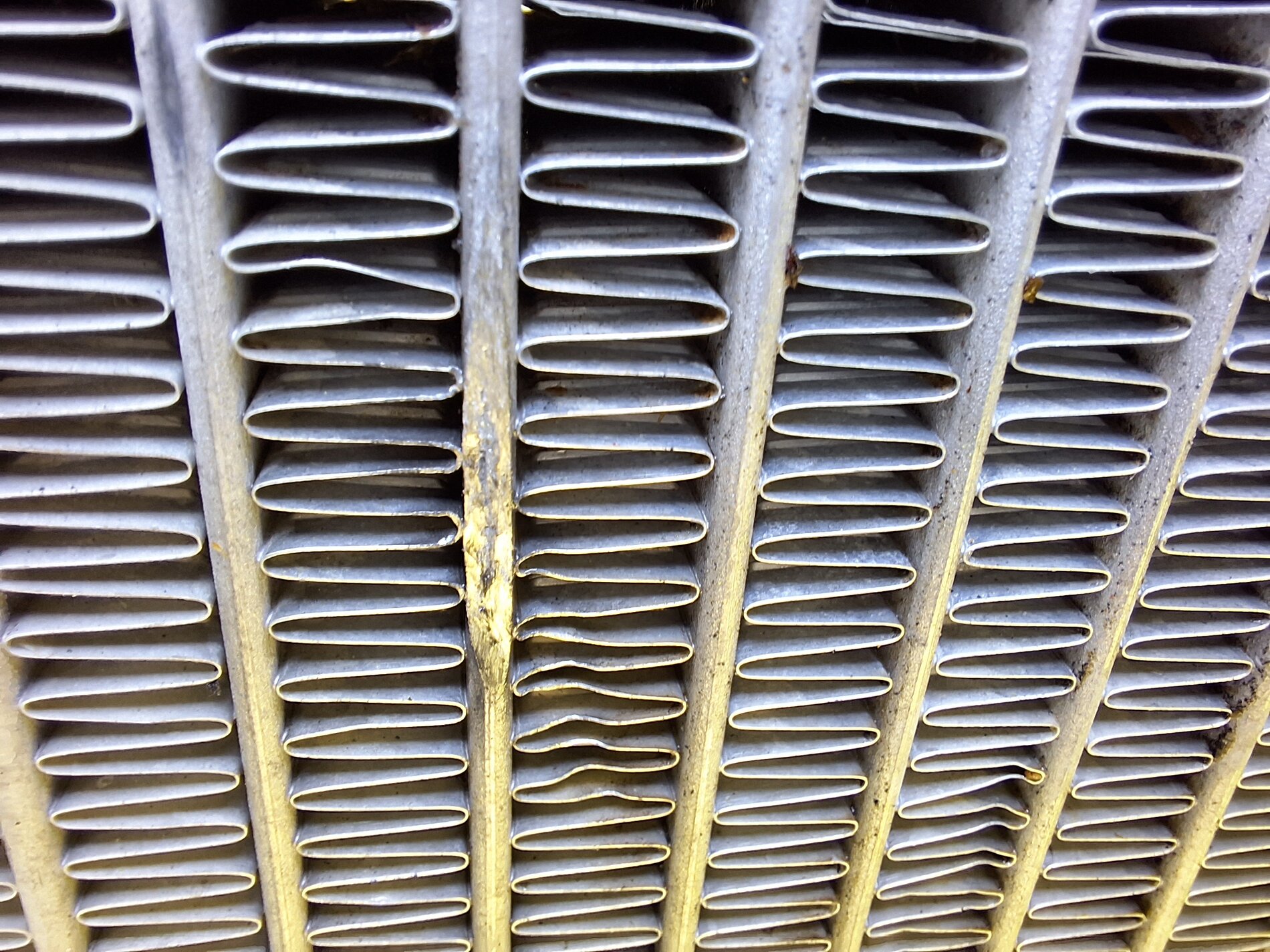

Radiator leaked because the shroud was rubbing one of the tubes. With the new thinner core this is a non issue as there is 3/16 or so clearance now. The '03 and early '04 shroud is unique as it blocks off the lower part of the radiator. Everything went together nicely and the fan wires installed properly in the recesses of the shroud and the lower section fit in place nicely locking it in place. Plastic push pins were new last time and still were difficult to push in so I reused them, though I may go back and change them for good measure.

If you have an '03 or early '04 with the original radiator, you will need to check the radiator and shroud for interference and fretting. This is the point where the fan wires exit the gutter in the shroud. You will probably need to remove the lower section, easy, just pull the two fir tree pins and slide it up and out, while laying underneath. Use a mirror to examine the area. Sorry the top pic is sideways. I sanded the area down and then realized that the new radiator core was not going to be close to it. It took 20 years and 116K to fret thru, but you don't want to be buying a radiator for something that stupid.

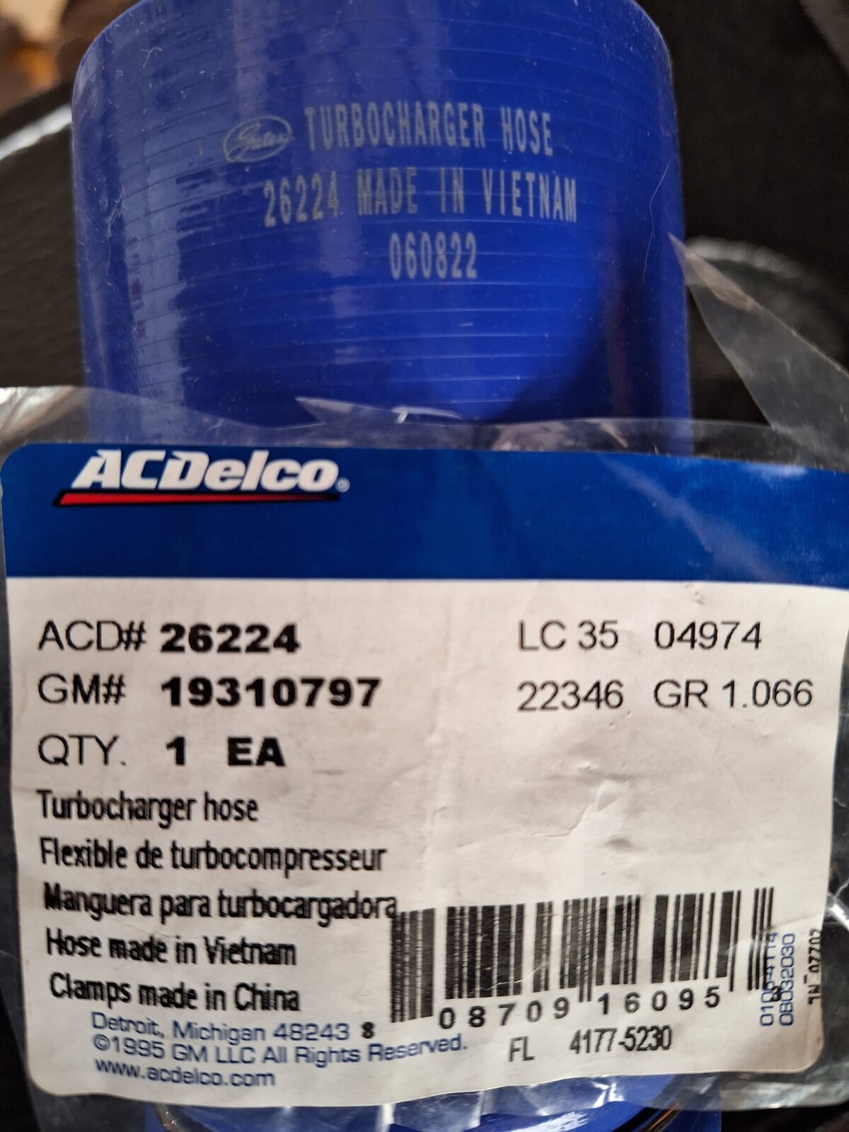

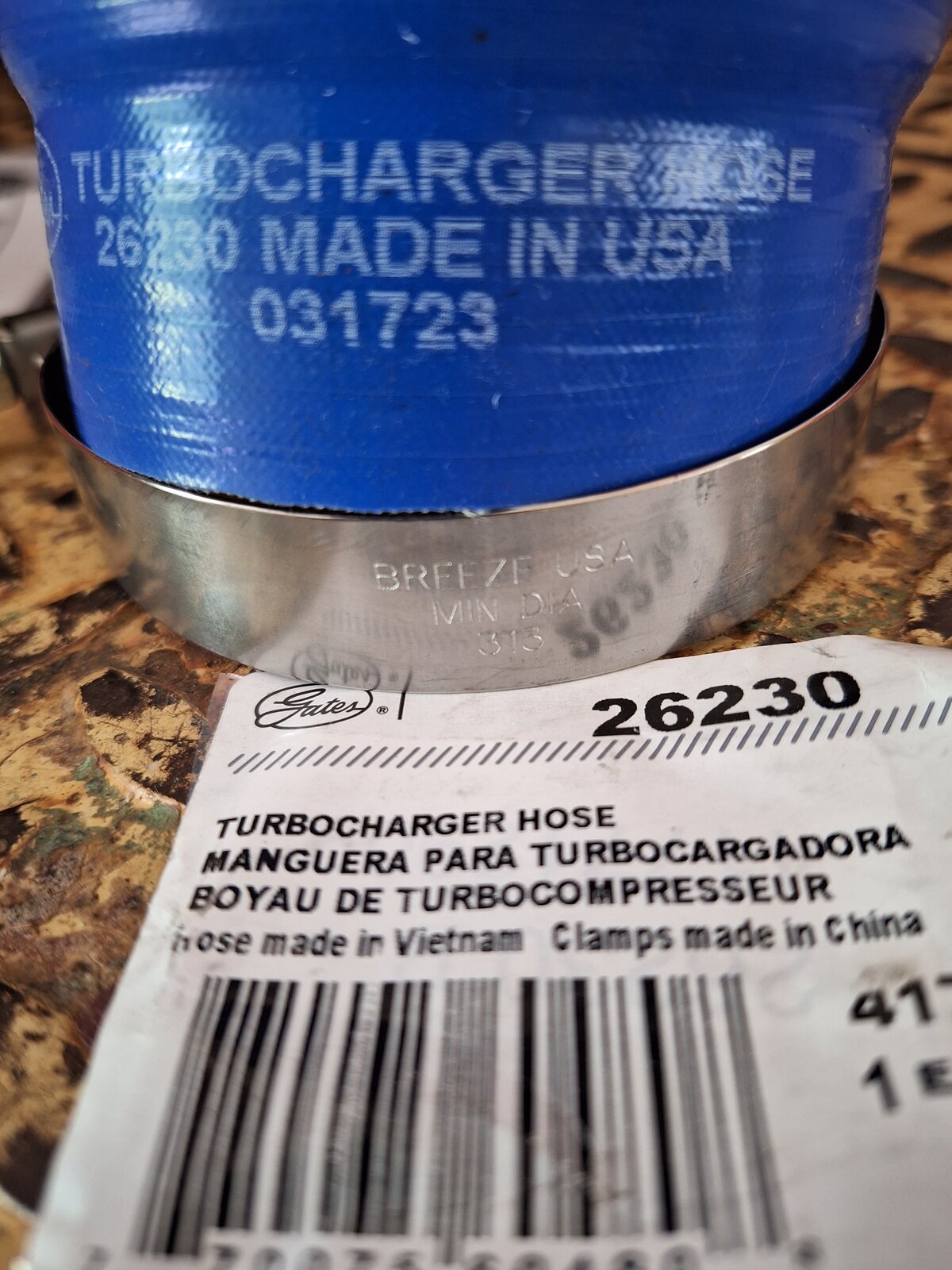

While assembling the new boots to the turbo hoses, I noticed something interesting (see the attachment).
Left side is completely reassembled except for the upper radiator hose, which hopefully arrives tomorrow. Left side is waiting on the radiator hose and when that is done, I can reinstall the turbo pipe and the air filter box and system, hook up the battery, fill the system and get it running. See the attachments for something I noticed about the turbo to pipe hose also.
