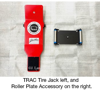

The TRAC Tire Jack with Roller Plate Accessory caught my eye in the New Product Showcase at the 2023 SEMA Show, and in my TDR123 coverage I mentioned that I’d like to evaluate one. The manufacturer obliged, and here we are just one issue later.
Gaither Tool Company was founded in 1988. I had seen their display at the SEMA Show for years, and I knew that my friend and fellow TDR writer Moses Ludel uses their products, but this was the first time I gave them more than a passing glance. Gaither is focused on the tire and trucking industry and I am a guy who plays with tires more than most writers or enthusiasts. Receiving the TRAC and Roller Plate Accessory in early 2024 was perfect timing, as I both purchased a new set of tires and was supplied a set by a manufacturer for long-term reviews.
Packaging And Instructions

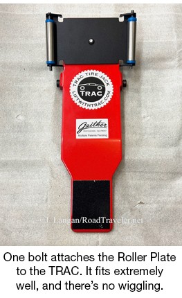

The TRAC and Roller Plate were packed well with the box taped and stapled, with straps around the circumference. A double-sided sheet of paper explained the TRAC’s usefulnesses on one side (but not specifically how to use it), with a replacement parts list on the other. Nothing was included about how to attach the Roller Plate, possibly because it was just introduced. There is just one bolt to secure the Roller Plate to the TRAC, but I admit doing it incorrectly the first time before referring to my photographs from the SEMA Show. One 3/16 hex bit is all that's required to marry the two pieces.
The QR code on the bottom of the TRAC took me to a 15-second video showing it in use. There's really no need for lengthly instructions, and watching videos of the TRAC being used is easier than reading how to operate the tool. Something that did not sink in after watching this brief video the first time was that the TRAC and Roller Plate work better if not stuffed completely under the tire. Like anything new there is a bit of a learning curve, but below are my initial impressions while actively using the TRAC.

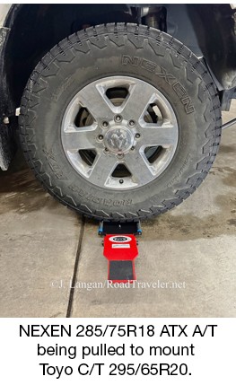

My first use involved removing a set of worn LT285/75R18 and replacing them with bigger, LT295/65R20. My axle needed to be a bit higher than usual to slide the Roller Plate under a tire before lifting with the TRAC. After pushing down on the end of the jack closest to me, it lifted the 100-pound tire and wheel off the studs, and was easily rolled away from the chassis over the smooth concrete shop floor. Some strength was needed to leverage the heavy tire and wheel off the axle, but using the TRAC shouldn’t be a problem for reasonably strong folks who do their own work.
Before the TRAC, historically I've used two methods to remove and replace wheels. Sometimes I will lean over and grab the wheel spokes from above and lift it off the studs and pull it away from the axle. However, usually I sit on the floor and use the inside of my lower legs to lift the tire at 4-and-7 o'clock, then pull it to me. This is almost always the method I use to put them back onto an axle. Sometimes I use jack stands to support the axle(s) during a rotation, but not always. Even though I am not completely crawling under the truck, my feet and part of my legs certainly are vulnerable. The TRAC adds a measure of safety, allowing one to kneel in front of a wheel and keep extremities outside the fenders.

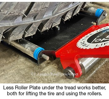

What I discovered with a bit of experimentation was that leaning the top of the tire away from myself, then feeding about half of the Roller Plate under the tread facilitated more maneuverability while still providing enough leverage for lifting.
TRAC Without Roller Plate?
Before doing the second at the left-front, I decided to try the TRAC solo and removed the Roller Plate. Removing the rim was easy, everything was lined-up. When I tried to remount a wheel to the axle I was not lined-up with the studs, and there was really no way to make it right without pulling the wheel back out and manhandling the tire on the TRAC.

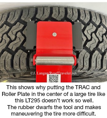

Even with my lack of experience using the TRAC, it was obvious that using the Roller Plate with the TRAC is preferred, and with practice my technique would get better. I put the plate back on. It was after the second installation of the Roller Plate that I realized that placing too much of the tread on the rollers made the tire more difficult to spin, which was a bit counterintuitive.

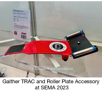

The new Gaither TRAC Roller Accessory Plate is an innovative and handy device. Good enough for Gaither to win runner up in the tools and equipment product category at the 2023 SEMA Show.
