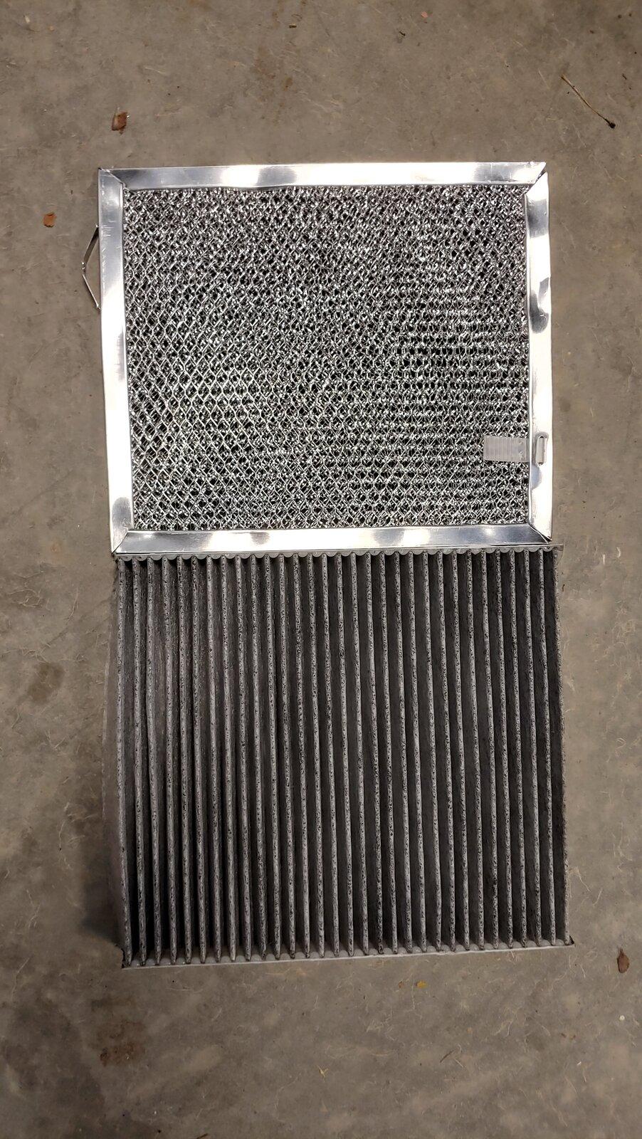

I just have to add my experience with installing the filter kit in my mega cab. Disclaimer, the mega cabs seem to have pretty poor air flow to start but after adding the filter it just restricted the flow way too much for me to live with in the Georgia heat. I had to run the fan on high just to feel any air moving and even then it wasn't much. And no nothing is clogged, this is my second mega cab and they have both had sub standard air flow from the day I drove them off the lot.
I ended up pulling it out and made my own, less restrictive filter out of a stove top vent filter. Obviously it will not stop all the fine dust that the factory filter will but it was a compromise for me to keep a little air flow.
