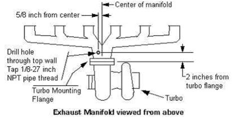

Maybe this will help with the location, if you haven't already seen it.
Common rail manifold is a little different as the turbo is farther back than that diagram, I did the same with a vacuum and grease method, put the probe on the top side of the manifold right after # 3 dumps in, then you get temps from all 3, as it is a little weird how 3 and 4 dump into the turbo with the turbo mounted directly under #4 rather than in the center like the gen 2 trucks... JM2C.
I went in where 5&6 meet 4 as they run hotter then the front 3 , dont know how much it really matters overall.
Truck is an 04.5. Does that make a difference. I’ve seen some photos on people putting the probe in the elbow that comes off the turbine housing. Bad spot?
Because of the pressure drop across the turbine drive wheel, you will see about 100°F to 400°F temperature drop (depending on engine load) from the temperature in the exhaust manifold before the drive wheel. That's why most people place the temperature probe in the exhaust manifold.
