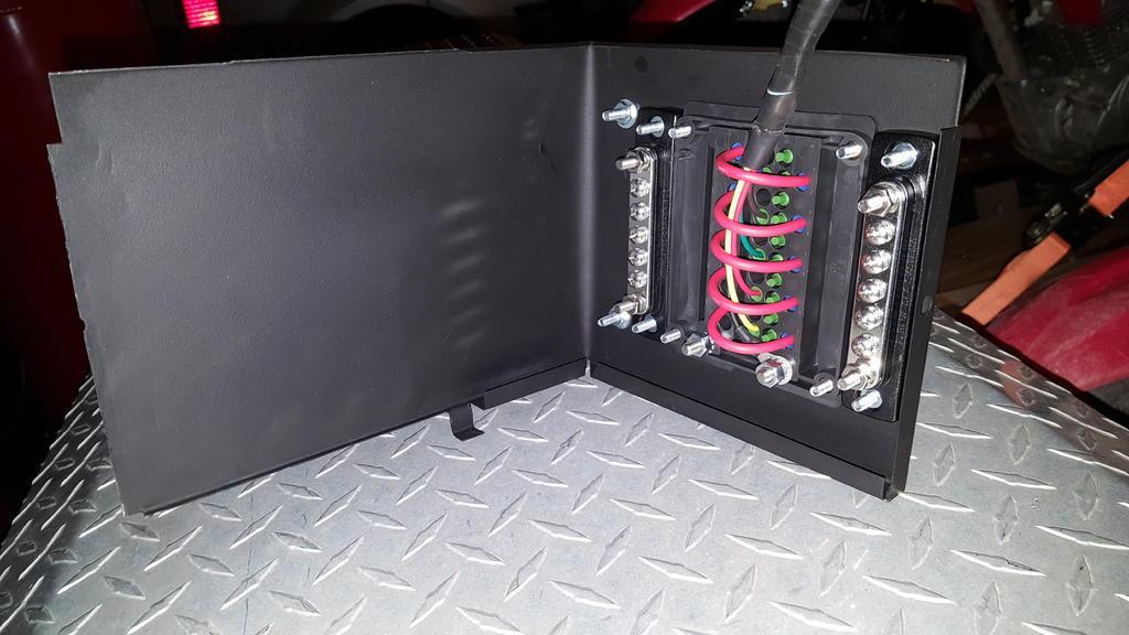

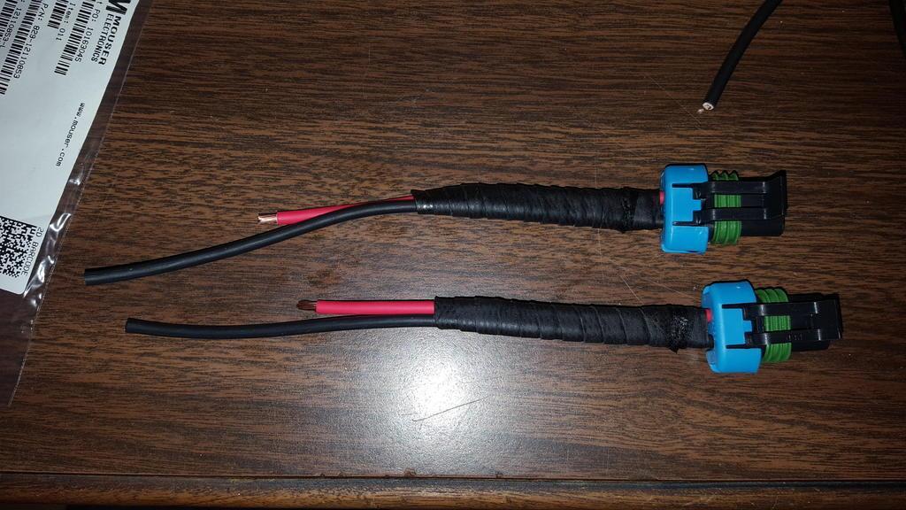

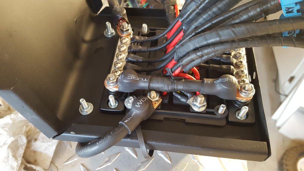

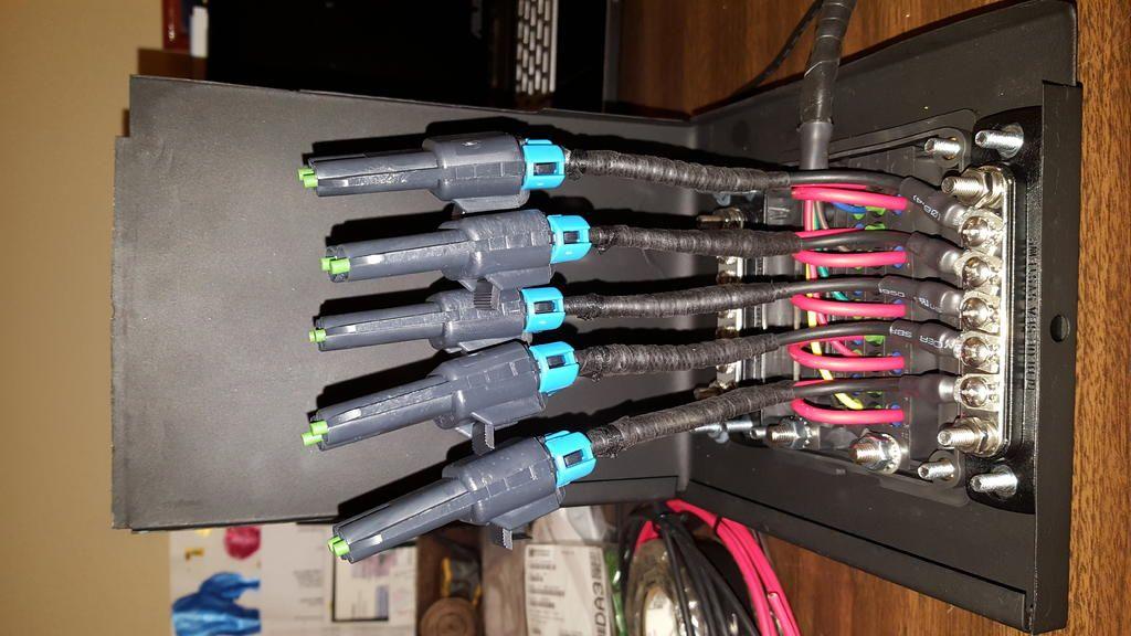

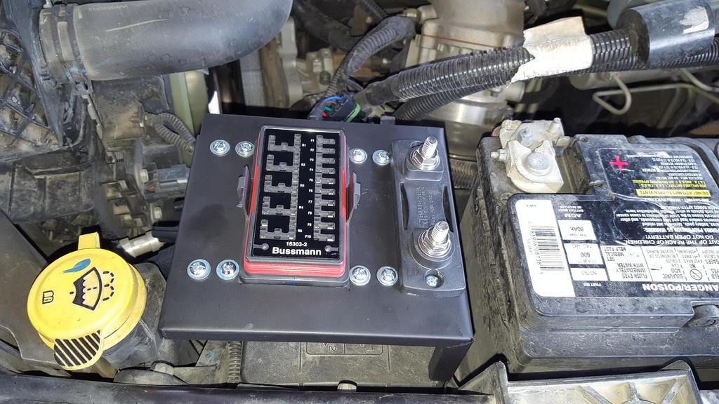

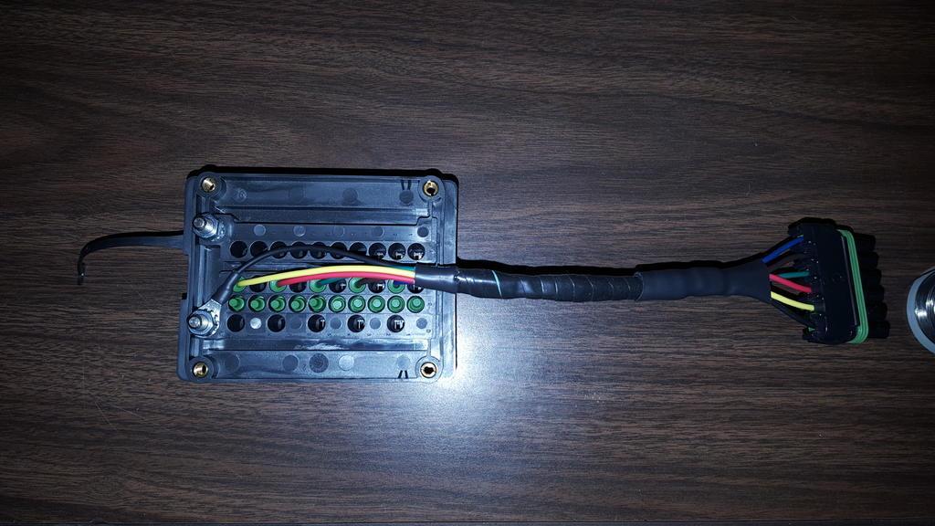

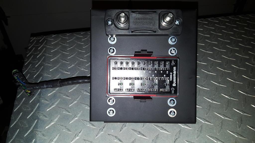

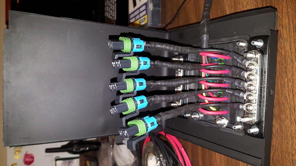

What year of truck are you talking about? If I recall, the 2013 or 2014+ is more tightly integrated into the truck's electronics. So this is only applicable to 2010-2012 trucks, which uses a separate Auxiliary Power Distribution Center. I added the factory auxiliary switch bank to my truck earlier this year. You can get the factory box (68049500AB), which is a bit on the pricey side, unless you can find one from a wrecked chassis cab or you will need to build the relay/fuse box.
Here are some pictures

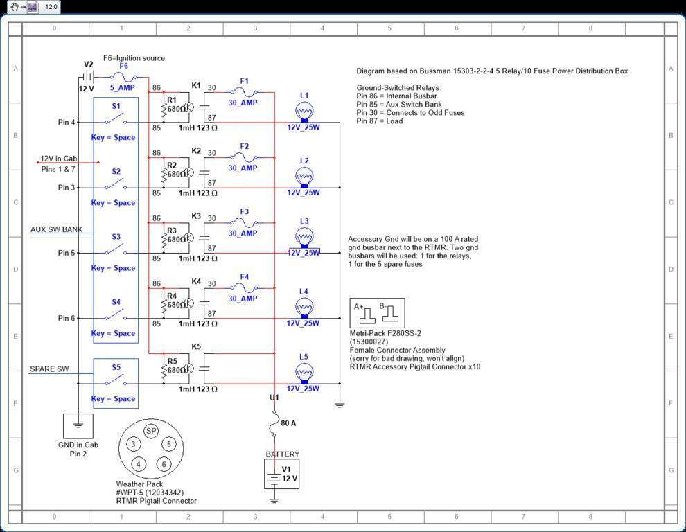

Here is a schematic I created that shows how the relays, fuses, and wiring are connected:
The only change from this was that I ended up using a 6 pin connector to run a fifth switch to the center blank of the switch bank.

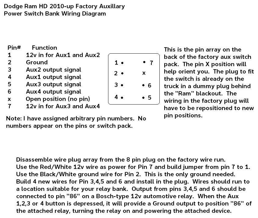

Here is the pinout for the back of the switch bank:
If I were to redo this project, I would reconfigure this to mount it on the firewall right above where the ABS module is at and redo the pigtails so they are panel mounted. I think the factory relay box is mounted close to the same area.

I hope this helps you some. I spent quite a bit of time researching this before I pulled the plug. Then the build itself took me even longer. But I am happy with the end result. If you tackle this, I would encourage you to find a more suitable place than where I placed it on my truck.
