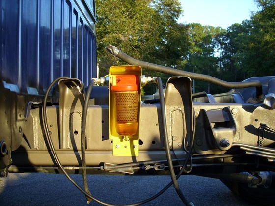

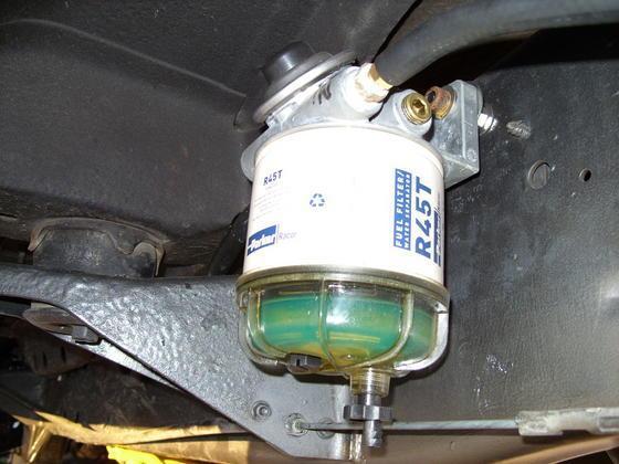

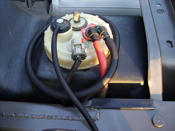

Absolutely, You'd be suprised at how many DODGE mechanics over the years didn"t know about the pre-filter when I took it to the dealer, when I was on the road cause I was too lazy to change the the filter !!!! Anyway, I got tired of messin' with it so I installed a 5 mic racor filter before the pre- filter, deleted the in-tank fuel filter, and picked up a little MPG, but I still have to change out injectors as I suspect leaking to really tell, I'll see if I can attach the picures w/ this reply
The big filter is pre-tank fitler from my in-bed auxillary tank

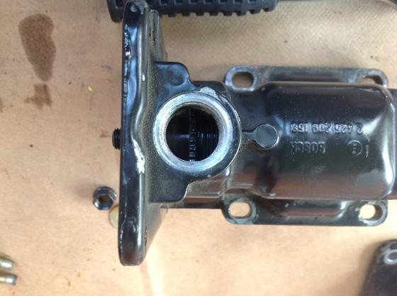

Well finally took the afc off today to put the star wheel back in the window under the plug. The star wheel was all the way against the back ( screwed all the way in). Also discovered I have a #6 tst plate not an eight.
