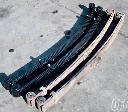

By rating these are the same spring. Guess which rides better (DEAVER, etc; custom).

I would say those newer leafs would ride better. But that’s not the MorRyde rubber shackle. Are those pictures leaf’s from MorRyde? The rubber shackles look interesting. I’ll have to Google and read for testimonials.

The Deaver leafs are not made for Rams by there website. The MoRyde RS looks interesting. But if it’s set up to carry the heavier load, not sure how effective it would be unloaded. As it’s kind of the same concept and set up as the kelderman air ride. As they both have the rear of the leaf mount to either system. The air ride is adjustable and A LOT heavier but at 4 times the cost it should be.

DEAVER and others can build from spec. 5,6,7 leaves is better than 2,3 for ride.
