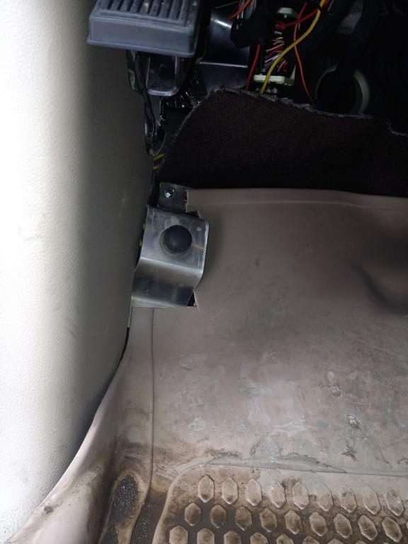

For the purpose that you are intending it for, put a foot switch on the floor where the high beam switches used to be so that it's easy to hit while driving without using your hands. Sometimes I have my foot right beside it ready to hit if I'm in traffic where it might be needed.

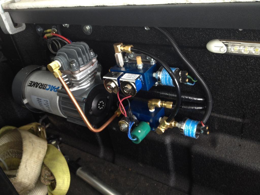

In my case I have a dually and I had the room to put a 5 gal. tank ahead of the rear wheels up into the fender. You should have room for a 2.5 gal tank in that area. If you do it run an air line into the box with a chuck on it so you can fill up tires etc. when needed.
I have an aluminum cover that covers the compressor but it's open on the underside for air flow. the controls are for my air bags. This is mounted on the front passenger side box wall.
This is overkill for what you are looking for, but just Ideas. I don't have any pictures of the tanks and horns on the underside for you.
