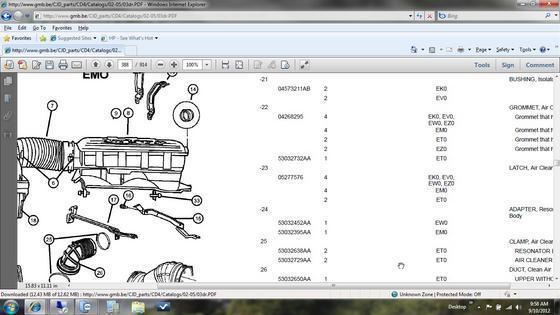

I think that you want 04268295. I can see how it was missed using the year of your truck. It is not illustrated.

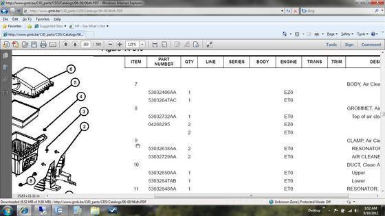

However using an '06 truck they do show up. I cheat..... :D
Blow the screen up to 150% and you can read it.
We'll see what Bob comes up with for a number today.
Pre 2006
2006 and up
Mike. :)
