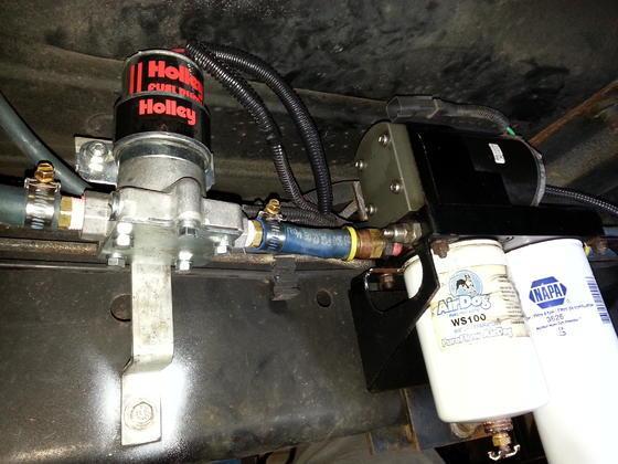

Update: Josh from AD called me this morning and i missed his call. I've been trying to get him all day and he has been on the phone all day so i left him another message. Hopefully this time i won't miss his call. On another note my buddy has a brand new in the box holley black electric fuel pump. It flows 120 gph at 9 psi and is adjustable to 14 psi. I did some research and found a bunch of guys using these pumps on their duramaxes. One guy inparticular has a holley blue on his truck for 5 years now and his wife's truck a holley black supporting 600 rwh for two years now with no issues. It does not say anywhere that this pump is compatable with diesel fuel but gasoline, alcohol, methanol. He is drooping it off to me in a little while and i'm going to install it tomorrow morning. He's charging me $25 for it and i checked the price on Summit it is $167. Kind of a sweet deal to pass up. I will report back once installed. Thanks and please let me know if you had any experience with this type of pump on your truck or someone you know.
I ran a holley blue pump for a booster pump on my 2001 cummins, worked great, i use it now to pump diesel fuel out of my aux. tank into the reg. tank, Monte
Ok this is what i did for now and it seems to be working great so far. This pump is a 14psi preset pump and my gauge is showing 13. 5 psi. I did a permanent mount so that i could leave it in once i replace the AD motor and switch to it in case i have a problem again with the AD pump. Not much luck with Air Dog, it seems like i don't have a warranty since i didn't turn in my paperwork. Kind of foolish of me so i think i will be stuck paying the full price for the motor. I beleive its somewhere around $150. Anyway i left Josh a message with the serial number and haven't herd back yet. If i don't hear from them by tuesday i'm going to call and order the pump on my own. this setup seems to be working fine i'm tempted to leave it for a while i just don't trust the holley pump too much. I've had many problems with them in the past and i switched over to mallory and aeromotive on my race car, but i just couldn't pass up this deal for $25. Thanks for the replies
Yes i wired it into the AD plug this way it utilizes the relay and fuse on the AD wiring harness and pump turns on with ignition on.
One thing i forgot, when i first hooked it up the Holley pump sounded like it was pulsating. So i opened the plate with the four alen bolts on the back of the motor and removed the internals and now the Holley is just steadily buzzing. I guess it was restricted a bit by the AD.
Yea its pretty good but honestly if you were to do this for some reason i would stay away from the china made holley pumps. The pump i'm using is preset to 14psi. I'm getting 14psi cruising and idle, and at WOT it goes down to 11psi. My AD pump used to go down 1 psi at WOT. I'm happy with it as a temp. set up and in case of emergency but like i said don't get a holley pump if you're going to do something similar. I've had bad experiences with them leaking on me and their priced the same as some of the better pumps. I like Carter, Walbro, Aeromotive and Mallory.
