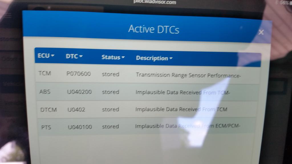

Got truck back yesterday from dealer and all seems to be fixed.
The cause was a failed transmission range sensor which they replaced.

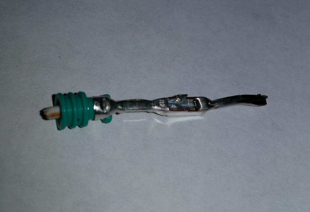

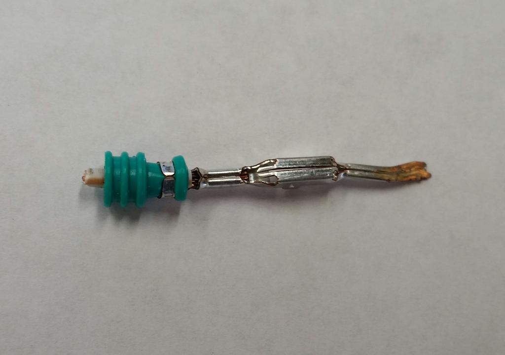

Got truck back from dealer yesterday. Problem turned out to be a bad terminal in I-255 inline connector... looked like it had been crushed during installation (see attached photos). TransEngineer on another forum pointed me in this direction and I relayed that info to dealer. Thankful for these Cummins forums and folks who are willing to share their knowledge! These trucks are complicated! Many thanks!! -Dave
