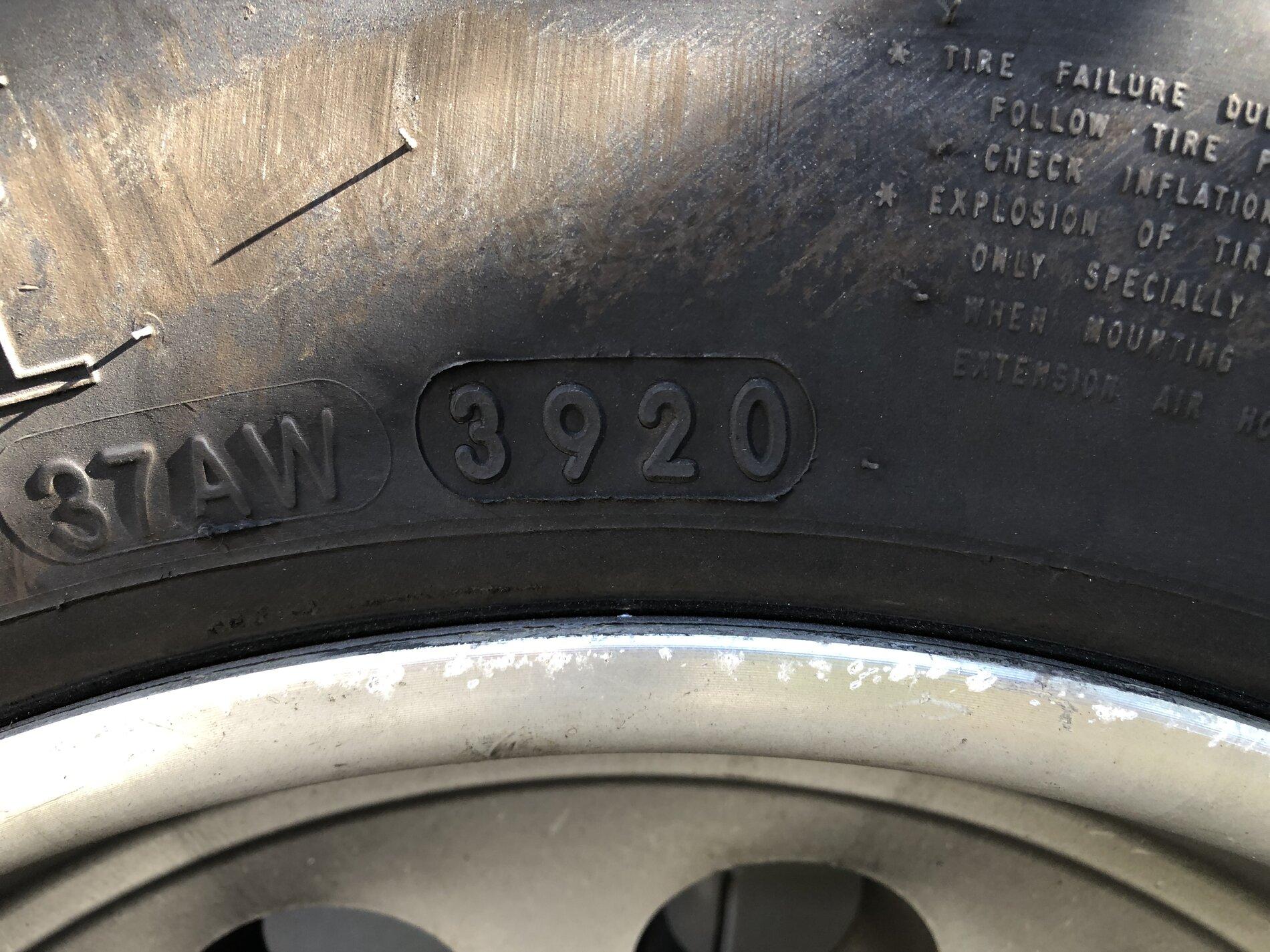

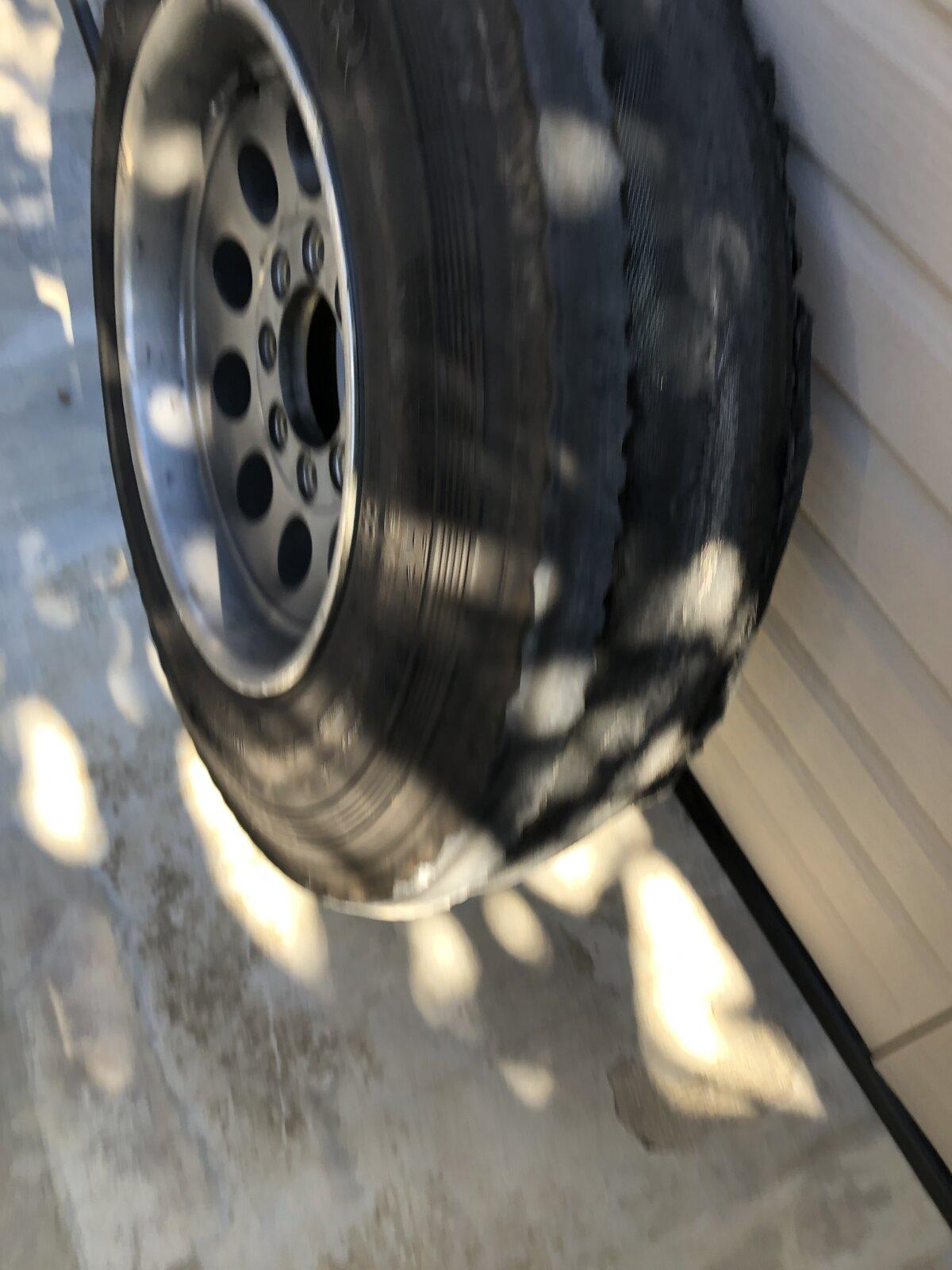

View attachment 131777 View attachment 131778
Same thing those Vietnam Sailuns are doing , throwing the tread . I'm considering next those new RV tires from Hankook, the H31's . Hankook has seemed to be a quality tire.
Those Goodyears shouldn't be coming apart , and neither should those Sailuns that's a pretty new tire you have . It's been a sketchy history with Goodyear ,and their RV tires . Marathons were a disaster at one time ,the G614's were also a disaster , these G114's seem to be following suit. There were a couple reports of the G114's that failed over on the Montana forum. One tire I haven't heard anything bad about is the Sailuns in 17.5 H rated .
I put a set on my 07.5 Mobile Suites and ran them for thousands of miles but since 2015 they seem to not hold up with my heavier weight. Friend has a heavy MS also he had issues with the GY's so he went with the "J" Continentals.
Well, you can't beat free that's for sure!!! But, if you join the DRV Owners Group FB page, we have a lot of 2 axle DRVs on Continental LR J HTL2s and so far, 0 failures. They are a robust tire that has stood up to everthing our group has thrown at it. They are not always easy to come by however.
Is the Speedindex of these tires high enough for your needs?
By far not every trailer/truck tire is built for 75+mph.
Most here would not tow that much weight with a pickup any where close to 75 MPH. Ron's motorcycle trailer tires are probably rated to only 65 MPH.
Maybe someone can explain this. The KMAX T is rated at 60mph. I read somewhere that rating is running with 6k on the tire and with less weight the speed rating increases??? I do tow mostly at 60 along the West Coast but when in a "FREEDOM" State such as AZ I tow 70-75 even with the MAXXIS.
Asked earlier what tire I would go with it would be the 235/75 17.5 as it is 31.5" diameter VS 30.5 G114 and 9.9" wide VS 8.8" on the G114.
