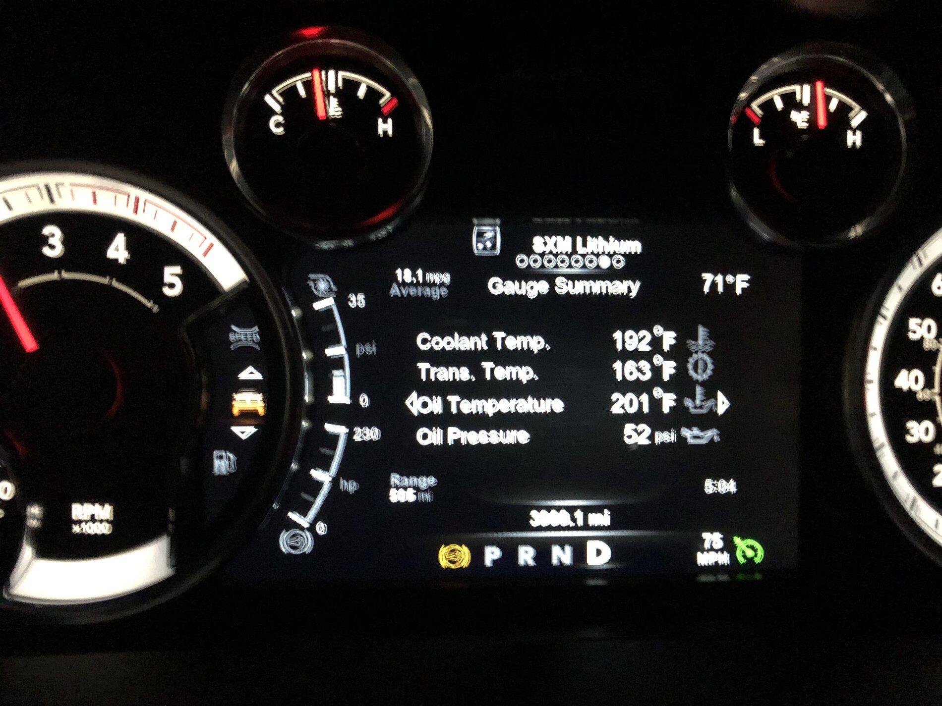

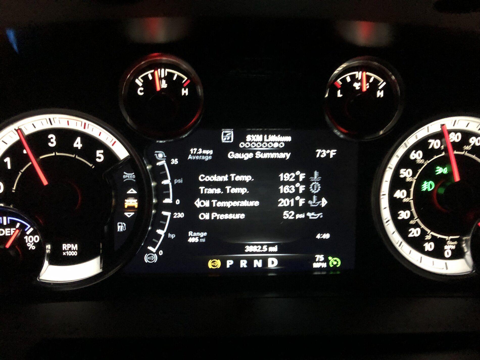

I actually took a picture of the MPG calculator on the truck because I couldn’t believe how well the truck was doing on fuel.
First picture was 45 minutes before the second to prove I had the cruise set at 69 at that point.
Next time I do a trip with the truck, I will do hand calcs as well.

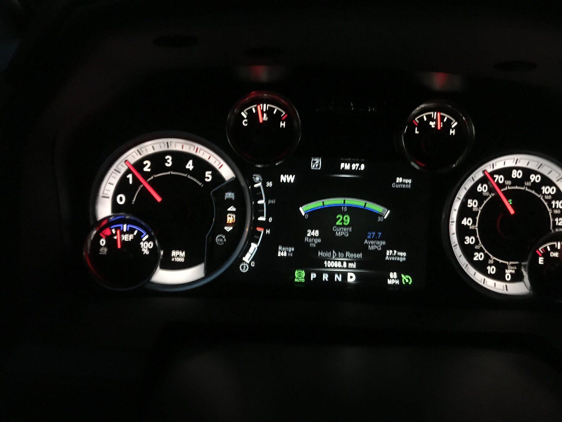

I took this one the other day. No traffic, no wind, and lost 150' in 18 miles. Not the longest sample, but was fun to watch.

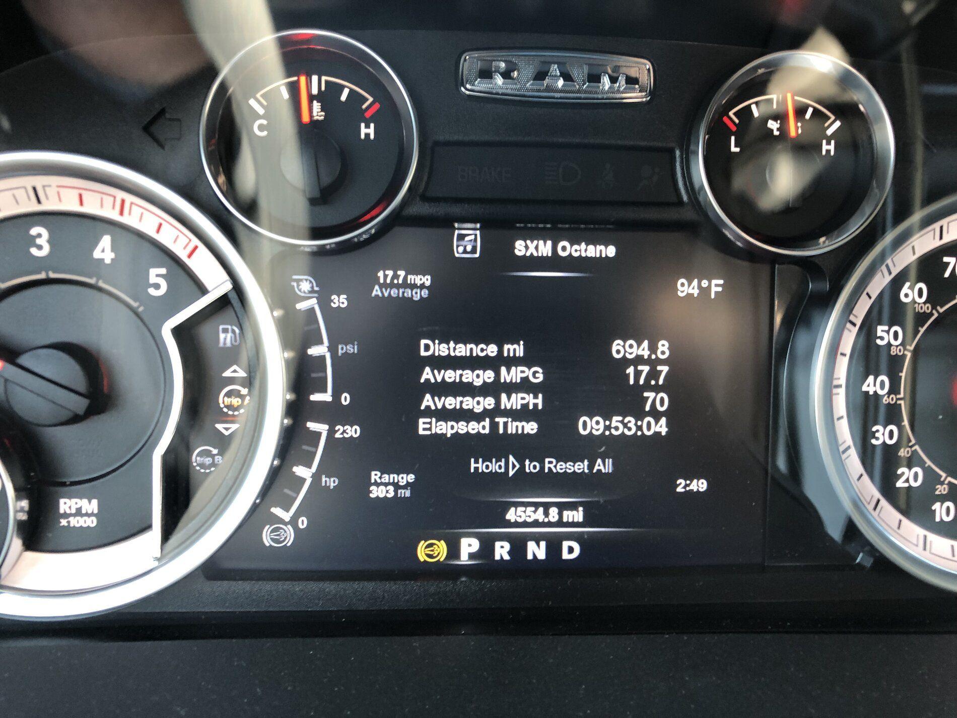

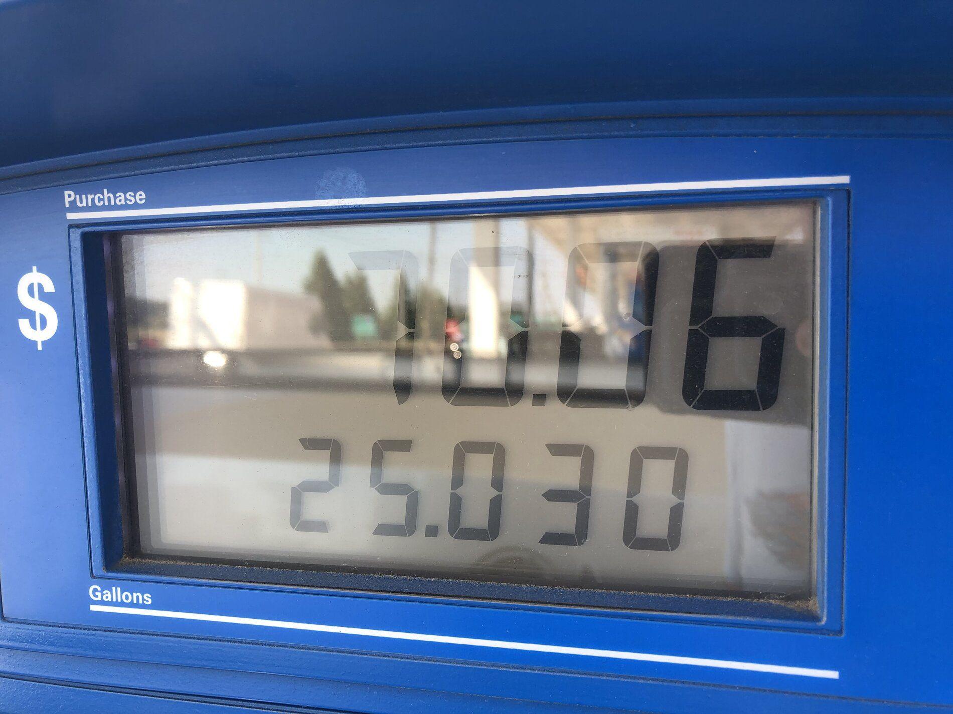

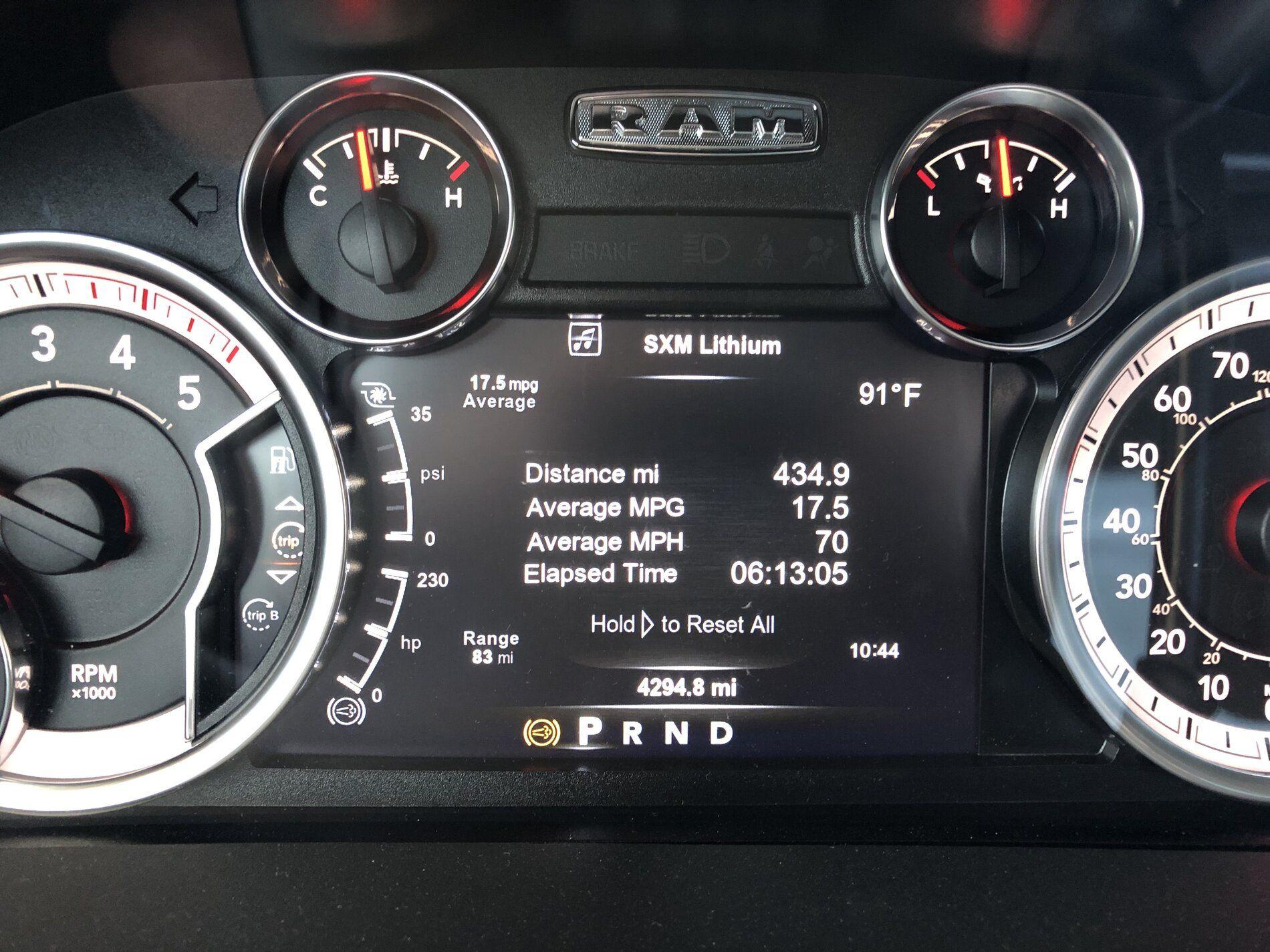

Just completed this science experiment yesterday. Drove from OKC to Nashville for a total of just over 700 miles almost nonstop. I ran empty, cruise set on 75 when possible. Ran into traffic in Little Rock and was delayed in several construction areas and one accident. Overall not too bad. Pay attention to the clock, elapsed time, odometer, and average speeds.
Later that day.... only one quick coffee induced pit stop at a interstate rest stop.
I did manage to get another 1/2 gallon in the tank after it clicked off in that pic. It wouldn’t let me put anymore in. Seemed like that pump was very sensitive.
Then at the end of the trip.... BTW, forgot to get a pic of the pump, there was a good sized line and I pulled forward to be courteous and failed to get a pic.
Your mileage may vary.....
I will say it doesn’t take much fuel to upset your calculations. Pair that up with the funky filler neck and the huge variety of diesel pumps out there, it’s very hard to get very accurate number consistently. Diesel foams up as it’s pumped, moreso the faster the rate and smaller diameter nozzle. I tried to keep things level, but there’s just too many variables that are out of anyone’s real control when calculating fuel mileage.

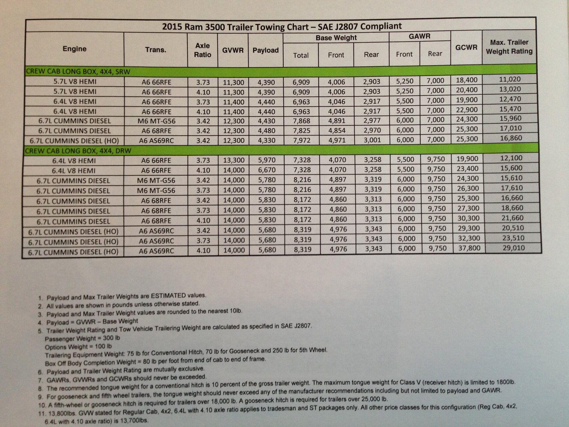

I owned a 2013 dually with 4.10 gears and the 68RFE transmission. I towed a 43' toy hauler which, when loaded with small car, water, etc., weighed in at 20,000 lbs.
The truck was rated to tow around 23,750 lbs.
I owned a number of trucks with manual transmissions, and avoided the automatics since they were usually not capable of supporting the greater loads and full output of our Cummins engines.
The 68rfe was my first auto transmission in a truck. I was pleased with the gear ratio spread, but was not happy with the flare when upshifting. I would floor it pulling back onto the highway, and I couldn’t get it to downshift if the engine speed was above 2200 rpm. That was because, when it went to upshift, the revs would climb to 3000 rpm in a flare, shift, then lock again.
That all stopped with the Aisin - shifts were quick and positive - but not brutal. After several hundred miles towing when new, the transmission learned my usual throttle demands and shifted smoothly from then on.
I checked the towing capabilities with the different axle ratios and went with the 4.10s since I got the greatest towing weights with it. 3.42s were only rated for around 16,750 lbs. while the 4.10s could tow 31,000 lbs.
Guys were worried about the ultimate revs on the highway - and I’m happy to say that the revs with the 4.10s and the Aisin were actually lower than my manual Gen 3, 2004 one ton and 3.73 axle ratio.
70 miles an hour in 6th gear saw rpms around 1750. Empty mileage hovered around 19 mpg (Canadian, hand calculated) and between 9.5-11.5 towing (depending on which way the wind was blowing).
There was some talk about the power of the exhaust brake - my 2016 is twice as good as my 2013. I could take my foot off to coast into the highway rest stops with the trailer, and the exhaust brake would slow the whole 30,000 lbs. from 70-25 miles per hour by the end of the ramp. I would only have to touch the brakes to negotiate the corner into the parking area. The exhaust brake worked down to about 19 MPH in Tow-haul with the Aisin smoothly downshifting and relocking in each gear to maximize the stopping power.
So, don’t hesitate, the extra money for the Aisin was well worth it.
