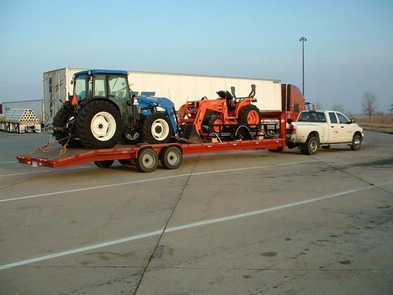

I like your low-pro trailer. Are the fenders outside the deck or inside or half and half? I can't tell by the pictures. How long is it?

The fenders are part of the deck. They are made of 9" C-channel so you can drive over them with what ever you want. I can't find a good pic of it but here is a pic of the next one I had. Same design but a tri axle. The tandem fenders were only 2" tall so a tracked machine has no problem. The fenders were a little taller on the tri axle because I couldn't use the 215 17. 5 tires. The tandem was a 32ft.

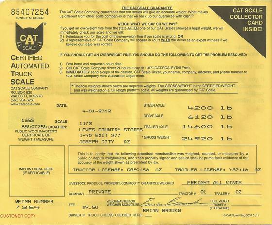

I hauled 6 ton of hay from Utah this weekend, 1100 miles, round trip. I am going to like the bigger brakes, they are very smooth/firm without being "jerky" and seem to be easier to adjust the controller. The tires stand up well with a good load.
On a 408 mile fuel milage test, loaded and empty, I was amazed and appalled at the same time. Empty, calm day and mostly 55/65 mph two lane highways I averaged 15. 8:) The return was extremely windy with 35/40 mph sustained and 52 mph gusts, I only averaged 7. 48:eek:

I would call that good loaded mpg. $9. 50 to use that scale, I always wondered what it cost.
