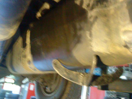

I have access to a lift through my friends at Melchert-Automobil, so the process was a bit easier. I drove the tank as low as I dared, and then inserted a clear plastic hose through the filler neck, syphon-style. Then I put the line into a container. Using a rag to seal the filler neck, I put 10 PSI into the tank to force the fuel out. After around 30 litres, I started getting air. One thing: a while before I had noticed that there was a stain on the inside middle of the tank, diesel was coming out somewhere.
Weeelll, after 'pumping' out the tank, there was a 'small' puddle on the floor. Why? It seems that the cap on one of the vents (probably for when the tank is used for gasoline) was split. Source of leak found. As you can see by the accumulated crud, it was leaking for a while.

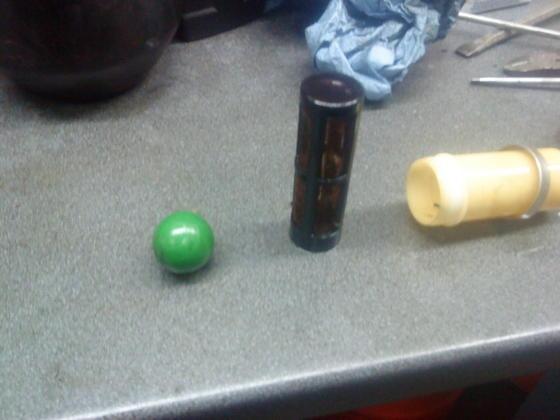

The inside of the tank looked extremely clean. The green ball I found amused me though. I thought it was a 'toy surprise' some kid put in the filler neck. It later turned out to be the 'roll-over ball. ' Oh well.

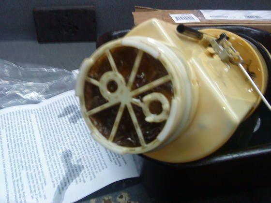

Here is a picture of the screen... not too sporty looking, but I really doubt it was blocked enough to cause significant restriction. There are other posts, where the screen looks much worse...

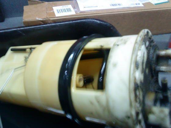

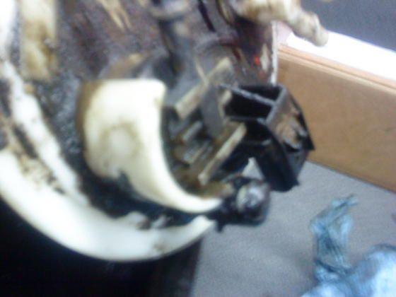

Since the tank was down, I thought it would be a good idea to replace the fuel sender. Amazingly, I managed to source it here (in Germany). That was the easy part. Getting the basket apart was another issue however. I tried to take pictures, but they turned out too smeary to use... I used three small screwdrivers to depress the plastic enough so I could rotate the basket far enough to pull it apart. Sounds simple, but it took about 15 minutes until I had it in two pieces.

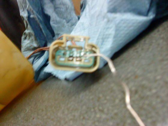

The new sender has the wires, with the new connectors. So the next challenge was to get the old connectors out of the plastic connector... I used a paper-clip to depress the hooks on the old connectors. There should be a picture here somewhere...
