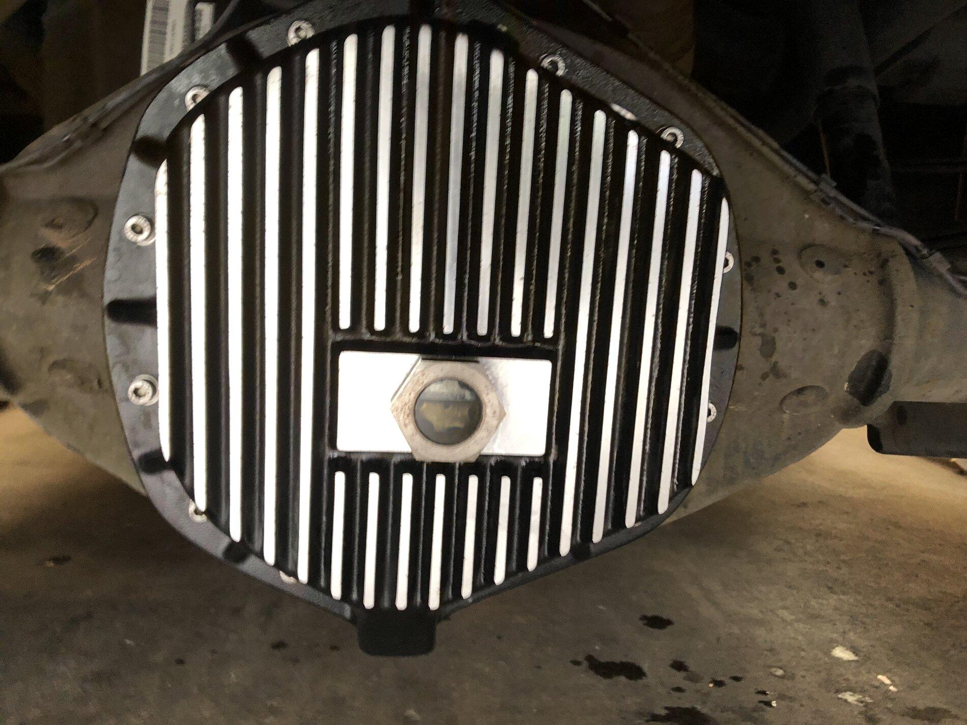

Ron, I know we have different trucks and everyone is discussing how to fill up the differentials by checking the fill hole. This is one reason I like the Mag-Hytec diff covers, you use a dipstick to check the fluid level in the diffs. The dipstick is also magnetize to catch metal debris that you can wipe clean. The drain port is on the bottom and the fill port is on the top with the dipstick.
I think Geno's was selling a rear Mag-Hytec cover with a slight gage for a while. I don't know how will the sales were on the cover but it seem like a good idea!

Ive got the AFE raw diff cover on my truck with sight glass and dipstick and couldn't be happier. I'd love to get into the new banks cover with all the research that he did on it but i gotta get someone to buy my AFE first lol..
After owning MagHytec and now the OE aluminum cover I think I will stick with the OE. I have one more MagHytec on the shelf like pictured above.
