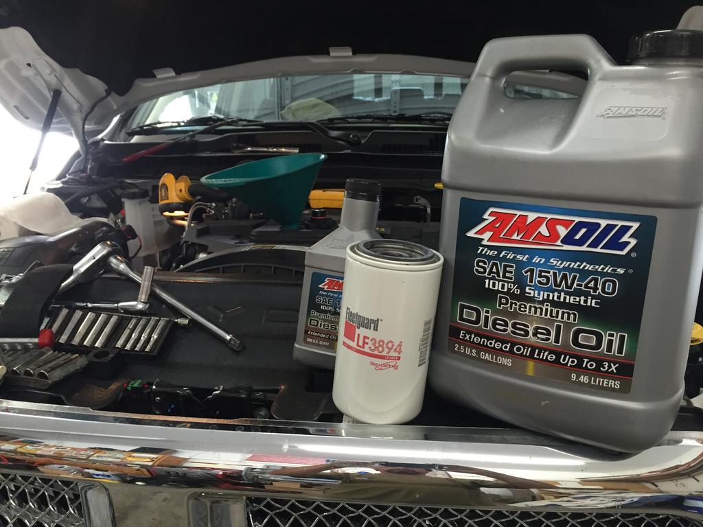

My opinion until your warranty is gone I would not exceed 15K on changes. So that alone would make me wonder if the Bi-Pass is worth doing?
I have excellent reports using the FleetGuard filters and AMZ/OIL Full Synthetic 15-40 sticking to the 15K changes.

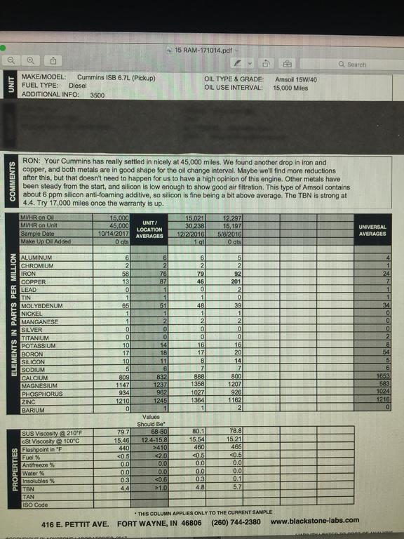

So will a bypass system stop the oil from turning so black so fast?
I don't think so. But I don't worry about the color if my oil. Most soot is sub micron which won't be filtered with any filter. But I think getting the soot particles out that are 5 microns or greater can be beneficial to your engine. The amsoil bypass does a pretty good job down to 2 microns.
