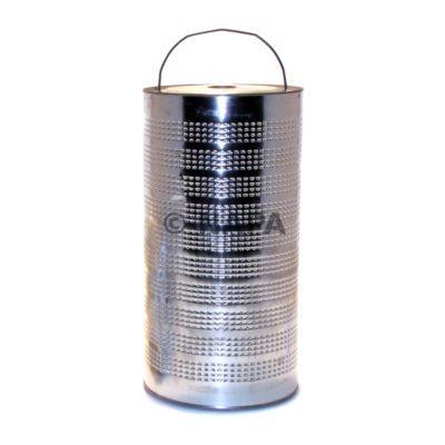

I agree. All the big trucks, back in the day used them. It was not referred to as the bypass, just the 750 Luberfiner. Ag or construction didn't use them.

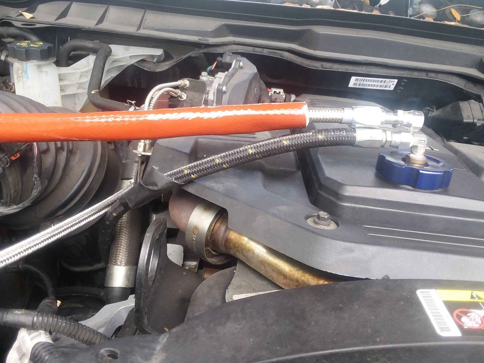

I noticed a slight bit of fray on the hoses/lines of my amsoil bypass filter. I guess the 6 cyl cummins does a little more vibrating in it's mounts than the old 6 cyl 3.2 liter Isuzu Amigo gasser that I had the same Amsoil bypass installed on.
Went 80k in the old Isuzu before I traded it in with the bypass filter still on it.
Thinking of upgrading the hoses to steel braided. And accidentally bought the hose a little smaller than than the original hose that came with the bypass filter. Instead of the original 13/32" ID hose, I accidentally bought the .25" ID hose and .25" ID hose connector ends. I bought the hose on eBay and the connector ends were from amsoil (their smallest offering size).
Question: anyone see an issue with using a slightly smaller ID hose on this system. I'm using the BP90 filter.

I am replacing the hoses that came with my amsoil bypass filter kit. Replacing them with stainless steel braided and threading them through a (red) insulation tube. I Noticed a bit of chafing on the nylon-braided rubber hose that came with "Amsoil" stamped on the hose and has been on the truck for 3 years.
Just need to go out and get some blue loctite and will finish install this weekend. Had these hoses on an Isuzu Amigo for 80,000 miles with no problem. But the ole Cummins does a lot more shaking in it's mounts..... So it's time for a hose upgrade. For those interested in using the kit's amsoil hose ends, just get the AN5 hose from summit racing
