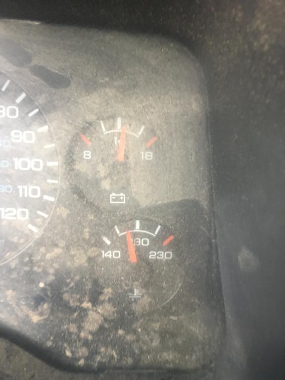

I don't know why I keep getting cursed with these wretched things but the truck I just bought the heat doesn't work in it either what should I check to try and get it working ? Engine comes up to operating temperature but still no heat from the vents
