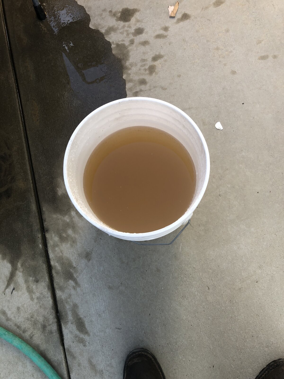

flushed out the cooling system with the Mopar cleaning solution. dumped the coolant, refilled with fresh water then dumped again. refilled with distilled and added coolant system cleaner. ran it up to operating temp so the tstat would open and circulated. What came out on the first dump was absolutely black. Did SEVEN refills with distilled and each time got it up to operating temp (195*) so tstat would open, then dumped by pulling the bottom radiator hose. A concerning amount of contaminates like sand and other granular solids came out in the first few dumps. no oil sheen on surface of coolant in any of the dumps. the pic is the seventh dump, it looks slightly darker than it actually is. It is relatively clear, just orange colored. Just a slight bit of oxidation from just having water in the engine block? Or is there an issue that needs to be looked at? Comments appreciated ! THANKS!
