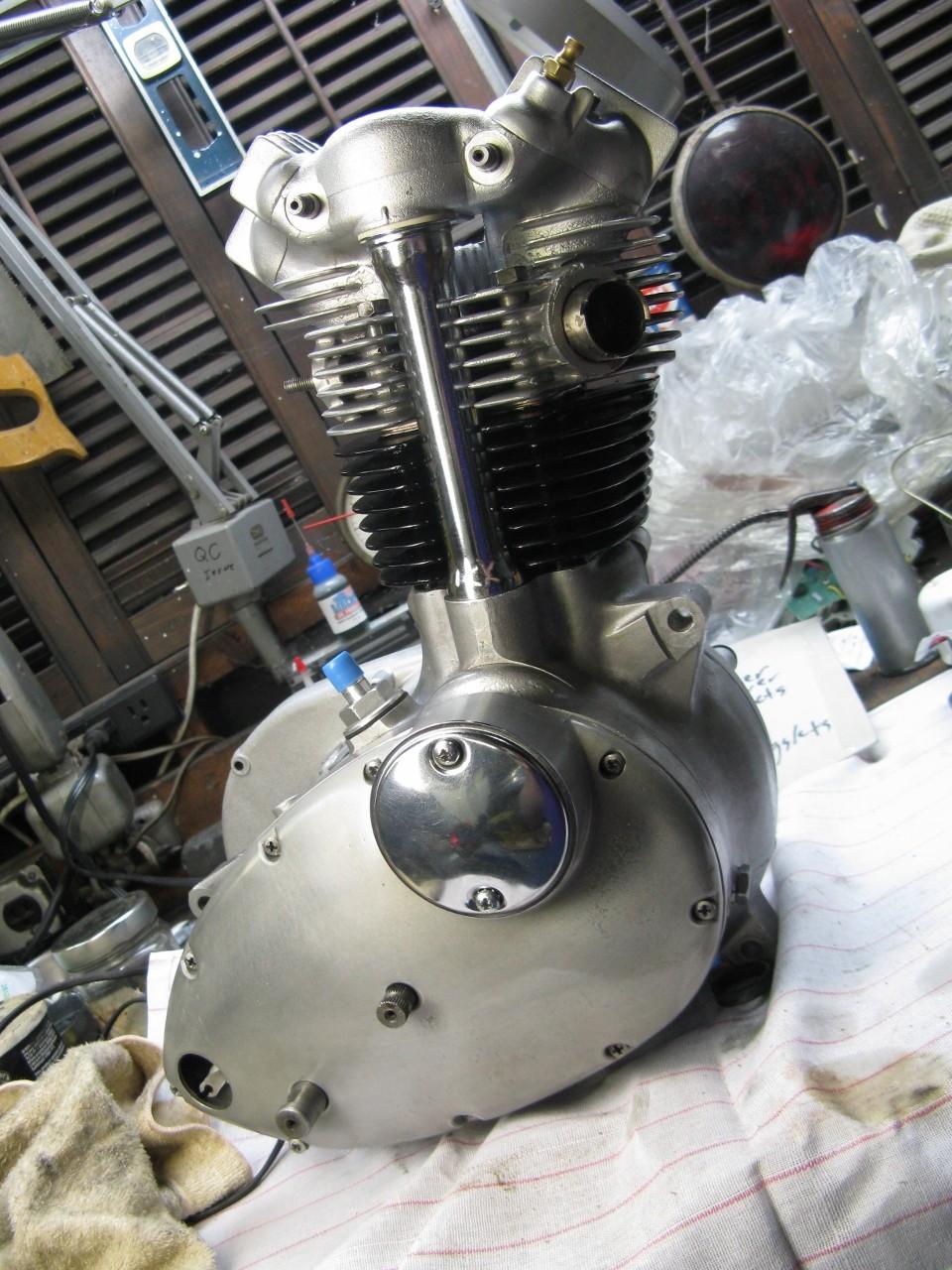

This is what I have been working on for the last few months, My 1967 Triumph Tiger Cub engine. It has several proven modifications, Forged 65.5 mm WISECO piston, "R" camshaft and a roller bearing Big end on the rod, port matched and polished. Tri Spark point less electronic ignition.
