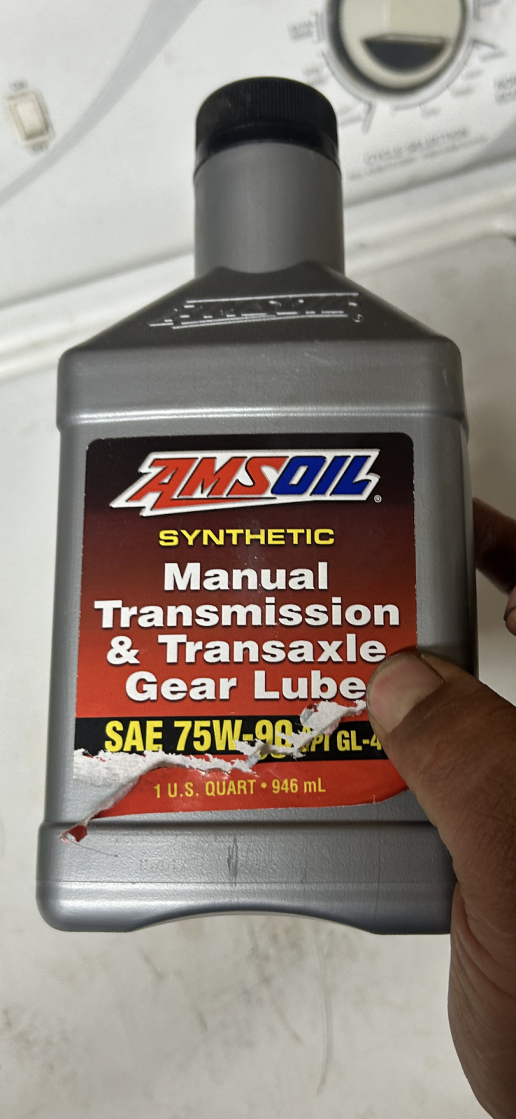

Back the original question this is the oil I run now in my nv45 . I like the way it shifts better than the oem Chrysler oil ever did
