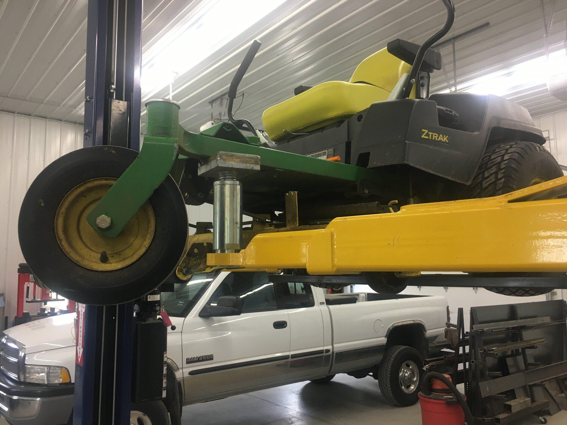

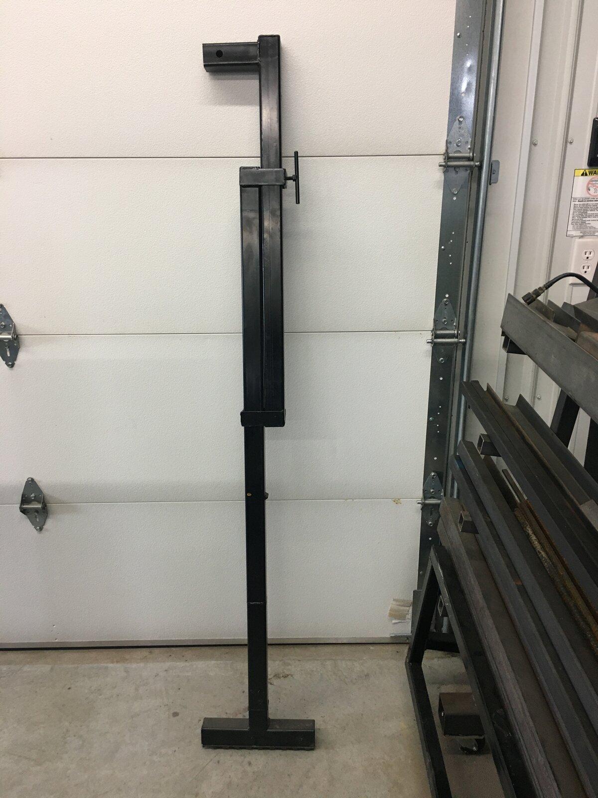

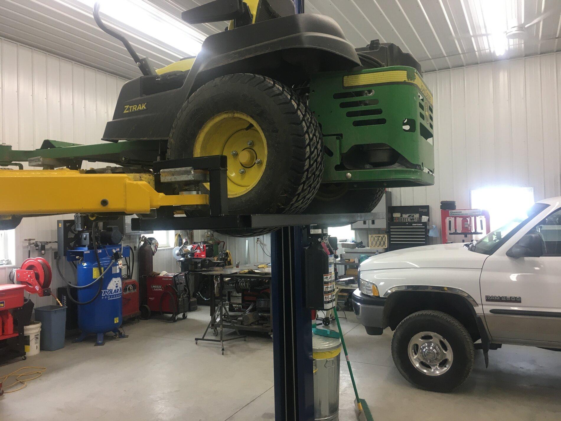

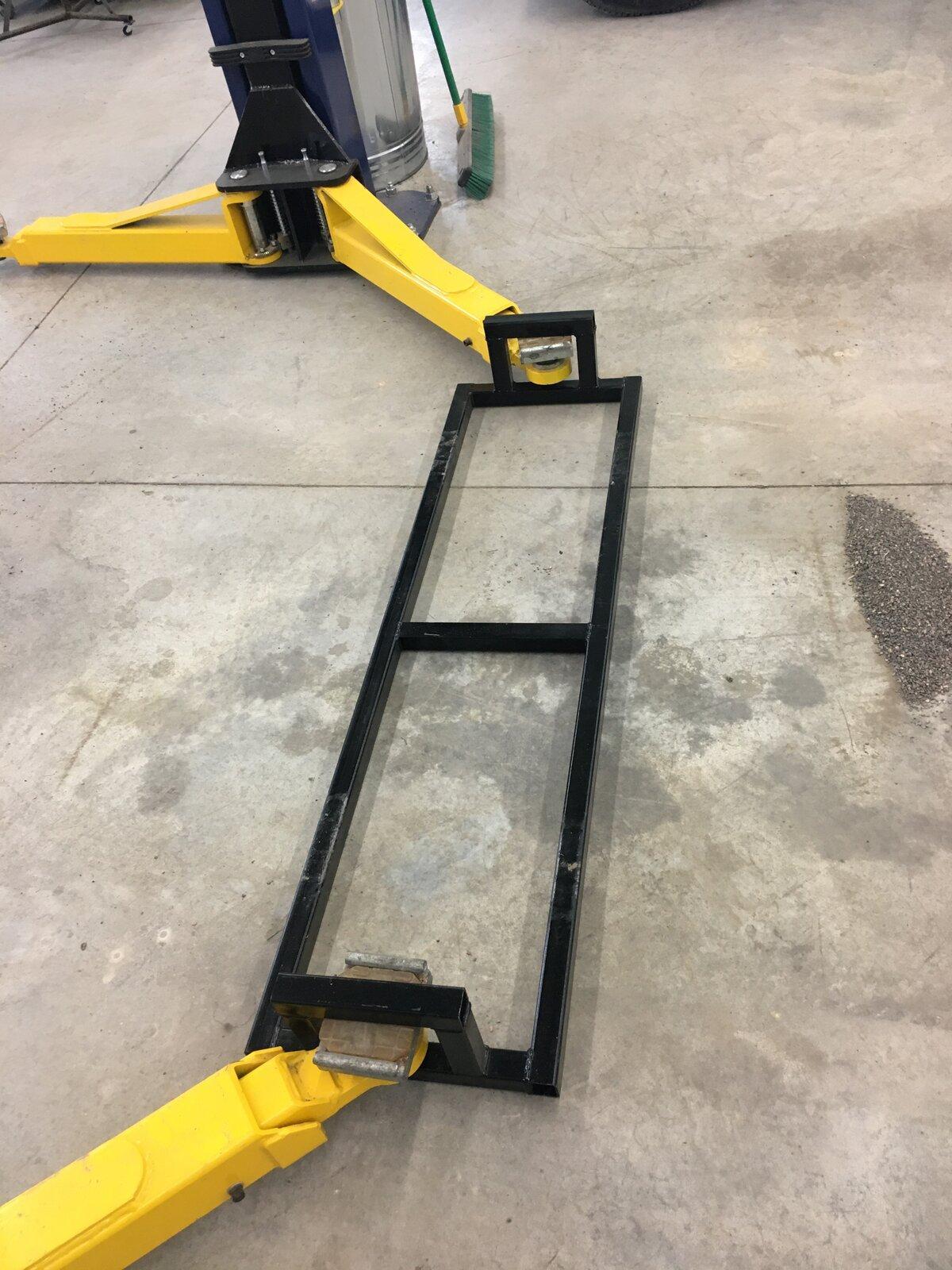

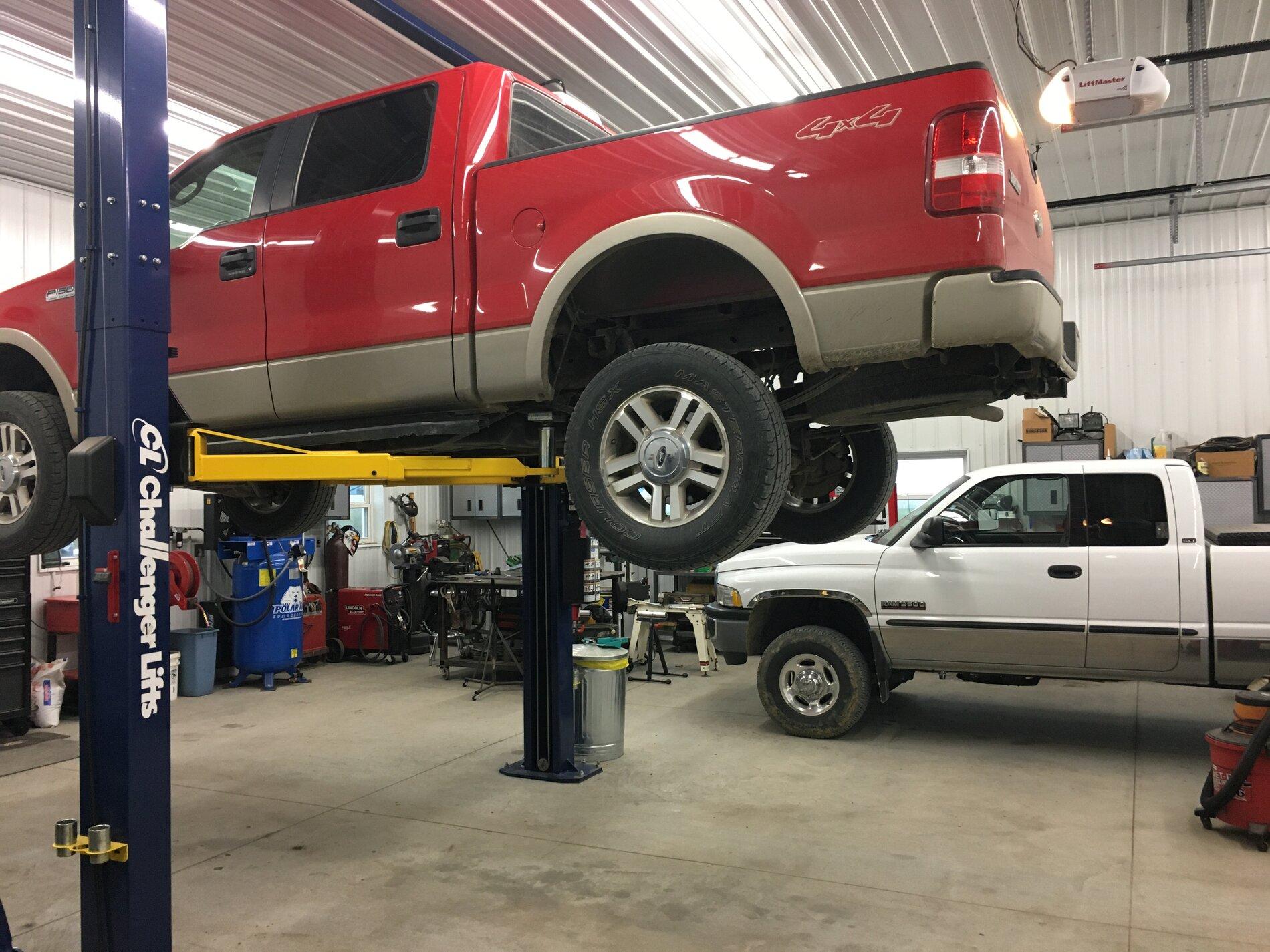

When we built our shop at the farm a few years ago, I knew having a lift was at the top of my bucket list. Since I’m getting a little age on my old carcass, my wife thought it was a good idea. I was tired of crawling around to change blades on the Z-turn, so built this cradle to hold the back tires. If a lift is in your future, you will enjoy it!
12,000 pound Challenger brand. Local Chevy dealer has three just like it that they’ve used for several years with no problems. USA made. I looked at quite a few different brands before deciding on it. And when I say it rocks with my pickup, that’s an overstatement. Very minor movement, but I like it really solid. The columns don’t show any movement. https://www.challengerlifts.com/products/e12/

I am impressed! Thanks for sharing. I’m scouting my next home that will have a building like this. I’ve looked at a couple of properties that have something already, but nobody seems to have a high enough side. In your estimation, to get your truck max height in the lift, what would be the minimum wall height you could get by with?
I went with 14’ walls because the JD tractor is about 11’ tall and needed the 12’ high door. The Oliver will just clear on the 10’ doors. I’ll measure the next time I have my pickup on it, but 12’ might be enough. I have 10’ walls in my garage and that’s not high enough. I had a concern about all the heat going to the top and so have two ceiling fans. I’m really glad I have those.

Wayne,
I haven’t needed to put the Dodge on the lift, but needed to rotate the tires on my wife’s F150 today. On the ground, both Dodge and Ferd measured roughly 6’ 5” to the top of the cab. With the lift fully up, it measured 11’7” from the ground to the top of the cab. There is 6’ under the lift arms. There was 2’ from the top of the cab to the safety bar. I talked to the guy who built my shop and he said he had modified an existing building with 12’ sidewalls to accommodate a 14’ lift. The door came in an end wall and they boxed a place between roof trusses to accommodate the lift. He said on a new building, he would recommend scissor trusses to get the needed height. I had to have a 12’ high door to accommodate my JD 4440, so needed 14’ sidewalls. Hopefully, this helps answer your questions.

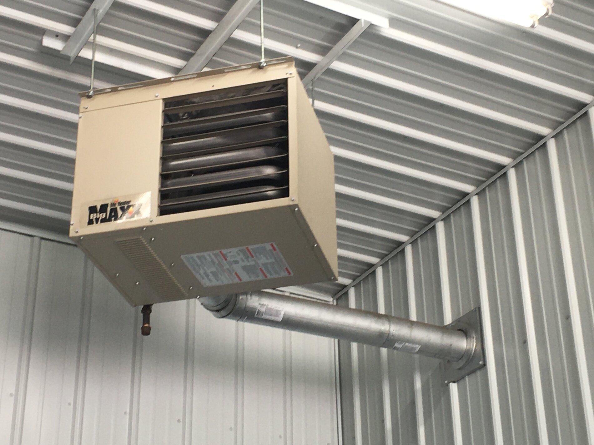

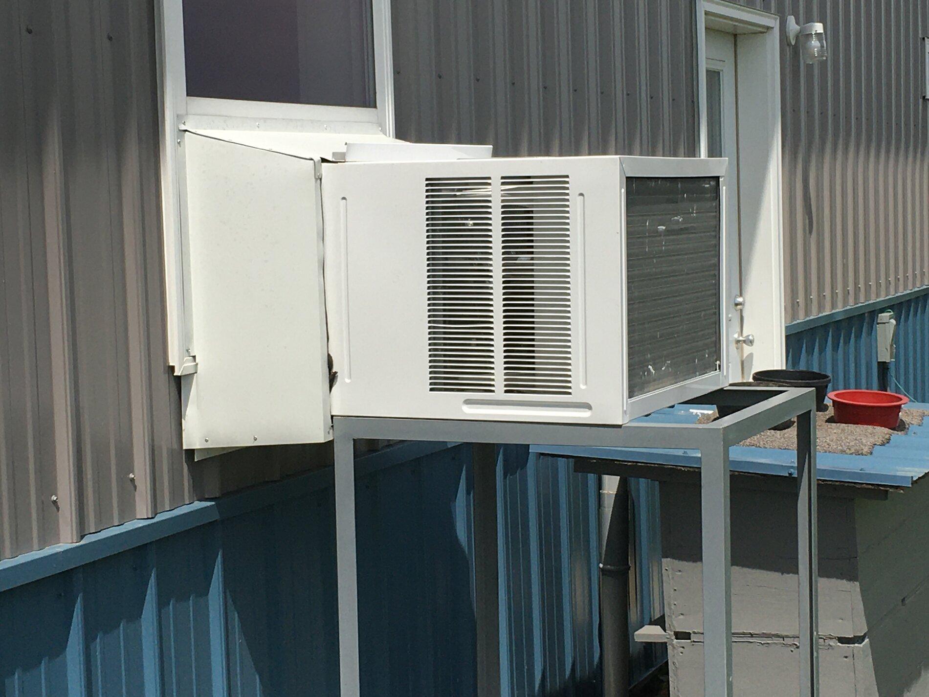

Furnace is 80,000 BTU, fired on propane. I’ll have to look at the AC. It was an afterthought and is a window unit. The windows are not tall enough, so I fabbed a stand and ducted it in. After all finished, I like it better. To winterize, unplug it and shut the window. I used bigger windows in my garage and have a window mount there, as well. The best thing is to not park hot vehicles inside, but wait until they cool down.
