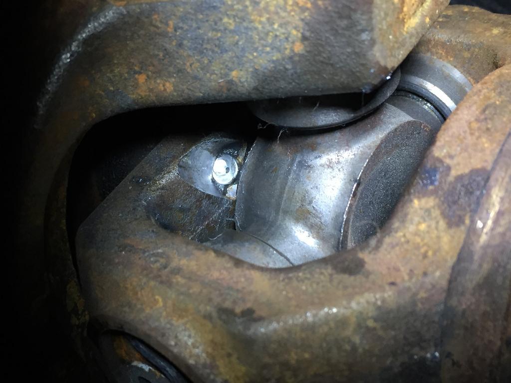

So now at my first oil change. I found the decal and the awesome pics and video others have posted to help find and lube the front drive shaft. The grease cup in this picture is what I expected to see. Mine looks as though the hole (no spring/bearing is on the edge of the bottom of the grease cup. Of course as you can imagine, when i stick my lumax grease needle adapter it seats perfectly fine in the cup but when I pump grease it totally misses the hole. Am I missing something here? take a look at the pic below.
Must be the angle of the needle. With a needle fitting, you have to be almost perfectly centered in the fitting....with some moderate pressure on the needle as well. It takes me several tries before I get it aligned correctly.

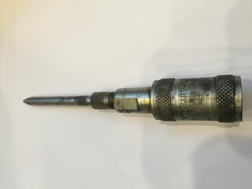

Needle or needle point. I made this one years ago and it works fine. SNOKING

I just gave up and removed my driveline! I rarely use 4wd so if I do the same every 25-30K it will be fine. I'm betting a lot of people "THINK" they are getting grease into the joint but in reality they are just coating the outside.
I did have to grind down my tip to get it to work even with the driveline removed.

While i had trouble getting the needle at the correct angle, it was obvious that when I had it correctly positioned there was NO excess grease flowing on the needle side when pumping the gun.
I recently purchased this locking tip for the grease gun and have used it twice. It is an amazing upgrade to the lincoln gun. One side benefit for this job is that the "trigger" can be used to get leverage on the tip to ensure it is at the correct angle for the grease port on the ujoint.
