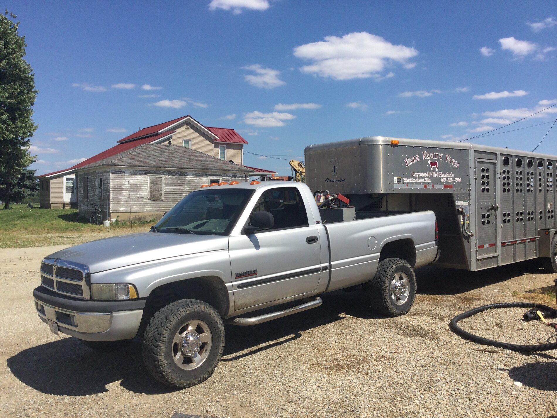

In my post the other day I mentioned rebuilding my 47re. I have been thinking more about about swapping to a 5 or six speed to eliminate the electrical gremlins that seem to haunt these transmissions. Since I’m just exploring options at this time, I am looking for links to threads, and any recommendation or experience. I’d love to hear some pros and cons. My truck is a 2001 2500 regular cab Laramie, 3.54 gears. It is used primarily for farm work, but is practically rust free and I figure on keeping it. 150,000 original miles. A third gen 6 speed swap is appealing to me, but I am totally open at this point. Like I said said in the previous thread I’d like to wake up the engine a little but nothing extreme. Thank you all in advance.
