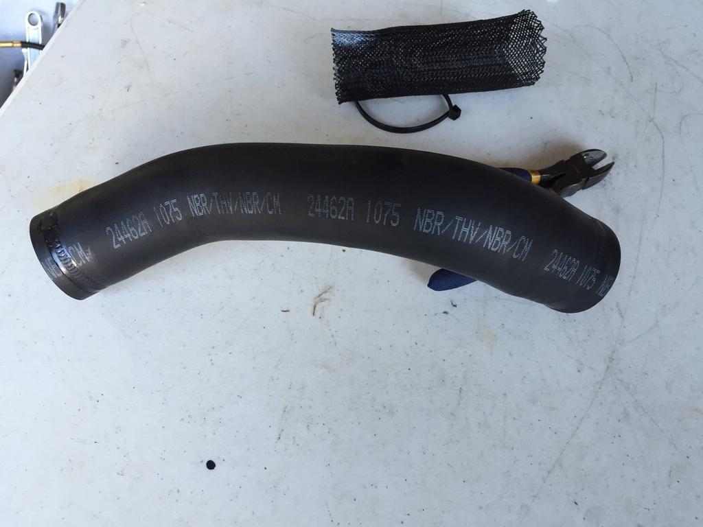

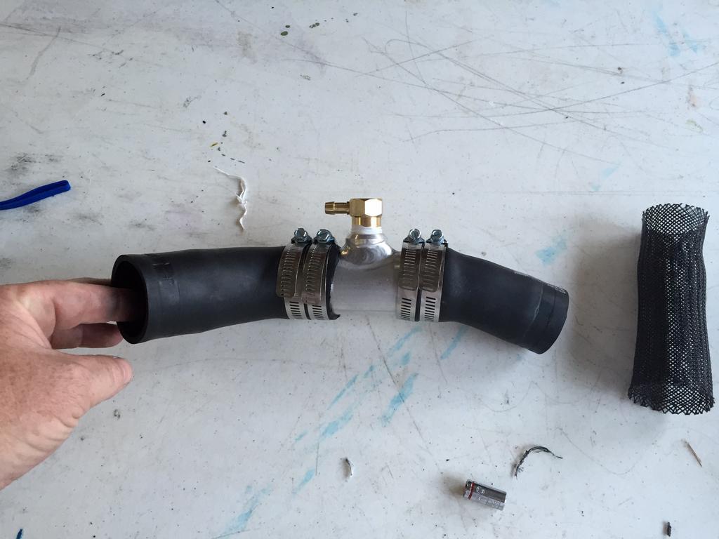

There’s a hose between the pipe and the tank. I cut that in half, removed a few inches and put the rollover valve/tee in. Worked fine for the last two years.
All I have to do is replace the hose and it’ll be completely stock again. I’m going to pick up the hose tomorrow because I need to sell my truck. I’m going to sell the modified one once I get it off.

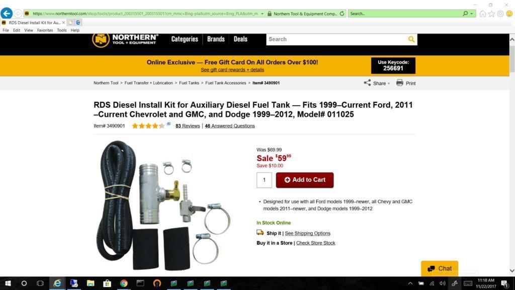

#11025 is the Dodge kit. You can get those from Northern Hydraulics as well...
http://www.rdsaluminum.com/rds-parts.html
Northern Hydraulics Link to kit..
Problems with the site...here is a screenshot...
