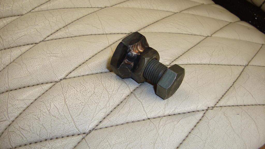

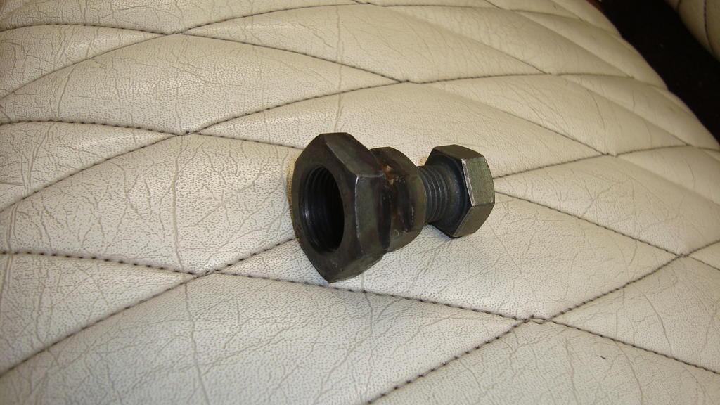

For what you pay a shop you could buy the tools and set it yourself. Every engine is a little different and every truck is driven differently also. In other words, the setting on my engine, with my driving style probably won't work on yours. I experimented with several settings before I settled on the timing I have now. I also fabbed up a tool based on a picture posted by Joe Donnelly to turn my pump shaft which makes timing a lot easier and faster.
